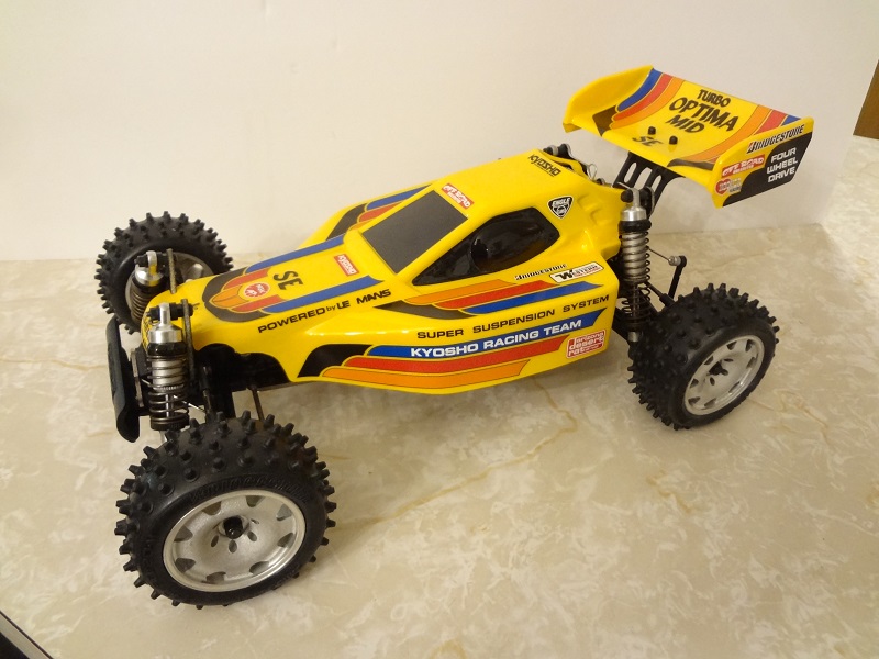

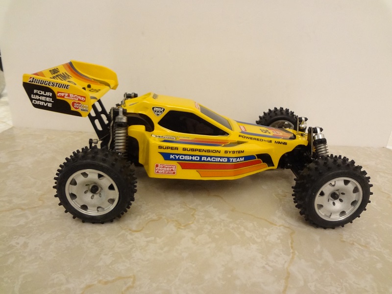

Finally got around to trimming and painting the new body. For paint, I used Duratrax bright yellow and also their window tint for the windows. I'm pretty pleased with the outcome. Hope you guys like the pics of the finished product!

It´s a job well done - thumbs up.
BUT being the perfectionist I am
, You ain´t getting a full 10 before You´ve installed the clips for the wing
Gone fishing

The final result is very, very nice... there aren't that many Mids on the forums, let alone "special" mids like the turbo or the SE!
Love the yellow paint with the window tint! Shelf queen material

Looks very good. You appear to have nailed the color. There's a couple like it posted on ebay right now. Yellow is an appropriate color for this car; you have a goldmine there. Good job. Set it on the shelf to admire or sell it and retire early.

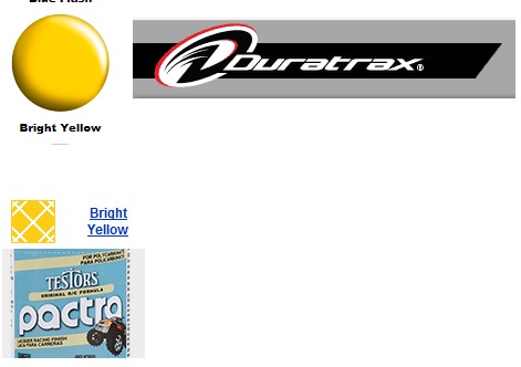

Hey Basher, by chance did you back-up the Duratrax Bright Yellow with white to make appear as bright as it does in the photos above? I have Pactra Bright Yellow applied to my XLS runner and it looks very dark (like mustard). So, when I compare the "Bright Yellow" color chips from each manufacturers web pages, both appear to be the same (see below). Your Mid in the photos above appears much brighter than my XLS. I backed up my yellow with gray primer but even before I applied the primer, it just looked too dark. It's good enough for a runner but before I paint the shelfer, I'll want a lighter shade of yellow. If you don't mind my asking, what did you find when you were experimenting with different brands/colors for your Mid? Thanks.

I did back it with white, But the wing was not backed up with white because it would show. I could not tell the difference. The only reason I backed it with white was to ensure that the dark window tint paint wouldn't bleed through the yellow or darken it in spots. Different paint colors, even among the same brand and type , cover differently than others. For instance, with Duratrax paints, bright white and bright yellow cover very well and are completely opaque, especially after two or three good coats, but other colors, like their metallic blue is translucent no matter how many coats you apply. Most of the neon colors from any brand do better with a white backing coat. I had planned on trying some different brands of "bright yellow" such as Spaz Stix, but the Duratrax bright yellow was exactly what I was looking for so I didn't get a chance to try the others. When I paint a body, I hold it up to the light as I'm painting. This tells me where there are lighter and darker areas and also tells me how much that paint is going to need a backing color.

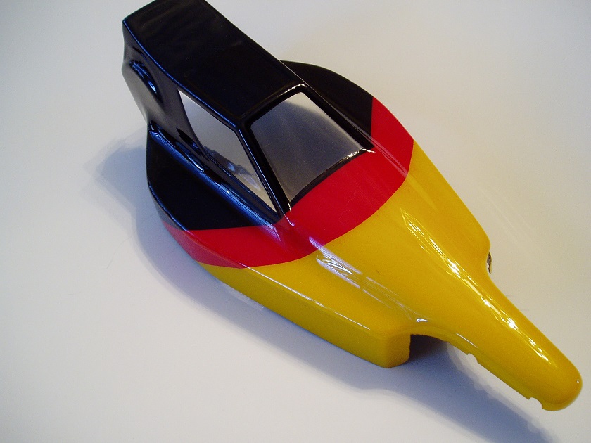

BTW Here's my XLS body. It appears a bit lighter in the photo than in person.
So yeah, I was gonna ask your opinion on what to do with the very tight areas like wing stabilizers. I have a Paasche air brush from bitd and have used it in the past to paint wings but I've found that it's still difficult to squirt paint into tight areas. I've also tried applying the paint by brush but with mixed results - especially if it's a light color. Your Mid wing turned out excellent so perhaps I should try and work with the air brush some more. Have you ever tried thinning Duratrax or any other poly paint with ordinary lacquer thinner?
