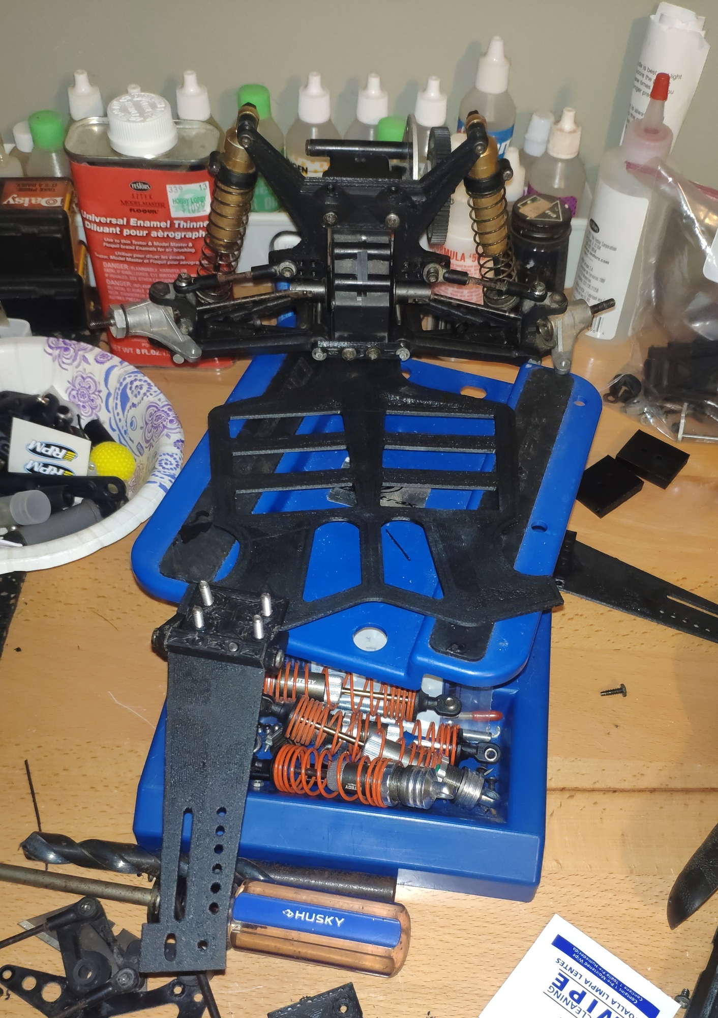

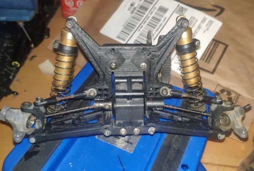

Post by Dr1rrrr »

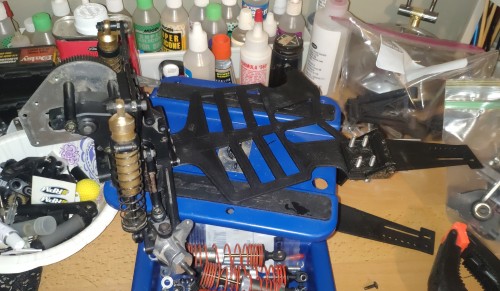

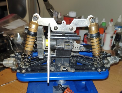

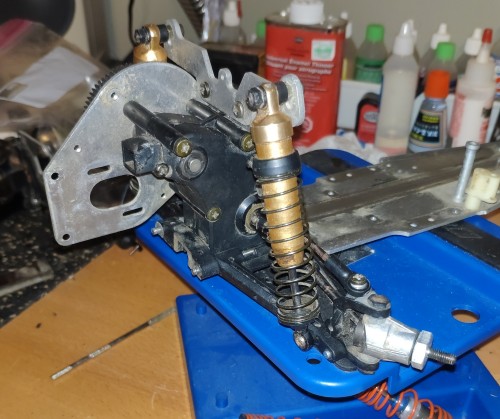

Last night I had some time to mock up some of the stock parts in the form of fwd to make sure all the front suspension can be transferred to the back. It transferred flawlessly I am working on making some 3d printed prototype parts like the shock tower today.

Post by Dr1rrrr »
I got a shock tower printed I am happy with the design, but I need to lower my printer heat. If any of you guys know a good place to get things made in carbon fiber I will be looking soon. I already know a guy for aluminum but his machine can't do carbon fiber.

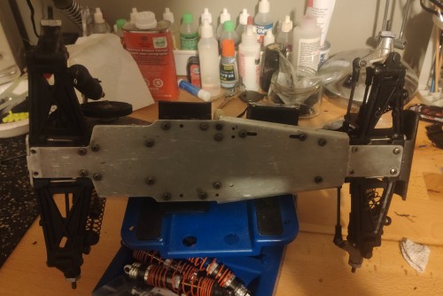

Dr1rrrr
Posts: 52
Joined: Sun Feb 07, 2016 7:23 pm
Location: Florida
Been thanked: 21 times
Re: It's finally happening optima mid FF conversion

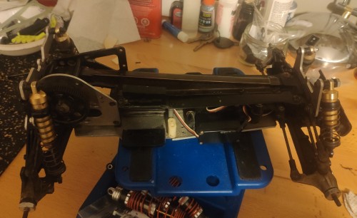

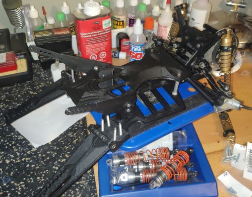

Post by Dr1rrrr »

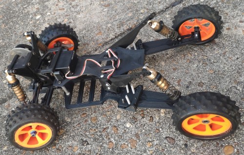

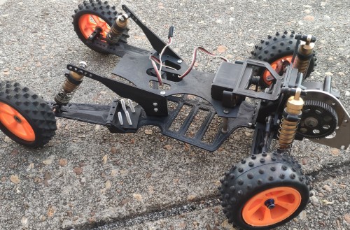

Got some more work done, I have a design for the chassis and the rear arms with all of their brackets. The arms them self still need some tweeking but they are close. I also have a design for the top plate as seen it this picture I found.

Almost got a rolling chassis done! Once I get the roller done I can start making final parts.

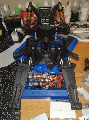

Dr1rrrr
Posts: 52
Location: Florida

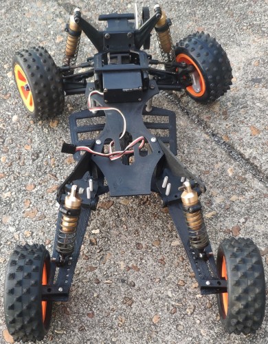

Post by Dr1rrrr »

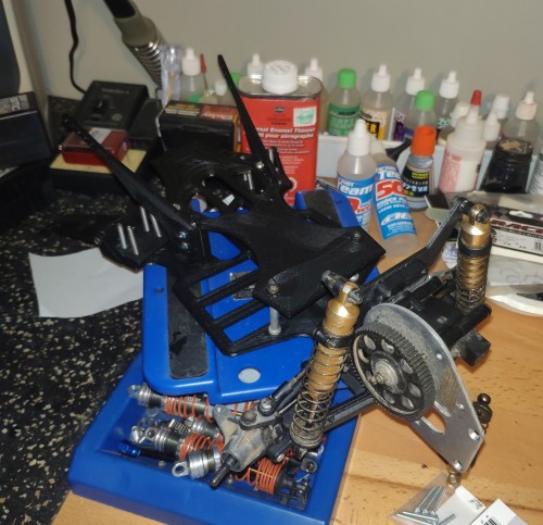

Got the roller done I'm pretty happy with it so far. I just have some losi wheels on there for right now. I've seen this car with yokomo wheels on it and I've seen it with normal wheels let me know which you guys think I should go with. I've got a day lined up to make the chassis in aluminum so it should be ready soon.
