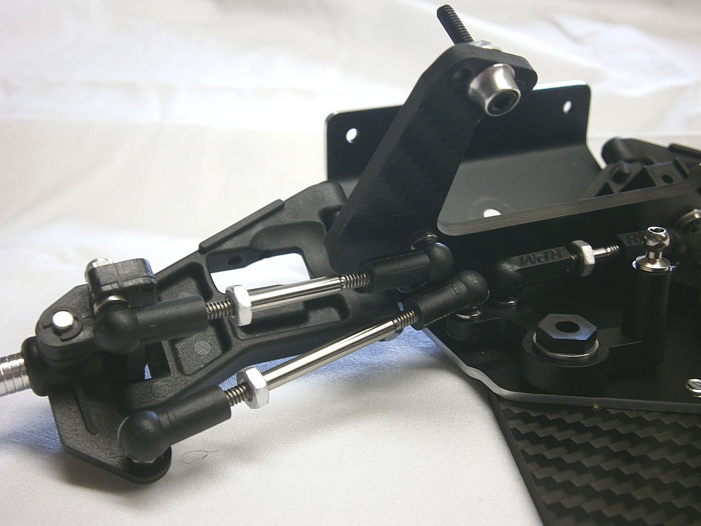

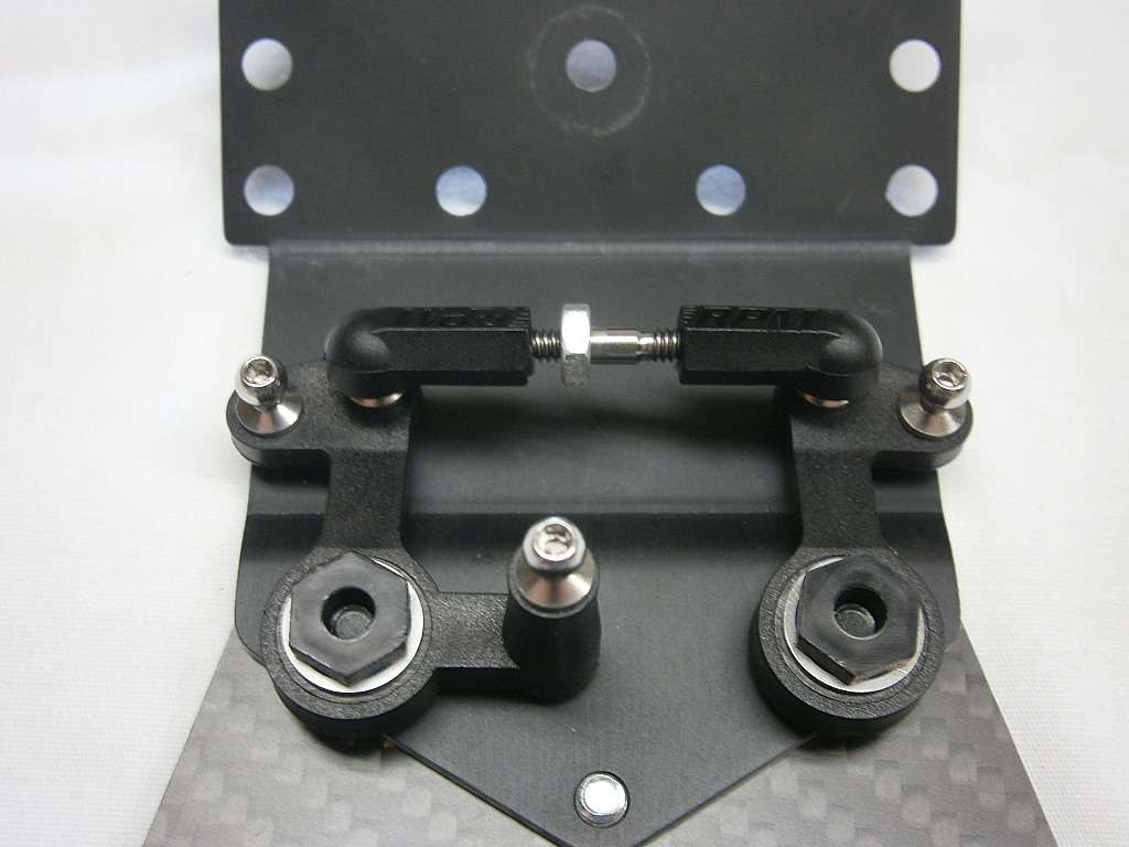

Getting the front end started today, bell cranks first. Cutting 3mm off the ends of the RPM ball cups worked out perfect for me.

Re: Factory Works C2 Carbon Fiber
There will most likely be clearance issues between the inner camber and inner steering ends. RC10’s have never been RPM friendly in those spots.
Getting ready to find out
@GoMachV
Yep, RPM ball cups are not RC10 friendly
I cut off 4mm from the ends of some Lunsford 7991 4-40 ball cups and they work with no clearance problems. I only had 4 of them so did one side. Ordered some more and they should arrive about the same time as the steering servo (Savox 1251MG-BE). So, now that I'm held up on the front end, might as well move on to the shocks!

I guess that by locating the inner steering link and camber links close to the inner hinge pin this is key to controlling bump steer. I wonder if the bellcranks were a few mm shorter or if the bellcrank pivots were moved a few mm's rearward so that the inner steering link no longer collides with the camber link would this actually increase bump steer? Of the various options available for these vintage cars (there are a lot), are all bellcranks the same length?NomadRacer wrote: ↑Sun Apr 15, 2018 11:31 am @GoMachV
Yep, RPM ball cups are not RC10 friendly![]()

We sell a rack bar for our ball bearing steering kits that has an extra set of holes for RPM Ball ends. I’m sure it changes the Ackerman in a negative way but the steering geometry seems fine.

I'd think if you used Factory Works/A&L steering there would be no clearance problems with the camber-steering rod ends, maybe. I wanted to use the Lunsford retro turnbuckles, hence the Worlds re-re bell cranks use. They are the same length. You could ask GoMachV about the placement of the inner camber ball stud location. I'm using his Factory Works carbon fiber shock tower.

You've chosen the obvious solution; if RPM rod ends create interference, then use a different rod end. Hence, you're using Lunsford. It's simple! Problem solved.

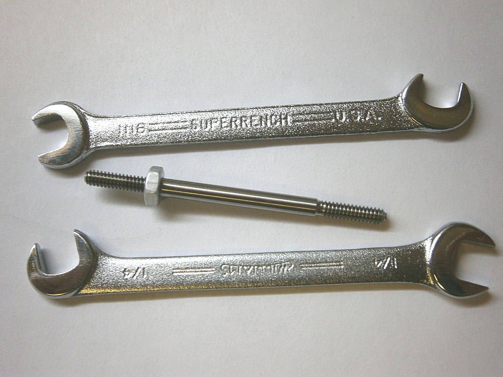

Since the Lunsford Retro Turnbuckles require a 1/4" wrench I went searching on eBay for something that would be small, and cool.
Williams SUPERWRENCH ignition wrench! I got two of them for $8.50 with free shipping. What's not to like?
