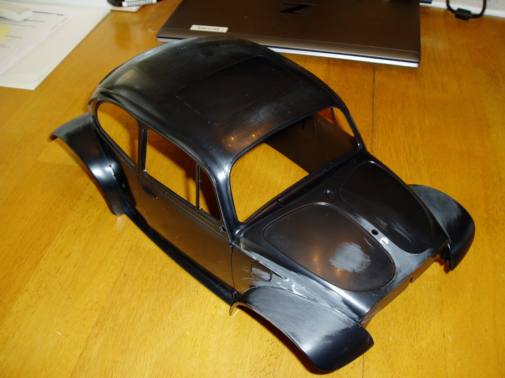

Used a sharp Xacto blade to remove the mold flashing from the fenders.
When I screwed the front nose on, the gap was pretty bad, and was causing it to look crooked, or higher on the passenger side. Got it screwed together so it can't move, and put putty on it.
Kept reading about people getting the Sand Scorcher body all painted, and painting the nose separately as the manual recommends, and then after, screwing the nose on and finding a gap, or fit issues. Going to start with the nose mounted, and paint with it on.

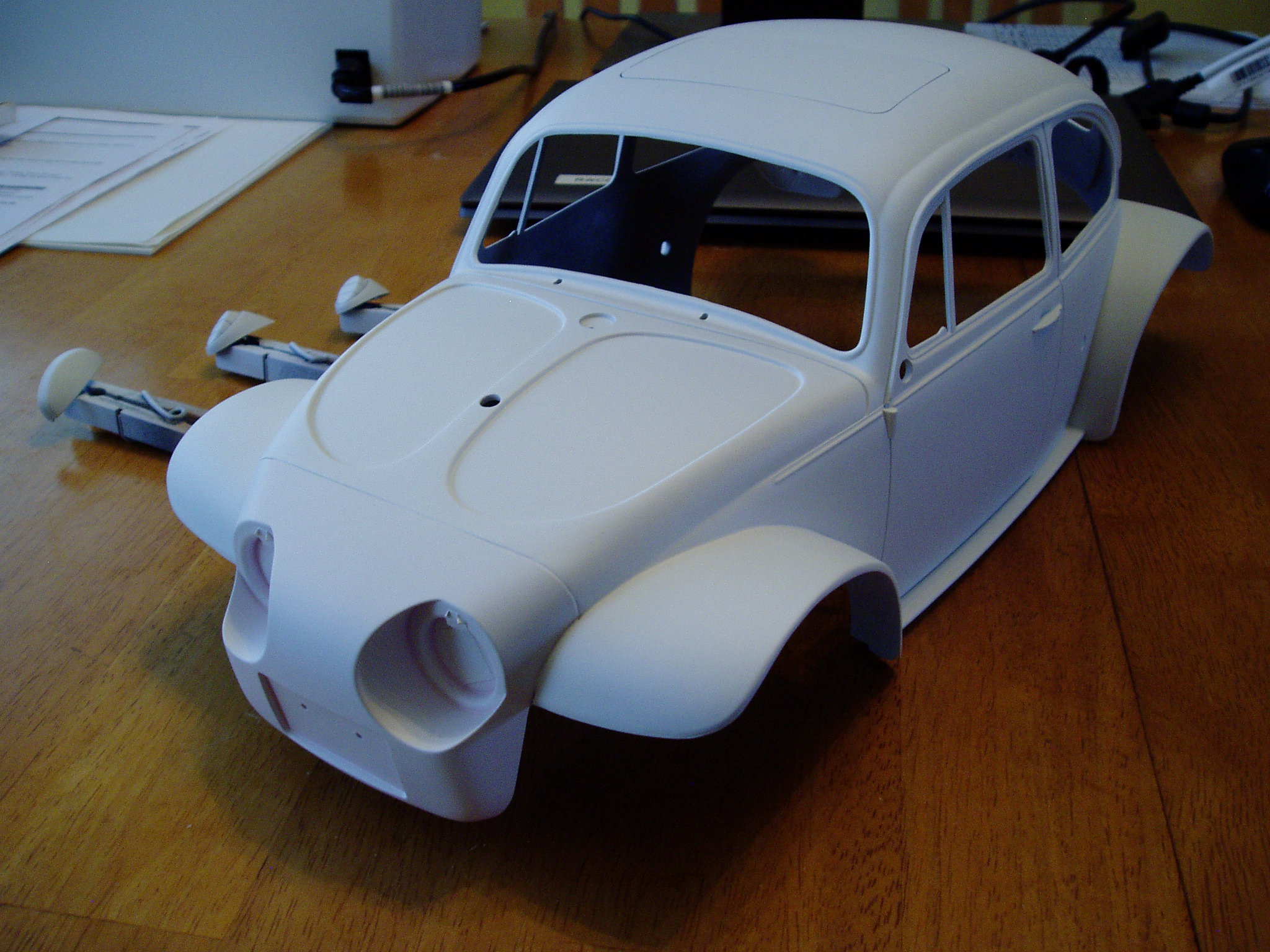

Yeah, the nose fits very tight between the fenders without paint. I can't see how you could install it after paint. Not without scratching it anyway.
I paint mine as an assembly.
On the Blitzer Beetle body (maybe SS body as well), there was an odd recess above the front fenders (ahead of the gas door) where the molds come together and I spent a ridiculous amount of time filling, filing and sanding those areas to make them smooth.
The Beetle body is a challenge, that's for certain.

Looking good.
You're brave to tackle the nose-body gap.
I chickened out on mine. :lol:

Yours looks really smooth, excellent prep work! Is that with the primer on it?
Going to prep the body today by roughing the exterior to get it ready for primer. The weather has not been good for painting anything around here, the last few days.
Thanks again. Yes, it has been primed at that point. Since the nose is molded in bright orange, I was concerned about coverage and opacity but after several coats of primer, everything worked out okay.
Be careful as you sand and prep the exterior. The plastic is soft and deep sand scratches can project through the final finish. I've learned this the hard way from earlier projects. :oops:
I think I used 600 or 800 grit and applied light pressure to prep the Beetle bodies and that seemed to work.

XLR8 wrote: Thu Apr 25, 2024 4:44 pm Image
I had thought that was your Sand Scorcher body, wow that's the Blitzer black and orange body, incredible that you got it entirely covered, and so smoothly. Hope I get anywhere near those results, well done!
Also, much appreciation for sharing your experience and knowledge with these ABS bodies, I'm brand new besides an easier Tyrell P34 body I'm working on, I'll be certain to take it easy with the pressure and the grit when sanding, thanks again!

Got the body sanded, 400 grit to 3000.
The putty will get another going over with the sanding sponges tomorrow, as well as finishing removing the mold issue on the body above the fenders.
The Fine primer got here today, looking forward to getting this sprayed on.
