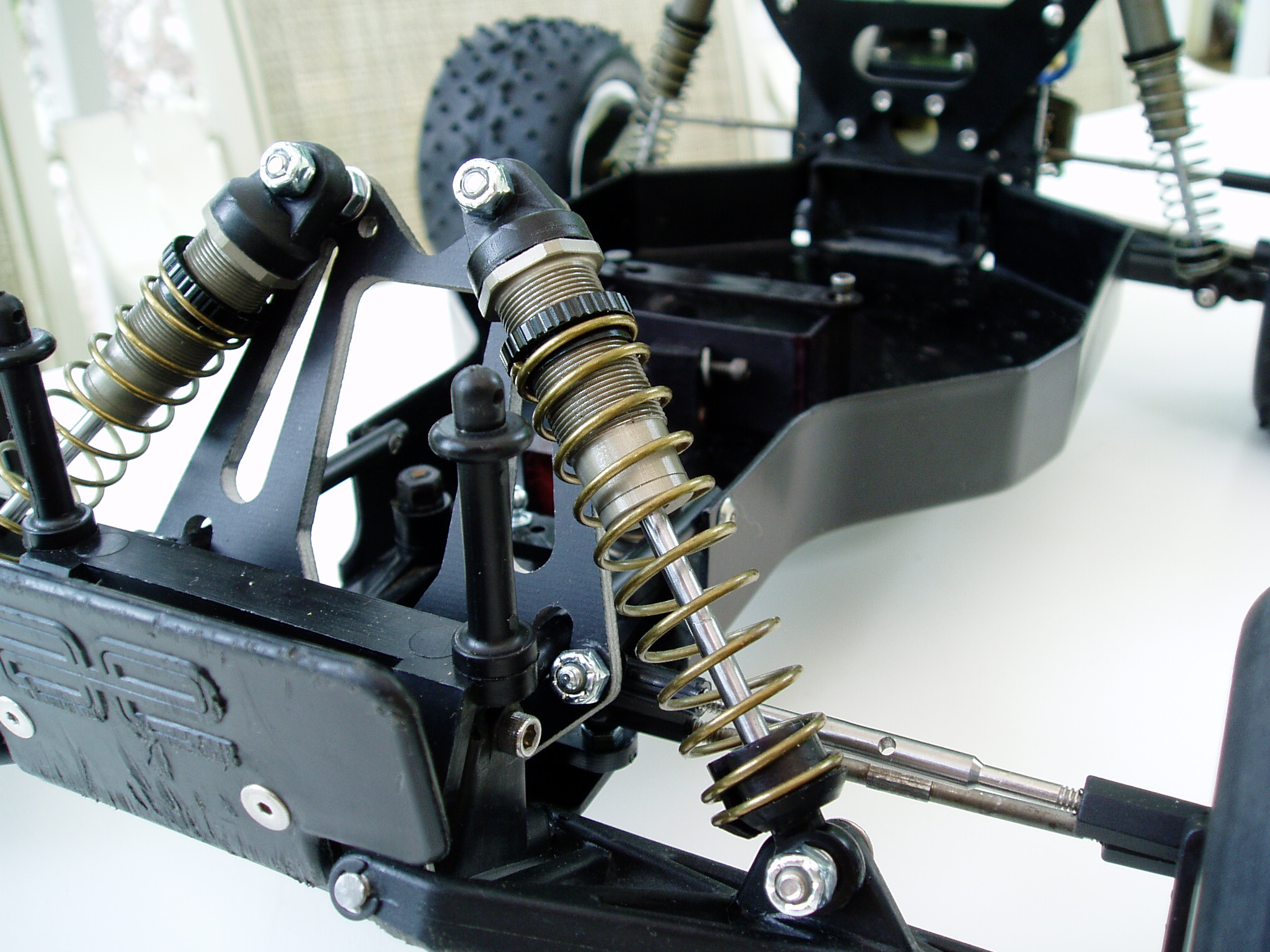

Well, best I can do is 25 degree castor blocks with some shims under the ball stud to bring the links parallel - or closer to it. This setup will be placeholders until I can source the proper ones. I want to keep the project moving forward.
Built the shocks today so the chassis is nearly finished. Tires are mounted. Body arrived last Friday and paint should arrive Wednesday. Paint work will take some time - red, white, blue, silver, black shading -- lots of masking.

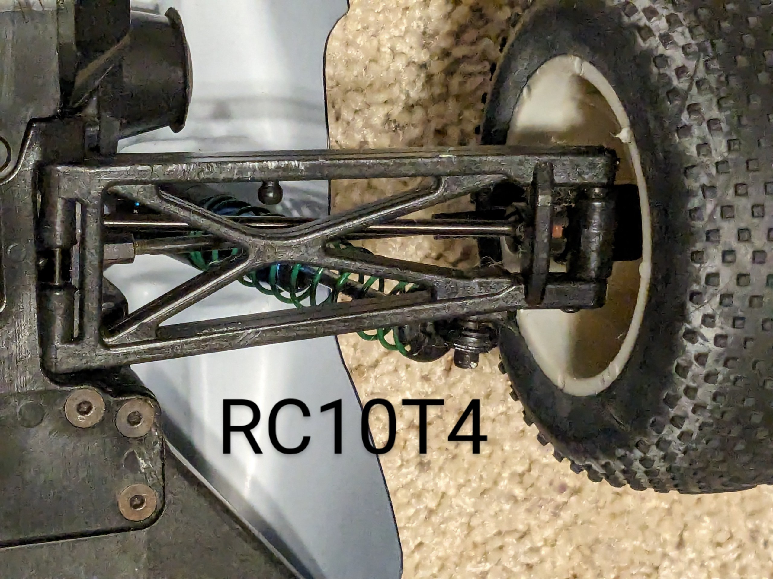

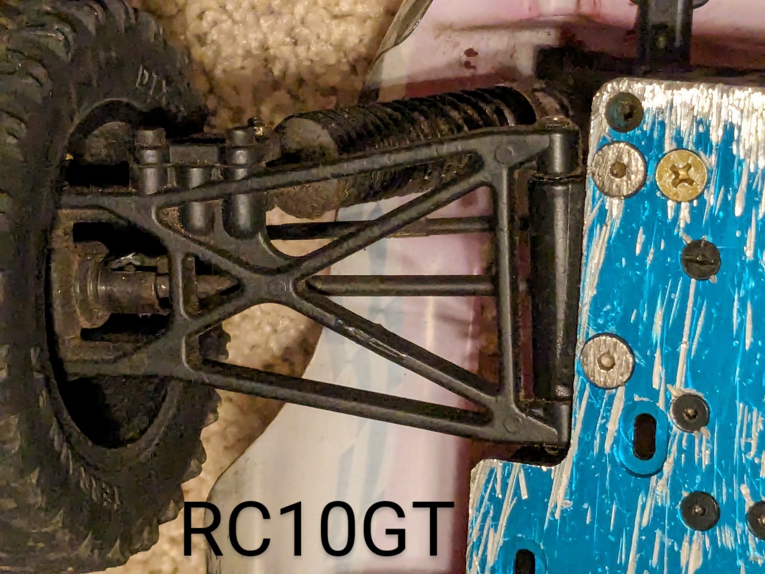

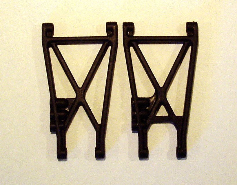

So the replacement arms have arrived from Factory Works. Thanks again Jeff.
Notice the difference (original arm is on the right).
The new arm lacks a stringer at the wheel end. I'm guessing the replacement arm is a later design?
With this design, perhaps some torsional rigidity is sacrificed but the droop problem is solved.
Of the two, I prefer the new design; droop is more important than torsional flex.

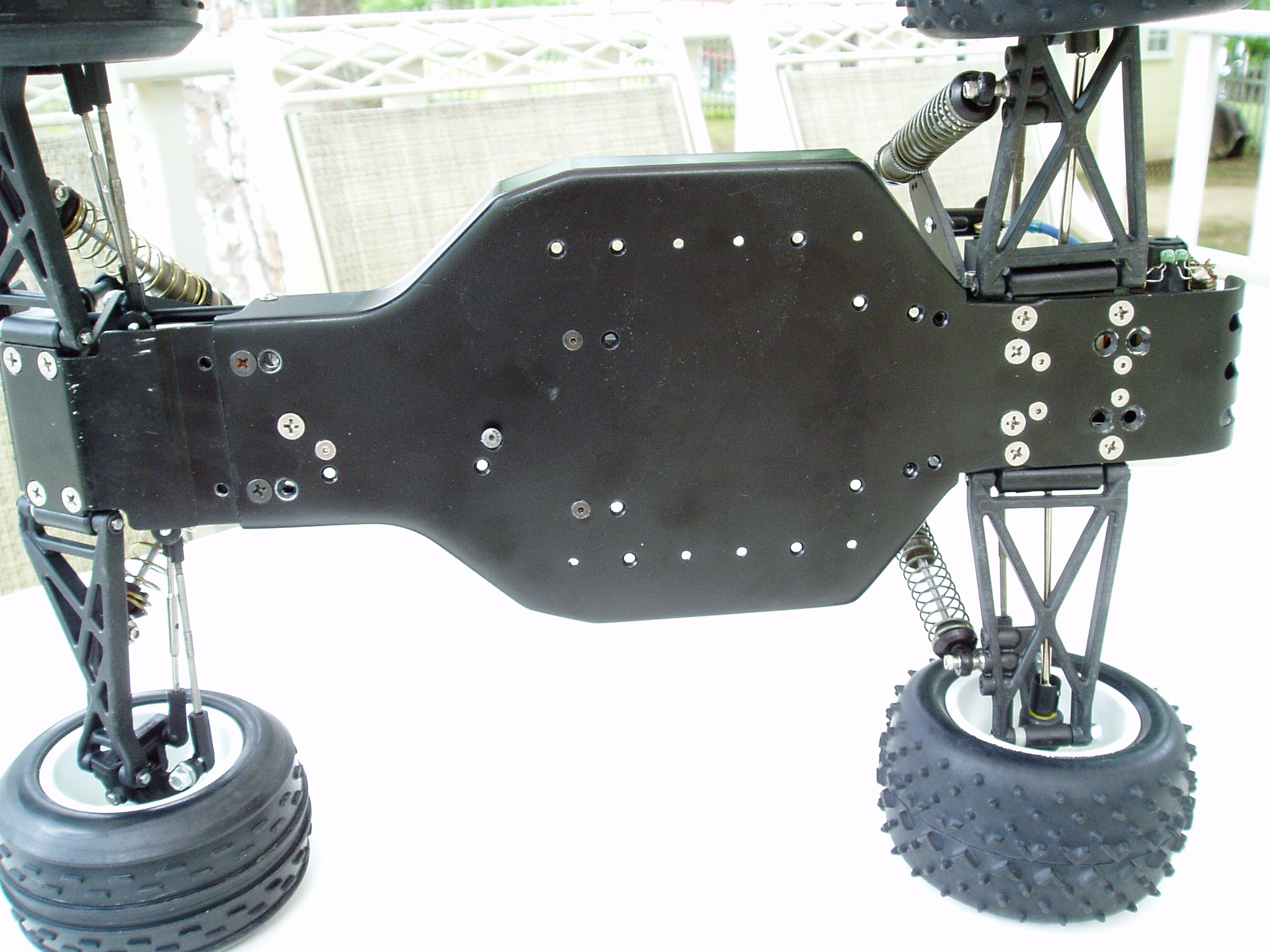

Looking at the 10T manual and noticed the servo is fixed with tape not blocks. It seems very odd that it isn't screwed to the chassis like the buggy - especially considering the added resistance from the truck's larger wheels. :?
Anyway, it's always been my experience that even the best servo tape will still allow for some movement under a load.
Looking at the 10T re-re's photos, servo blocks are provided so maybe AE has reconsidered their earlier approach to attaching the servo.

My original 10T bitd had normal servo mounts*.
* I am old and often remember things that never happened. Pretty sure on this one, though.
Posts: 12336
Been thanked: 3919 times
Re: My first RC10T. But, what is it?
the 10T for some unknown reason had the servo mounted to the opposite side of the chassis which meant there were no servo holes. I think the sport truck still came with servo mounts as the MSC used them. Not sure why they didnt use the holes and flip the bellcrank

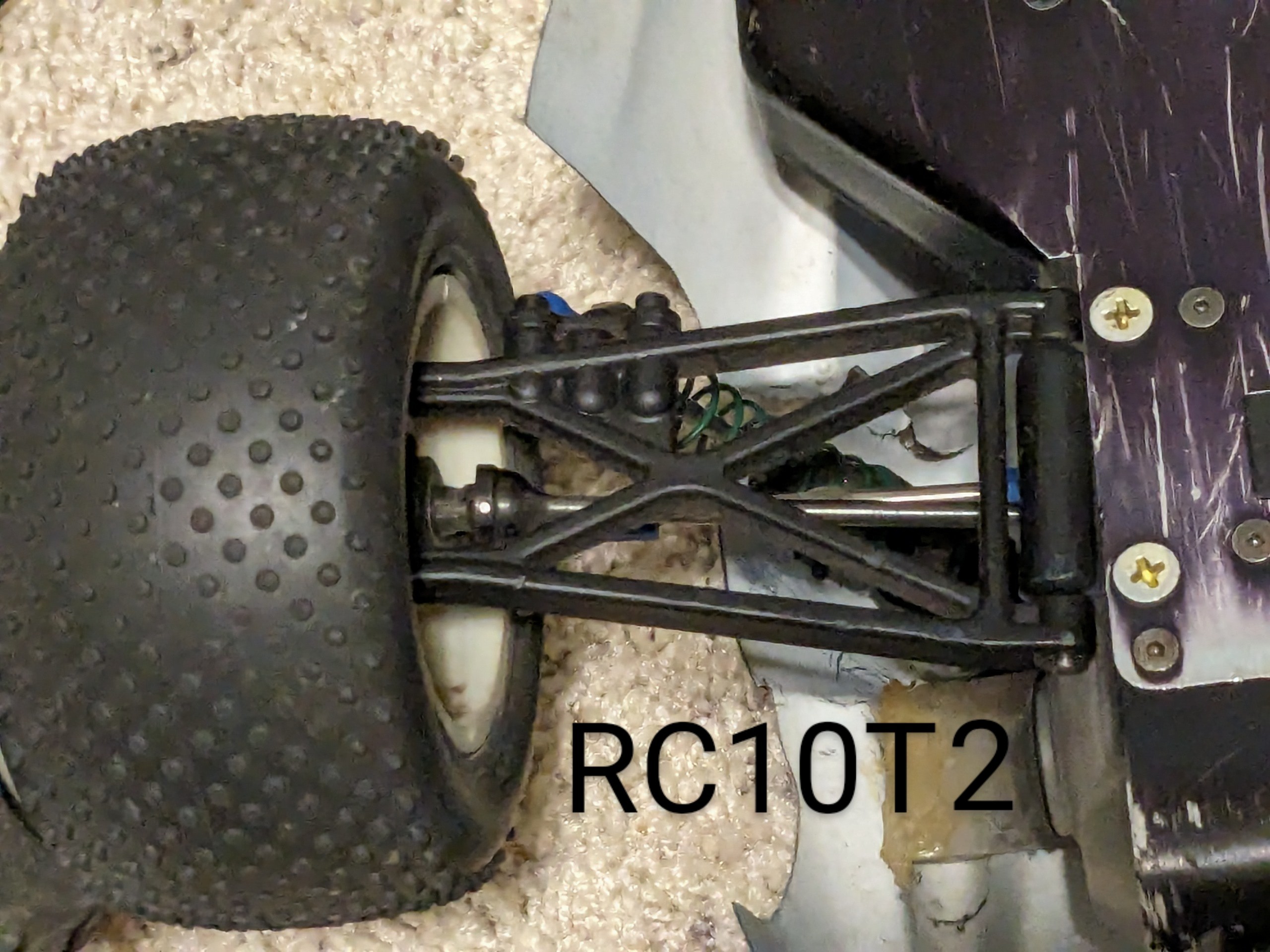

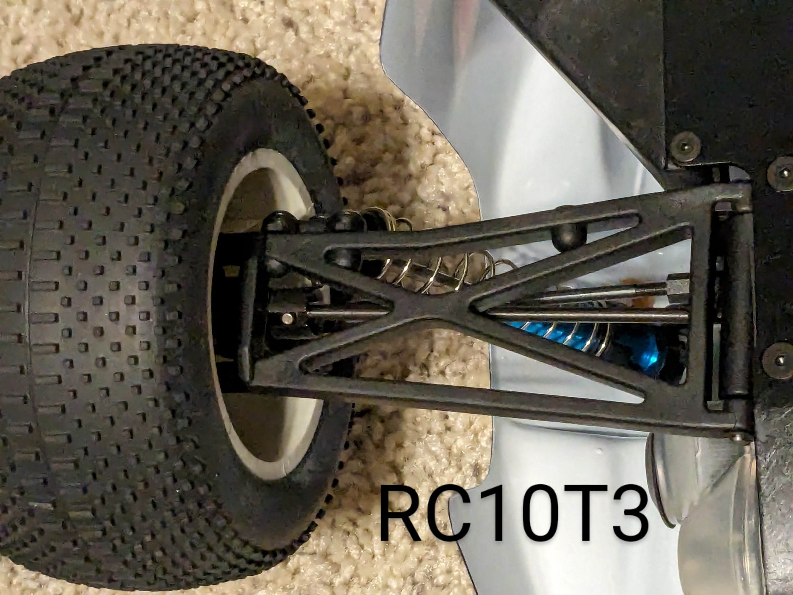

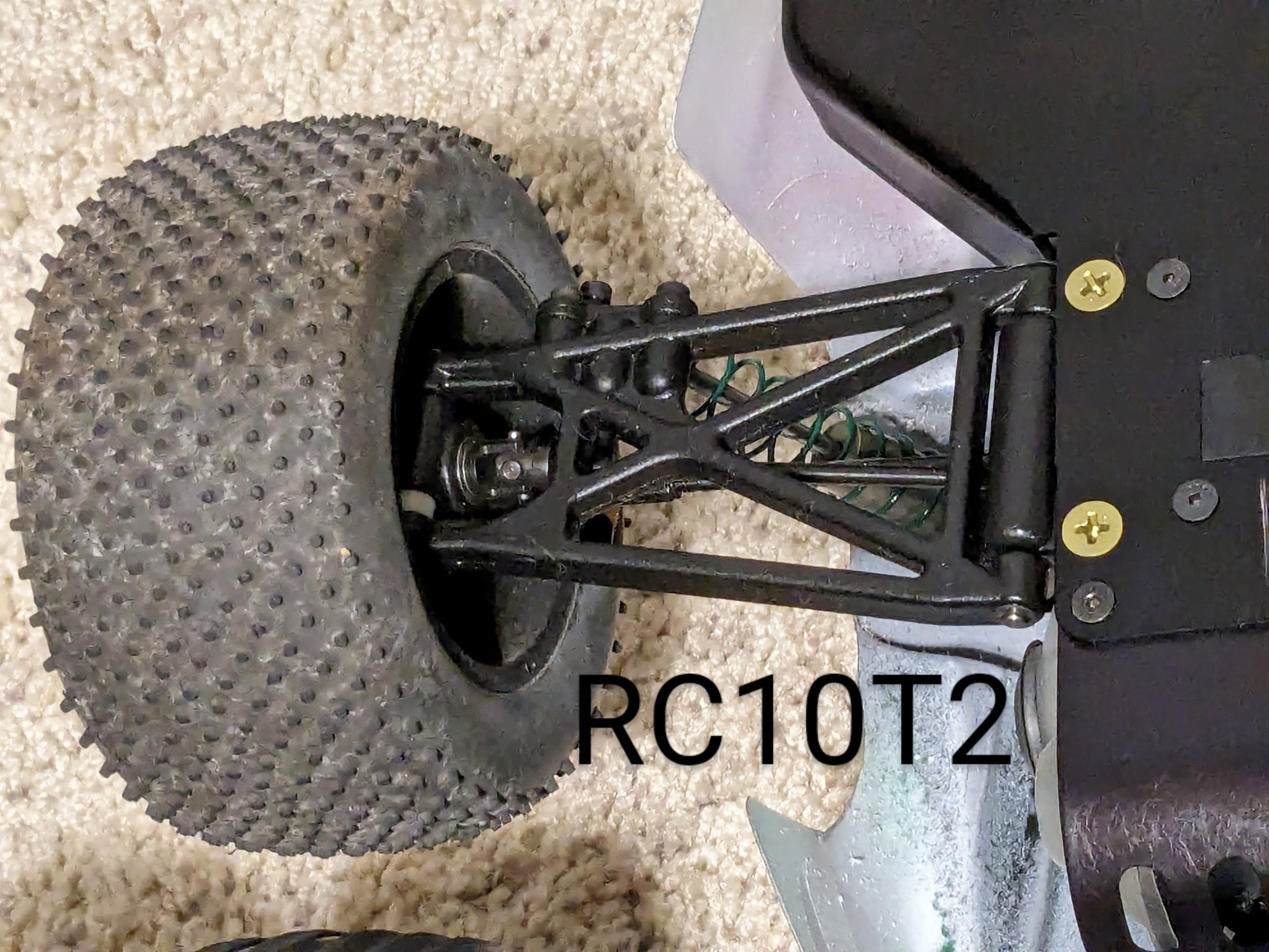

I hadnt noticed those arms, interesting. Ill have to dig through my others and see if I have variants.
Posts: 3811
Has thanked: 2606 times
Been thanked: 2980 times
A few of the versions from T to T4, and GT:

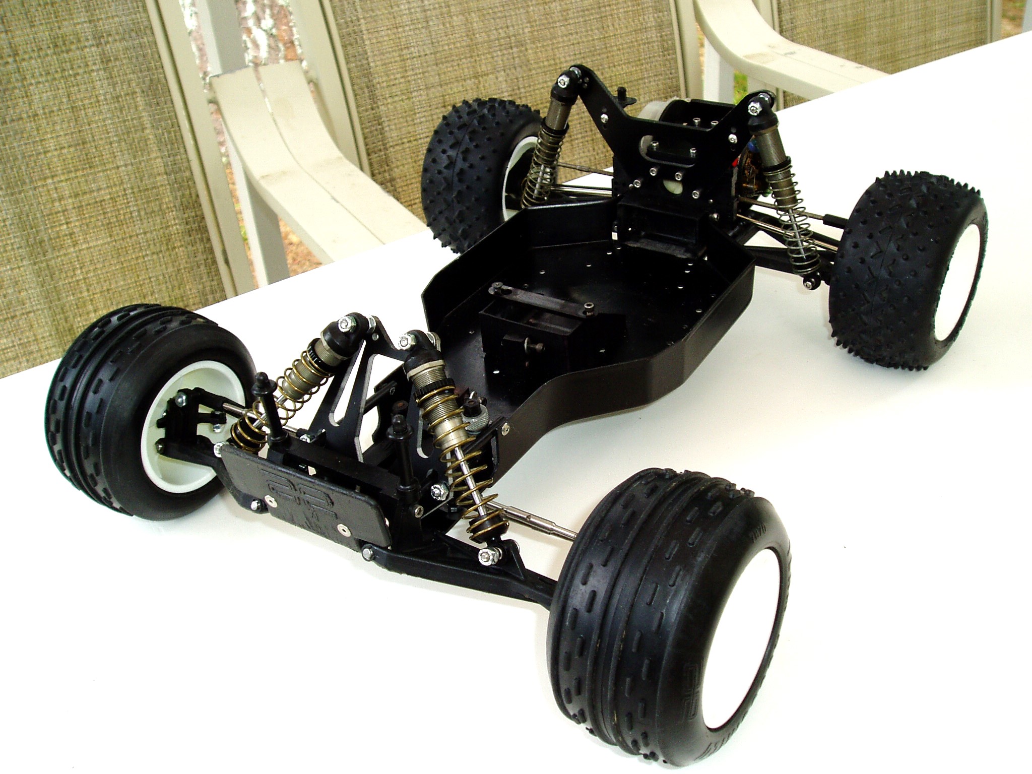

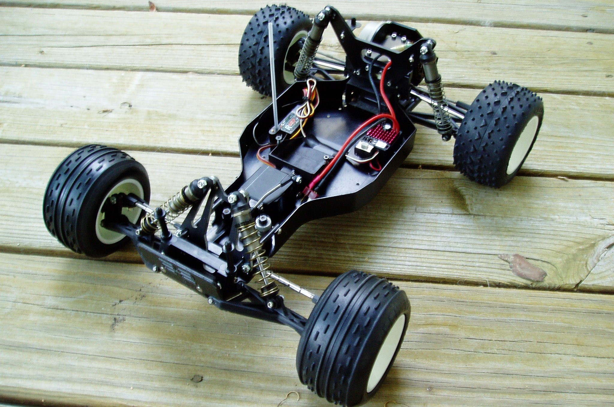

The chassis is finished so thought I'd post an update.
The tub has spent some time as a buggy so a quick coat of matte black hides the scratches.
I've had a couple new sets of these threaded shock bodies for a while and this seems like a good project to use a set.
Having never before owned or even driven a 10T, I don't want to drop-in a high HP brushless system until I've spent some time learning and dialing-in the truck.
So, I'll start with this brushed Reedy Radon which I think is 15 or 17 turn. Stealth cases are new. New stainless fasteners throughout.
That's it for now -- more to follow. :D

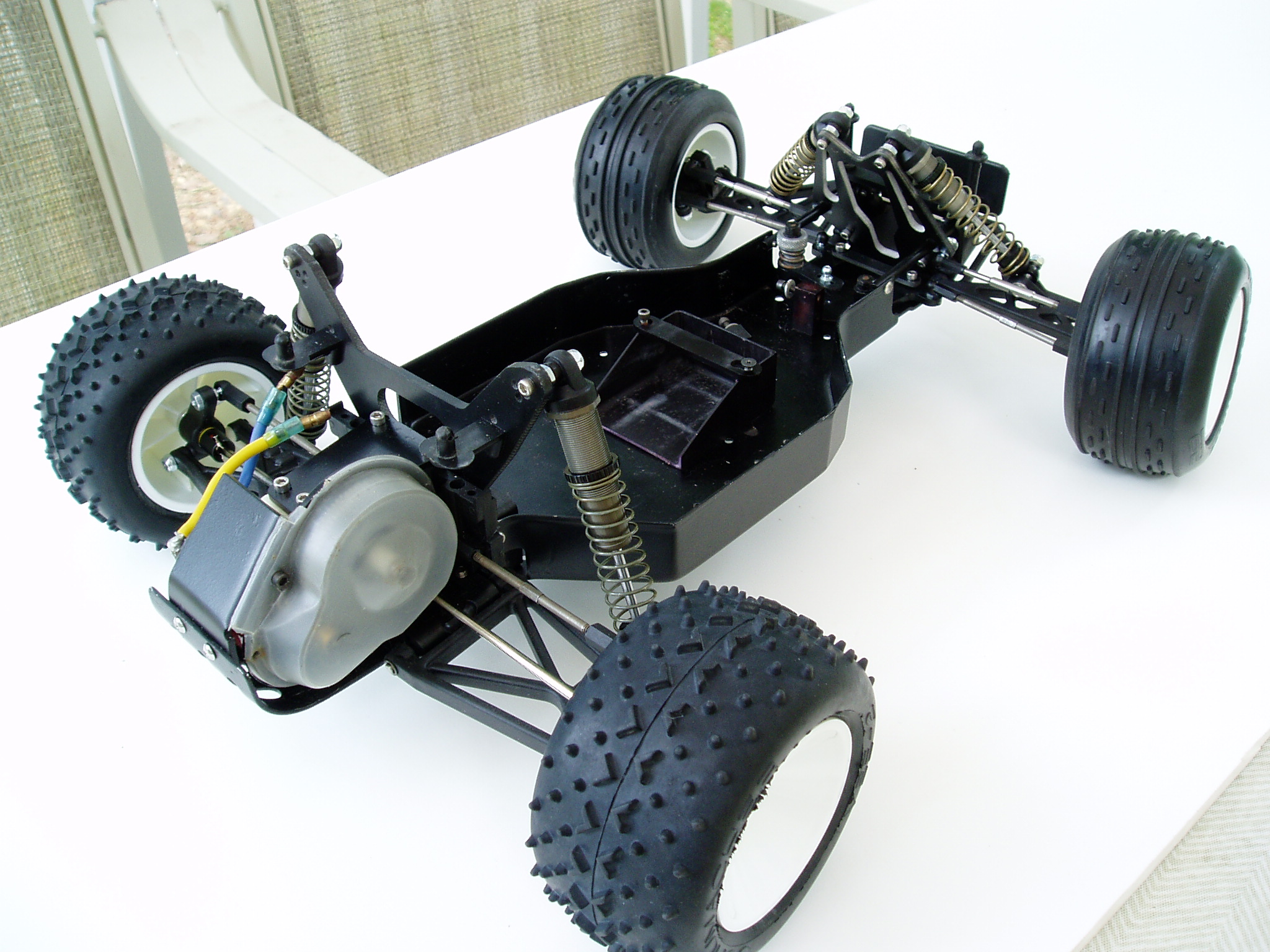

I've installed the electronics this afternoon so it's a runner now.
Reedy 1523MG, Dynamite branded HW 1060, and a Corona Futaba compatible Rx.
I have the body cut and fitted so I just need to mask and apply paint. Still waiting for decal sheet from MCI.
