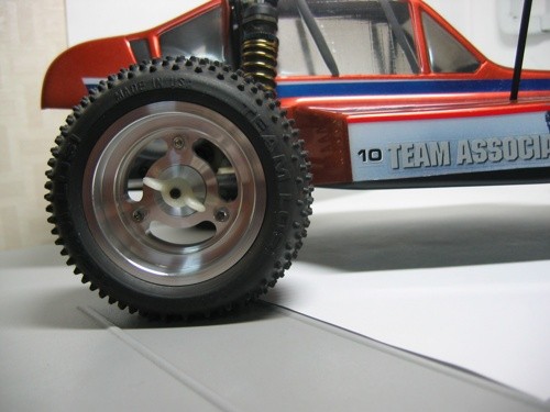

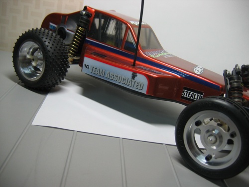

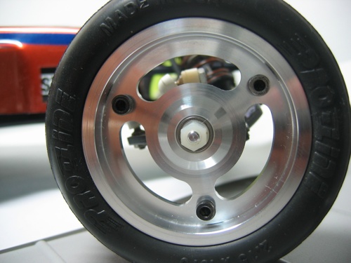

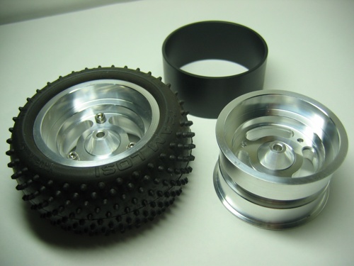

I just got some pics from pargu2000. I sent my RC10 with bunch of wheels and old/modern tires to make these wheels.
thanks for sharing your ideas
everything looks fine to me. but, I'm afraid that the screw holes look metric. I mailed him to check this out.
I'll post at the B/S/T area after I get the real one. it's just a quick view
and, he didn't make the plstic rings for front. and, will not. you need sotck 2.1" rings for front. and, work fine with 2.1/2.2 tires

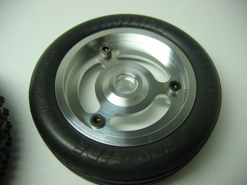

one bad news is the screws are 3mm ones. but, I still like these rims. I'll get the price soon.
- 59burst
- Posts: 1011
- Joined: Sat Jul 26, 2008 9:52 am
- Location: Bothell, WA
Re: 2.2" F/R 3-piece jelly bean alloy rims - PICS in the page 4

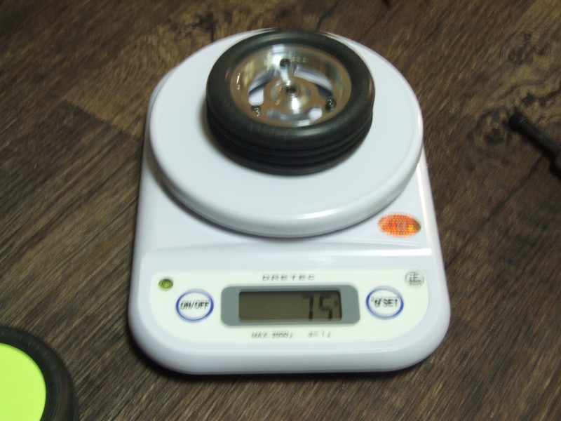

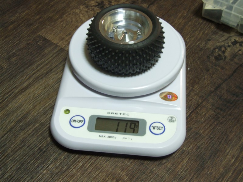

go the rims a few hours ago.
the 3mm black coated stainless screws look fine. but it's much heavier than expected.
I put Proline dirt hawg tires on rear. and had a play between them. a single layer of 3M tape worked fine for covering the gap.

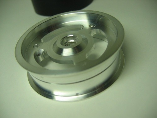

that is the one problem I find with his wheels that he makes I don't know what he is leaving for a wall thickness but he needs to thin them down some on his other wheels I see that he removed some of the ribs on his optima wheels anyway he could probably get away with a .032 wall thickness to remove some of the weight59burst wrote:go the rims a few hours ago.

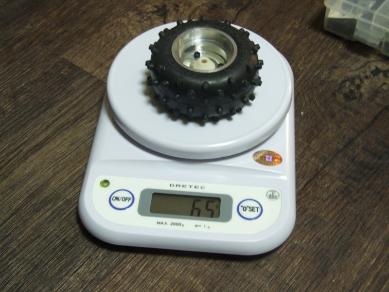

disks' thickness gain extra weight on F/R both

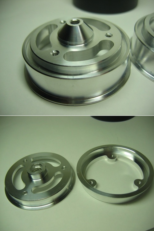

I found these between the pics he sent me
- murphy3428
- Posts: 579
- Joined: Mon Oct 06, 2008 11:19 am
well they look great, maybe he needs to do a little fine tuning on the weight issue which he should be able to machine those walls thinner the center of the wheels look pretty thick I can understand the threaded side needing the extra thick wall but not the outer side,I wounder if all of the wall thickness on those wheels are as heavy as the center.
- 59burst
- Posts: 1011
the outsides and ribs are fine. only the center areas gain the weight. I'll update later
- 59burst
- Posts: 1011
fine tuning started. making the disks thin
