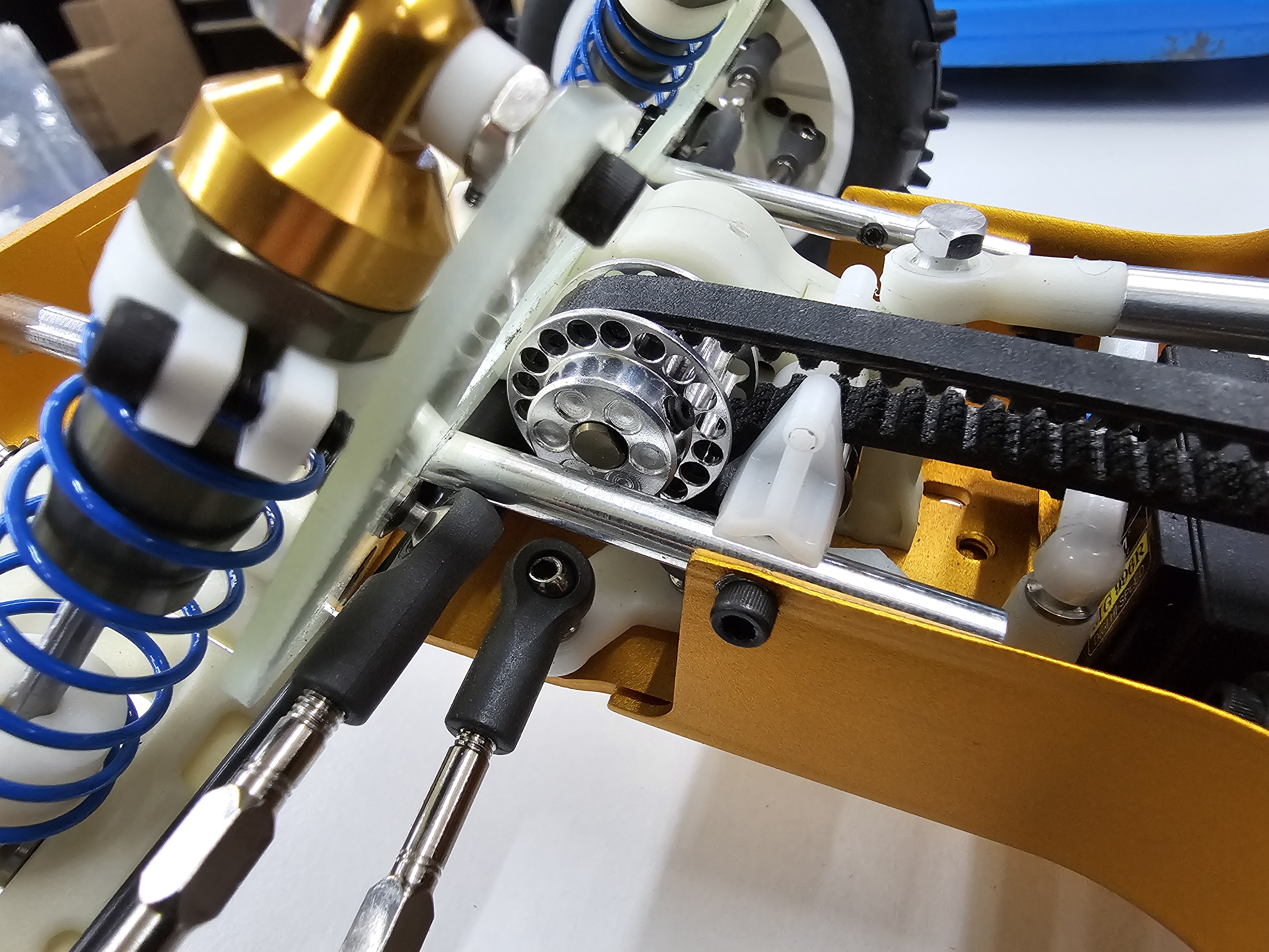

I see that you are using the supplied belt tensioner. I have a RC10 belt and a Factory Works belt. Will the FW belt work with the tensioner or do I need a longer one?GoMachV wrote: ↑Thu Apr 17, 2025 11:30 pm Forgot to mention, we have the RC10 4WD chassis braces in stock now as well. These do not fit Ten4 or any other platform
https://factoryworks.com/shop/ols/categories/team-associated-4wd
I tried the FW works one and it was pretty tight.

I'm confused as to what you are asking. The 582 tooth fw belt for the ten4.1 too long for the AE 4wd, since they use 15t sprockets and we use 18t. Their belt is a 573, same as our original Ten4. I'm not sure I understand the combo you are using. If you are using 18t pulleys and the fw belt you should be fine, the belt is about right when it's run fully loose, and will stretch within a couple runs.
- Supernaut
- Posts: 131
- Joined: Tue Nov 05, 2013 5:30 pm
- Location: Algonac, MI
- Has thanked: 5 times
- Been thanked: 68 times
Re: The RC10 4wd
Yes sorry I was not clear. I am using the FW 18T Pulleys and Belt on the RC10 4wd. I had a hard time using the RC10 4wd tensioner.
Thought I would need to design and print one that was not so close to the Pully. Belt was really tight.
I will give it a try again.
Thanks
Yes couple runs sounds right!

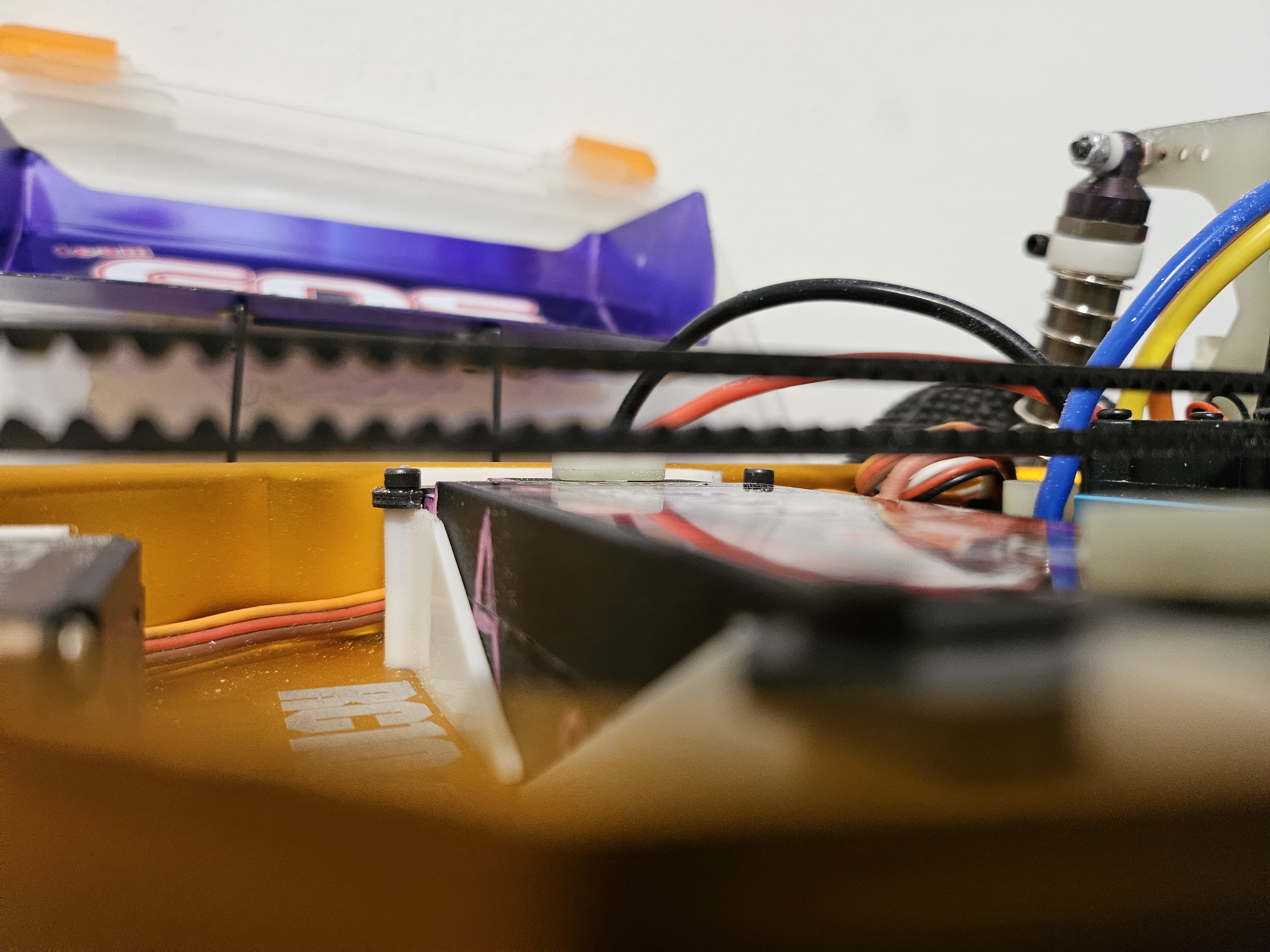

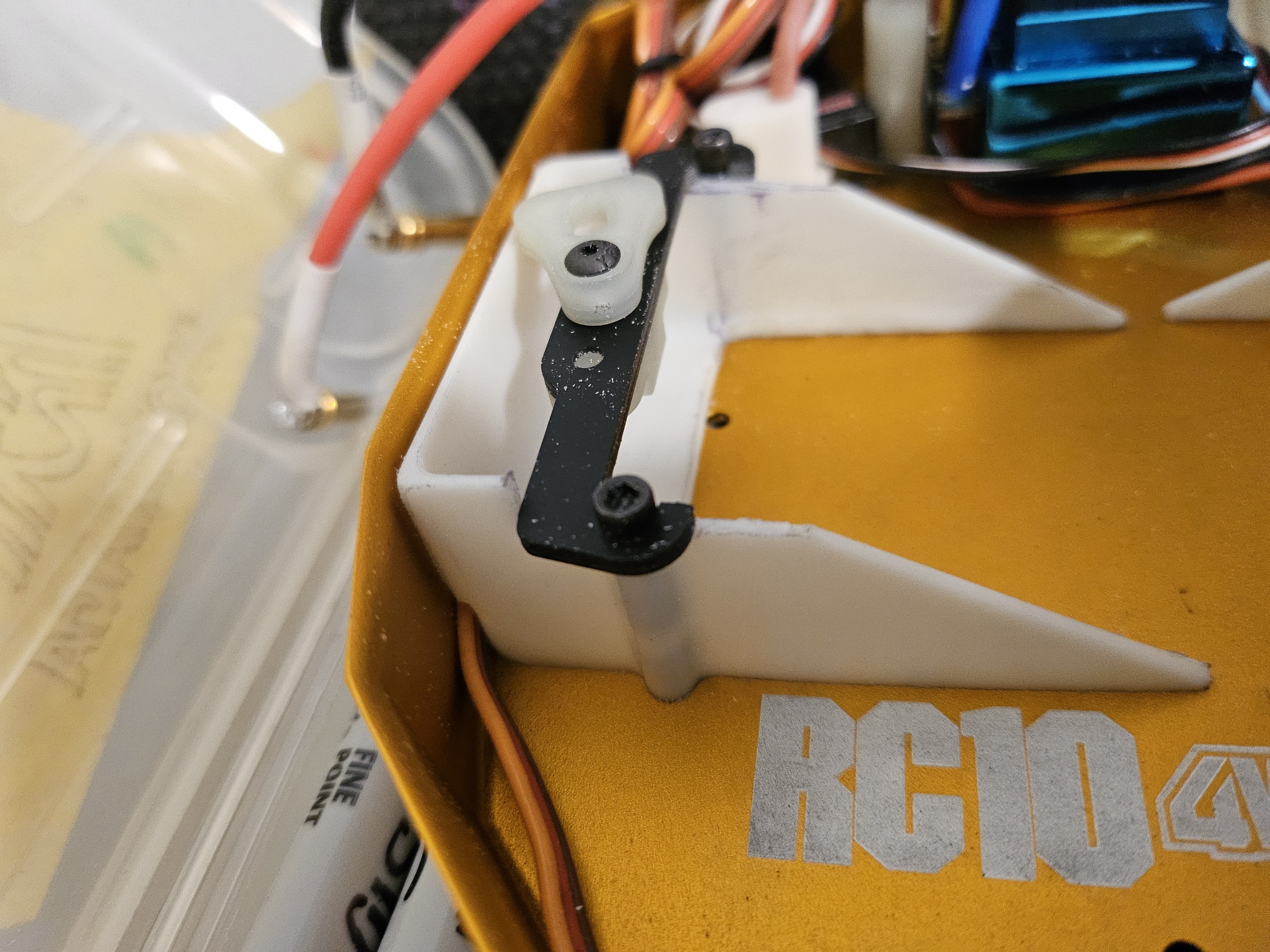

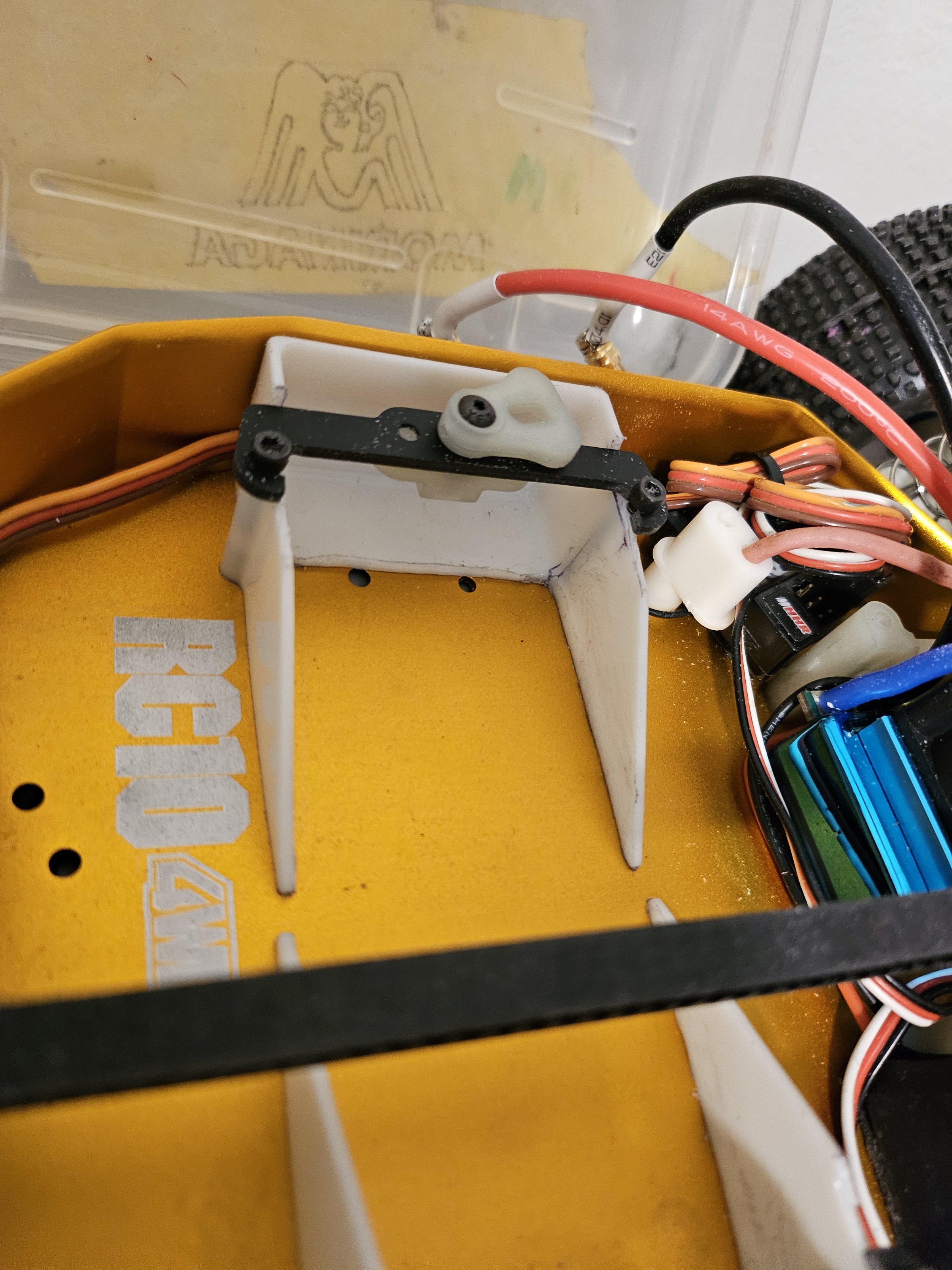

Handfitted the battery hold down
I made some mods to fit some gaoneng lihv batteries i recently purchased. These are 22mm thick vs the typical 25mm thick shorty lipos or the lcg shorties which are 19mm thick but have are a little too low on the capacity for a good bash or race...
The mods I made to ensure clearance of the belts were:
-Cut out the bottom of the battery trays
-Trim the tops of the battery trays so that the battery hold downs can be mounted 4mm lower.
-dremel out the battery strap bolt area to widen the strap mounting area. Cos the 22mm batteries are a just that bit wider (0.5mm, but enough to make it hard to install in the car)
And finally... I'm still waiting on a chassis brace.
