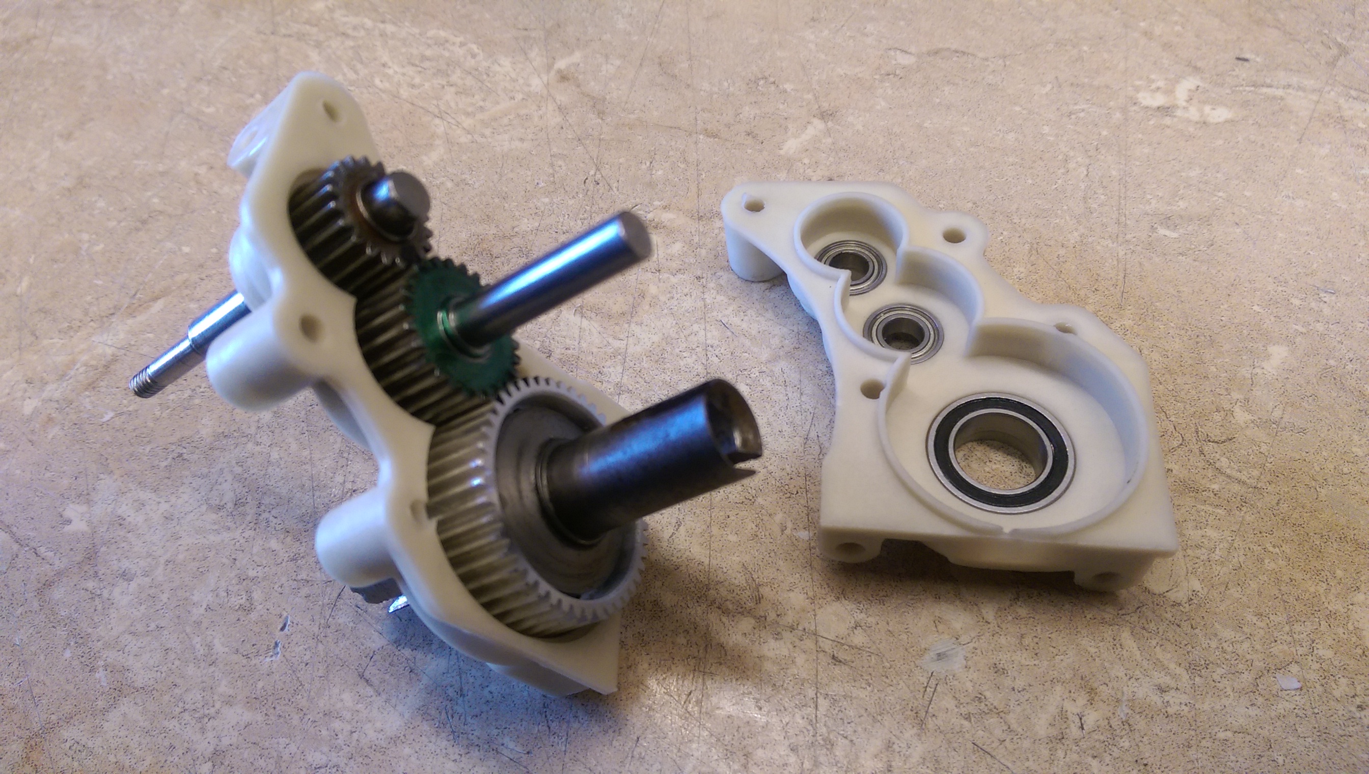

Rear gearbox uses a idler with bearings in it. The earlier stealth uses a live shaft with bearings in the case. If you can make the bearings fit in the case you could use the Robinson racing pieces for the ten4. Tooth count is the same. Belts we use are 6mm wide making them easy to source on amazon.com very cheap

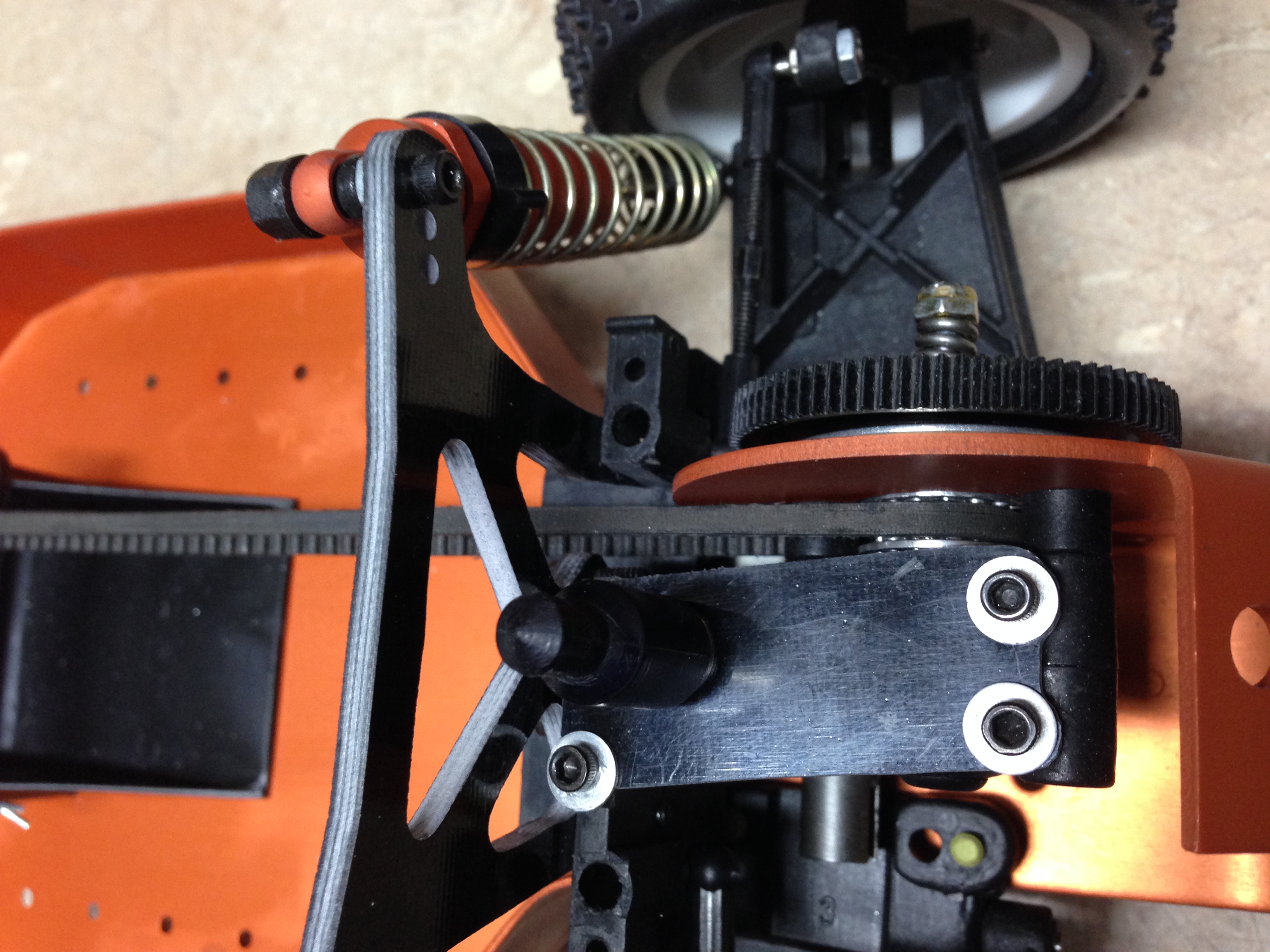

You could avoid dealing with the B2 idler by running the pulley off the top shaft behind the slipper. Similar to Georg Kotzinger's converted B4.

Oh cool! I did this too, Jake made me a custom slipper with pulley built in. I didn't like the three gear front trans but I suppose it could be straight to a pulley if the ratio could be made rightPhin wrote:You could avoid dealing with the B2 idler by running the pulley off the top shaft behind the slipper. Similar to Georg Kotzinger's converted B4.

it's gotta be either 3 gears or direct drive off the top shaft(or 5?) to get the drive the right direction. with a a non centered belt that kind of kills the direct drive idea unless you make the front a spool.
the kickup angle on 4wd cars is much less than 2wd, I suppose this is due to the driven front wheels needed less 'give' on entry to a bump. If you match a B44 kickup like Bugle did, you can use B44 front end parts.
Much of the reason for the custom front end parts on the Ten4 is because of the rc10 30 degree kickup.

Or, like MIP: with the pulley on the idler before the diff; then you only need a 2 gear front.
Or a mid motered 4 gear in the back; with pulley on the topshaft and again a 2 gear in the front.

Front spool or a oneway.jwscab wrote:it's gotta be either 3 gears or direct drive off the top shaft(or 5?) to get the drive the right direction. with a a non centered belt that kind of kills the direct drive idea unless you make the front a spool.
You can also do a two-belt setup to center the front diff. Belt off the trans topshaft to a pulley on a layshaft somewhere inside the car...then a second pulley on that layshaft with a second belt to the front diff.
Then again many touring car front diffs are offset to one side.

layshaft could work with centered direct drive front diff. would be really beneficial to adjust ratios too. shorty pack would be best bet.
b2/b3 are super narrow up front,an offset diff would pose issues, standard rc10 has bad enough clearance.
Hmm....losi xx4 parts might be really useful here. I wanna say they are really similar up front.
