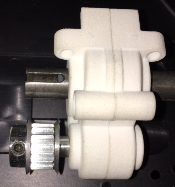

I finally had time to sit down and begin converting my re-re worlds to Ten4
Just a couple of questions that have come up:
I have drilled out the hole in the stealth, so that the flange of the inner part of the pulley now goes in to the gearbox. Do I need to do that with the shapeways front gear box too, or am I doing something wrong (see pic)? The large ball bearings in mk-zeros "hardware kit", what are they for?
And finally, what size of screws do I need to assemble the front gear box. As I have said before, I'm totally lost when the sizes are other than metrics, and I have found it easier to ask, that to try finding the right size myself
Excellent work guys, thank you for your hard efforts!

Re: Ten4: the 4WD RC10 project
Hi Tom,TomEG wrote:I finally had time to sit down and begin converting my re-re worlds to Ten4![]()
And finally, what size of screws do I need to assemble the front gear box. As I have said before, I'm totally lost when the sizes are other than metrics, and I have found it easier to ask, that to try finding the right size myself![]()
Glad you have found time to start building your Ten4.
ON the front gear box, yes, drill it out as you did the rear so that the boss on the pulley can slip inside and ride against the bearing.
The large, flanged bearings in the kit are the front tensioner rollers. Install them on the front tensioner shaft with the flanges facing away from each other. The belt rides on the bearings, between the flanges.
The front gear box uses #4-40 x 1" screws. The heads of the screws go on the right side of the car, and you shouldn't need to use nuts.
