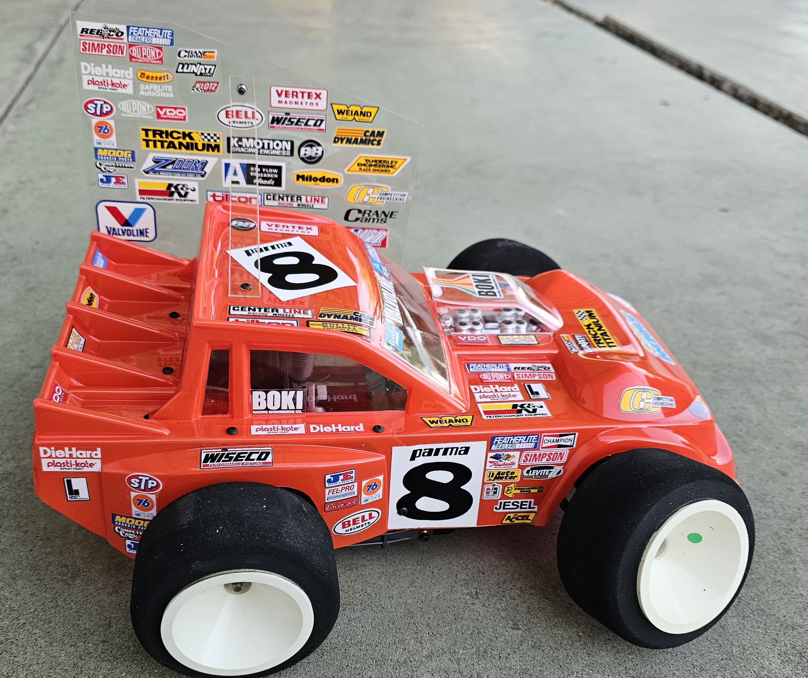

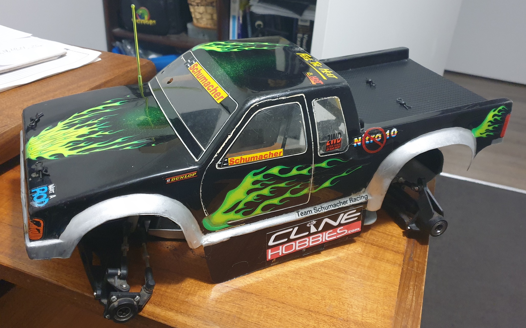

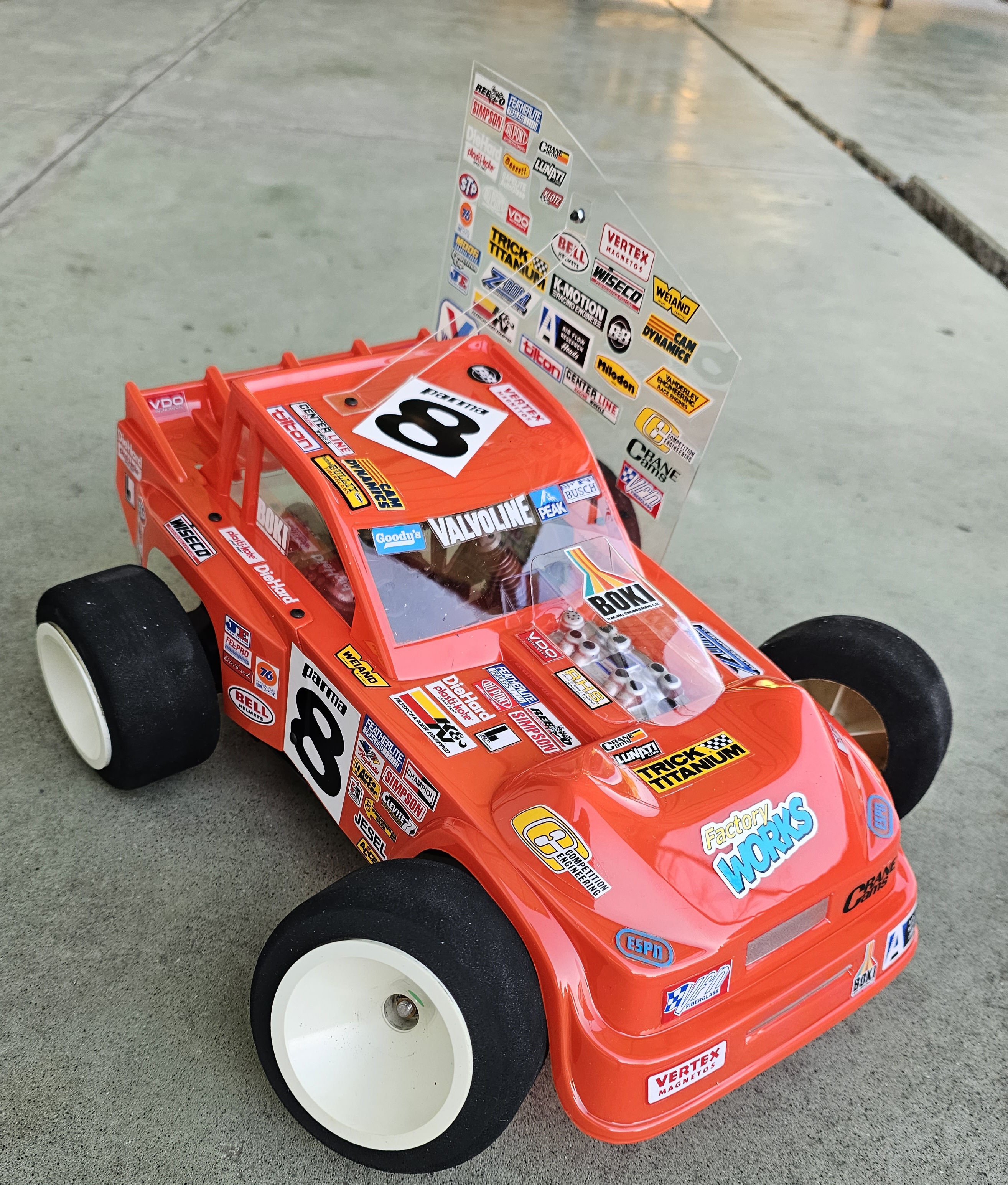

Decided to change up my comical JRX2 a little. Shortened the Factory Works Pro Mod Truck body (originals now available from Boki) by 3" and added a few contingency stickers. Made some custom oval towers, essentially the same as our LXT oval towers but I added 2x the holes to help with the comical look.

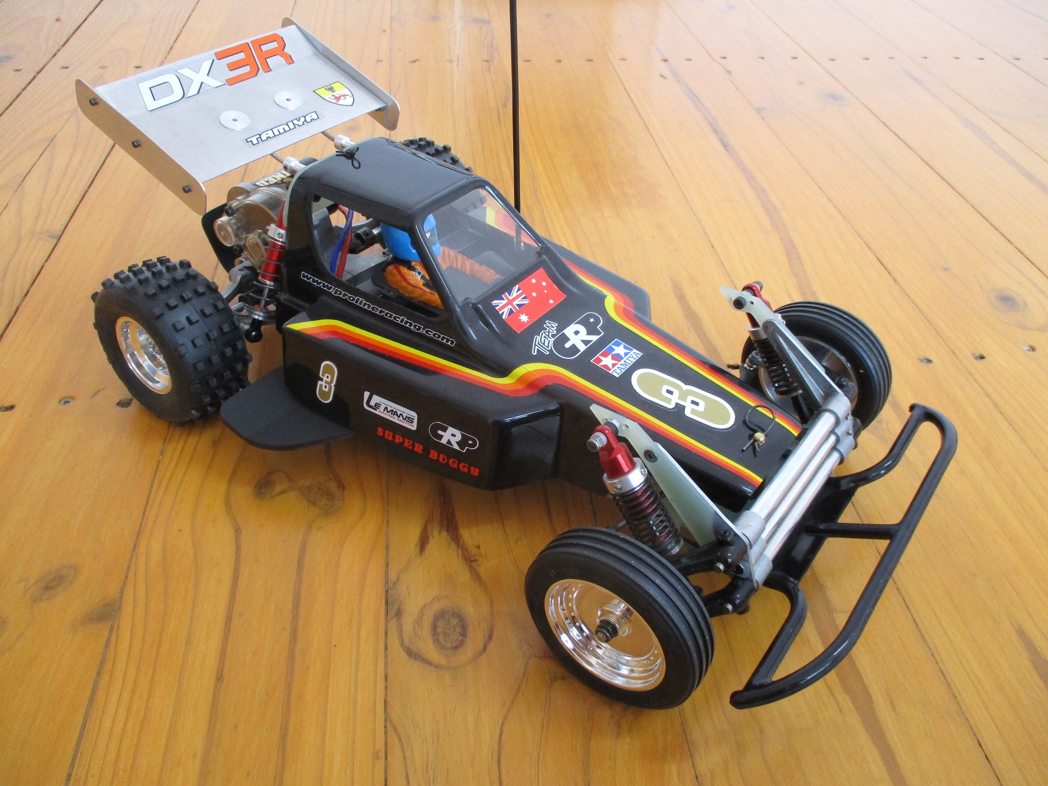

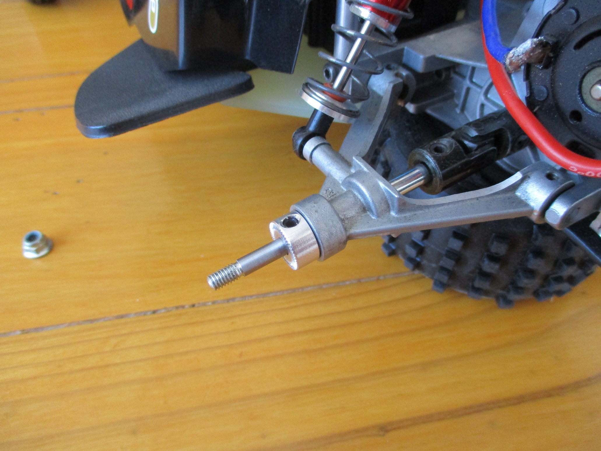

Machined two Tamiya re-release SRB rear axles from 5mm to 4mm diameter where the wheels sit and added Kyosho Scorpion drive washers to each.
This allows me to run unmodified Kyosho Scorpion wheels and tyres on the rear. The front wheels use four 5x8mm bearings. Swapping back to the older wheel/tyre combo takes no time at all.

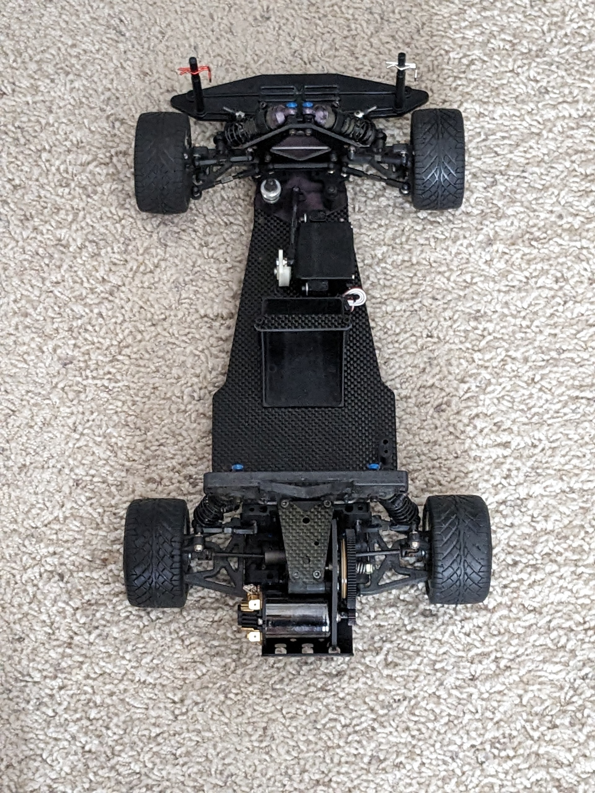

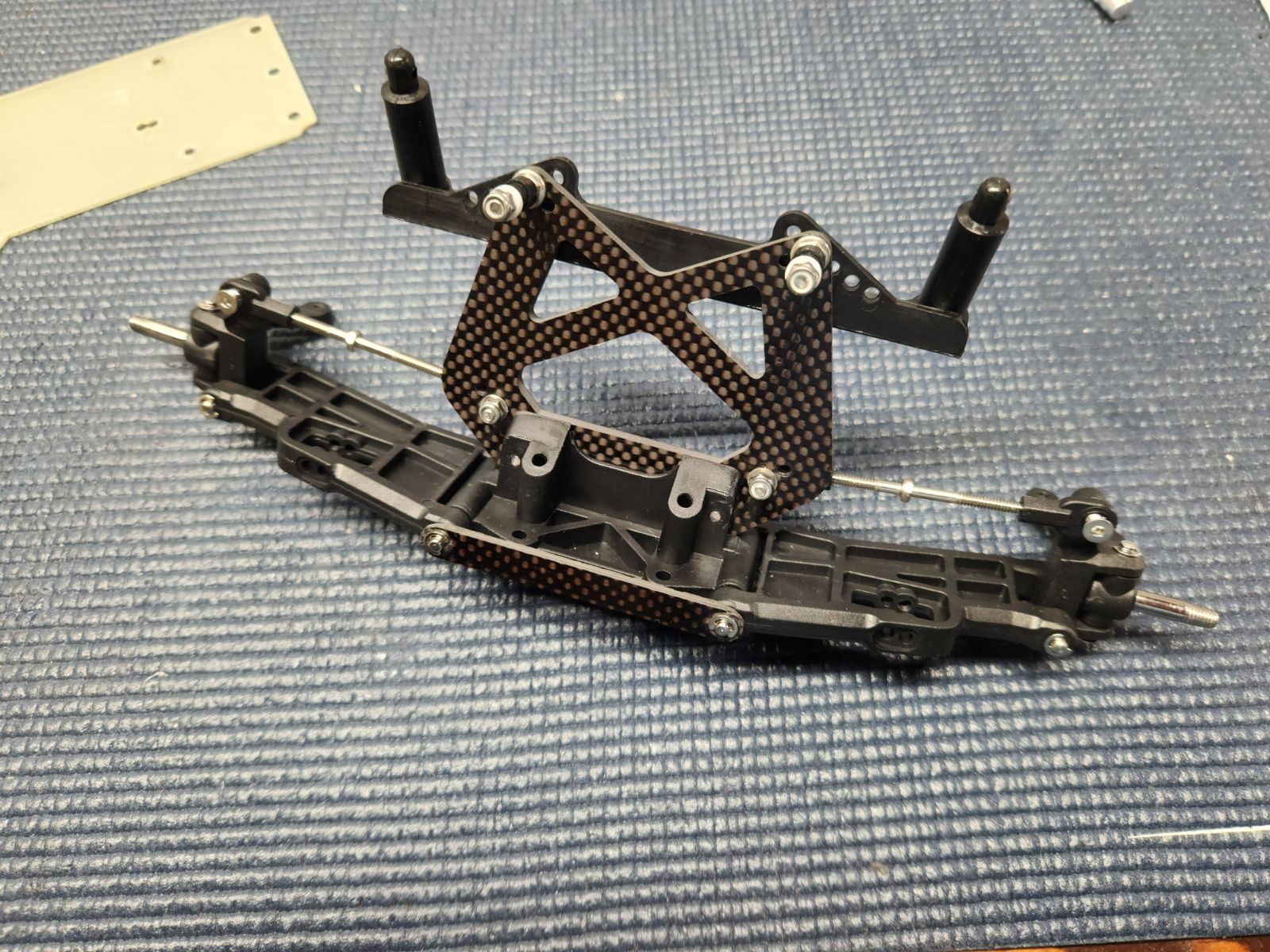

Start on putting the SRT together.

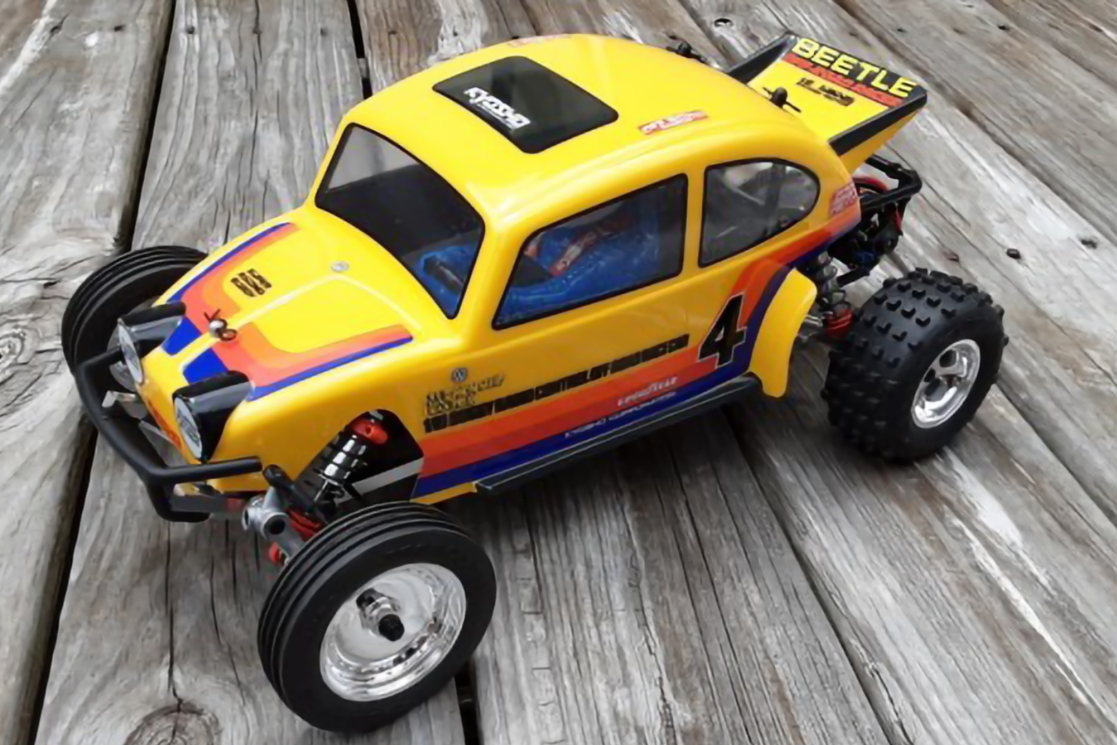

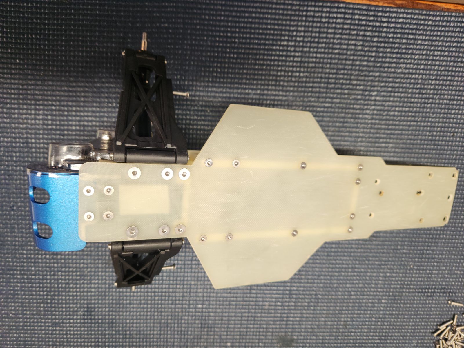

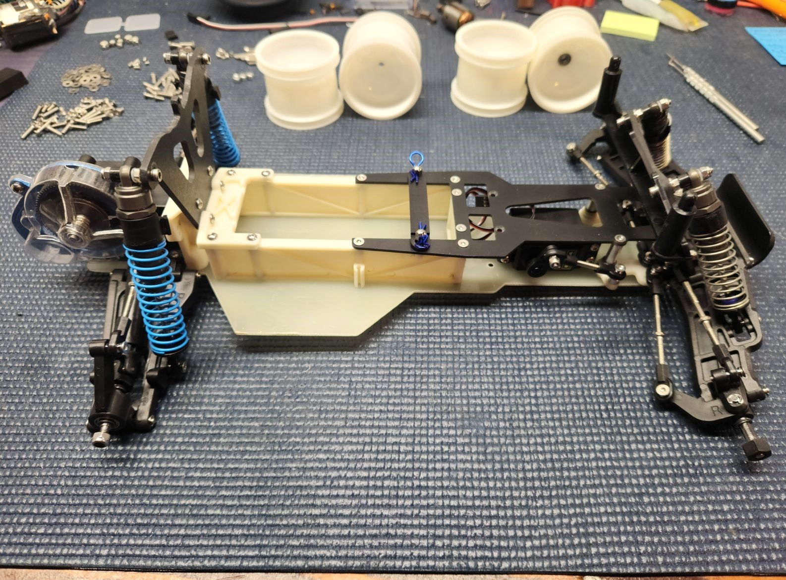

Worked on a DS that overall was in very nice condition other than needing a new chassis.

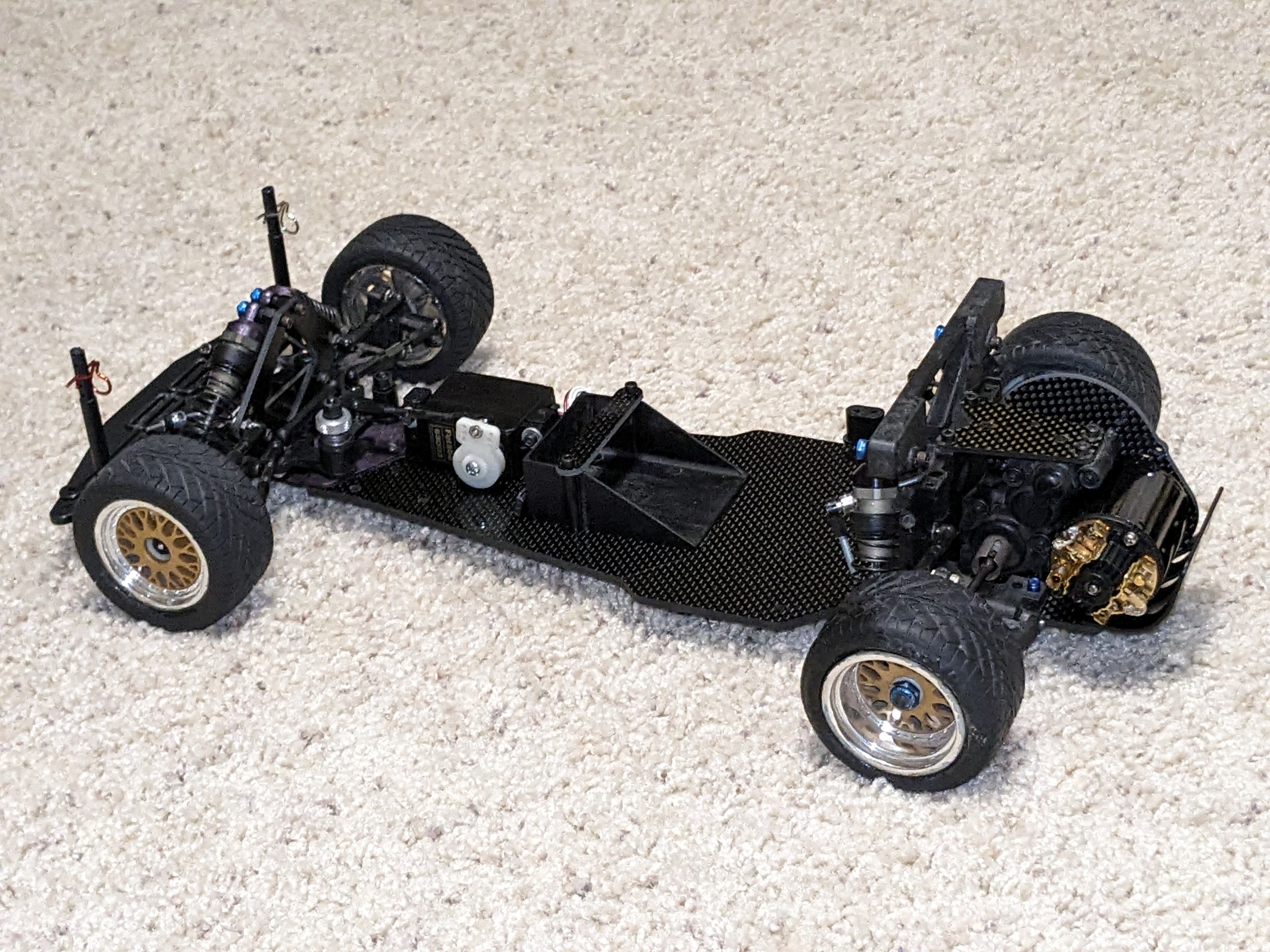

Got some SRT time this weekend.

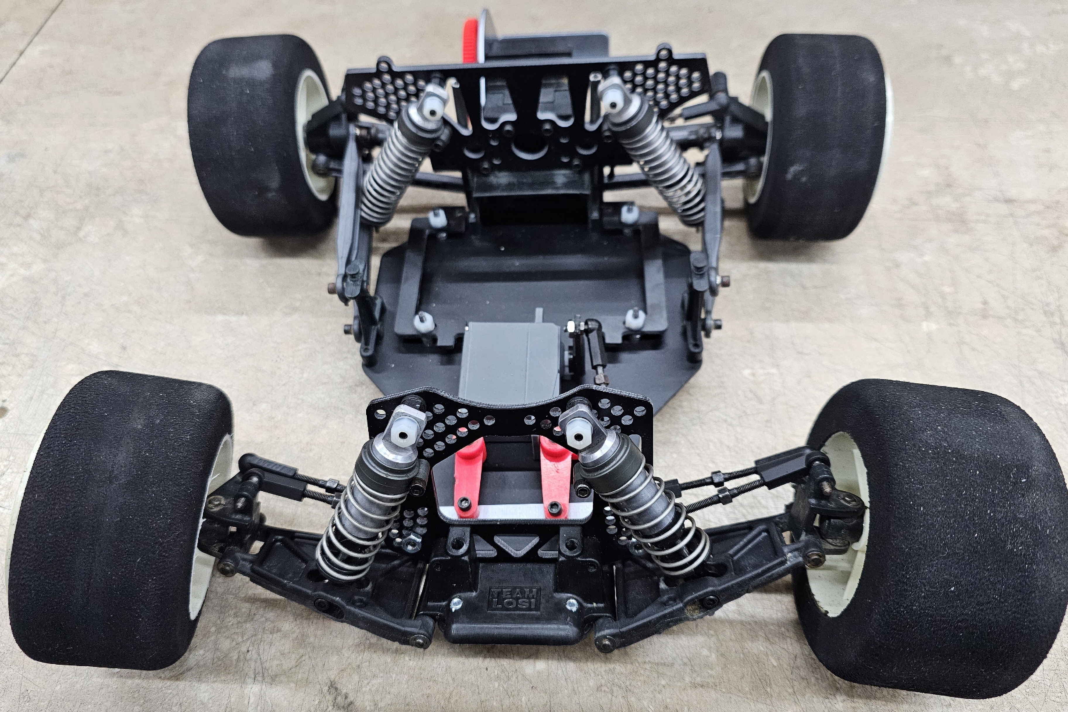

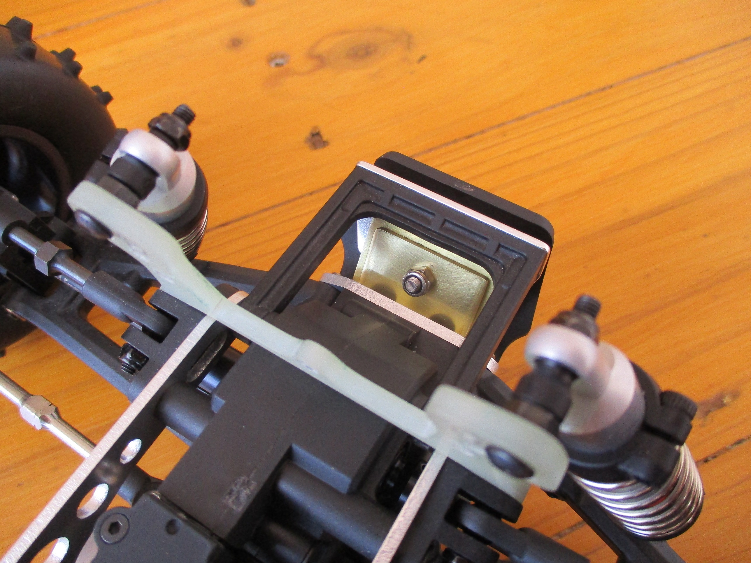

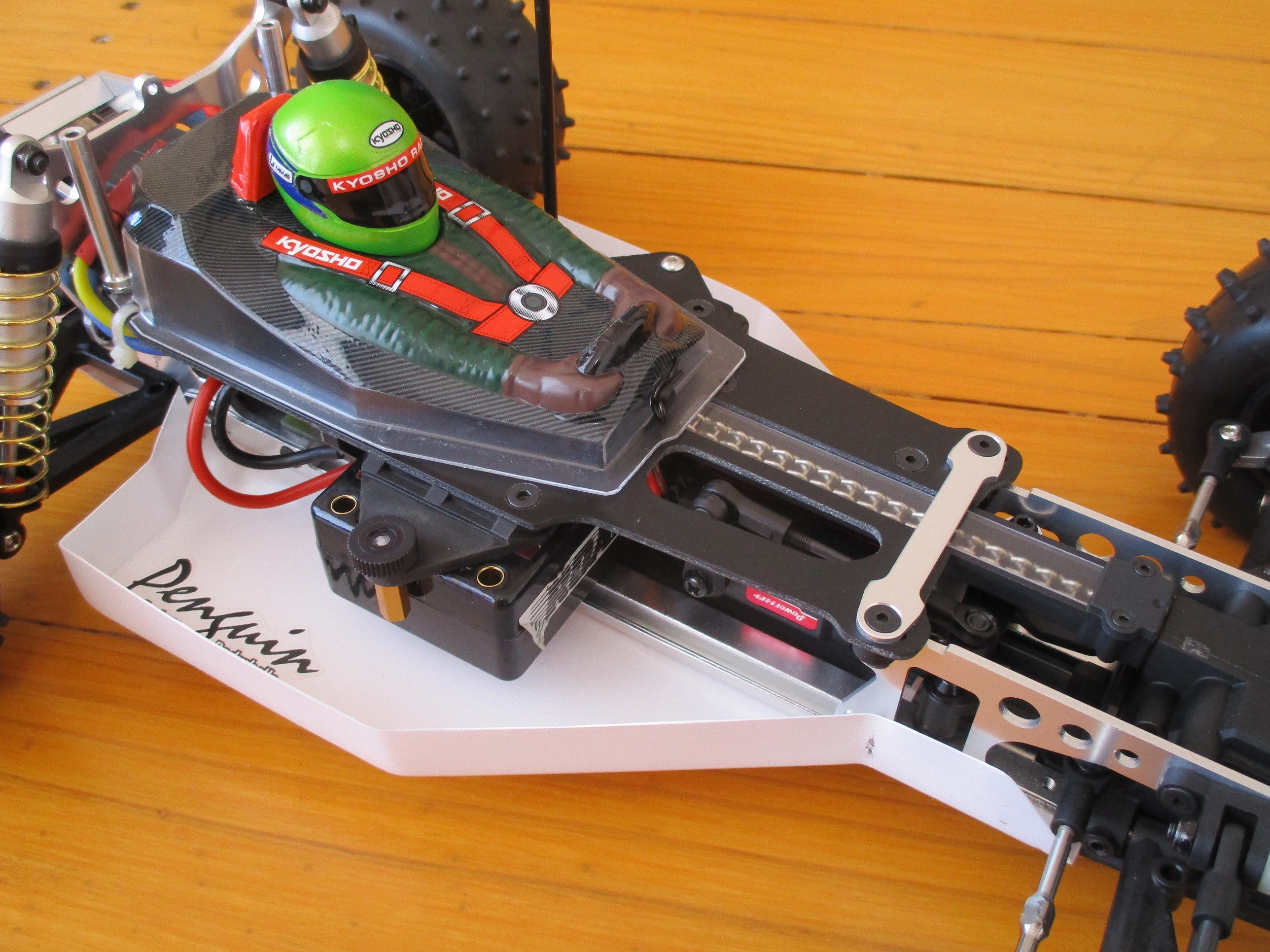

Modified the Optima's battery mounts to hold a shorty lipo properly. The Velcro straps weren't going to manage. To remove the battery just unscrew the thumbnut and remove the post and lipo.
Also made and fitted 12 grams of brass weight to the Optima's nose. It's easy to remove if needed.

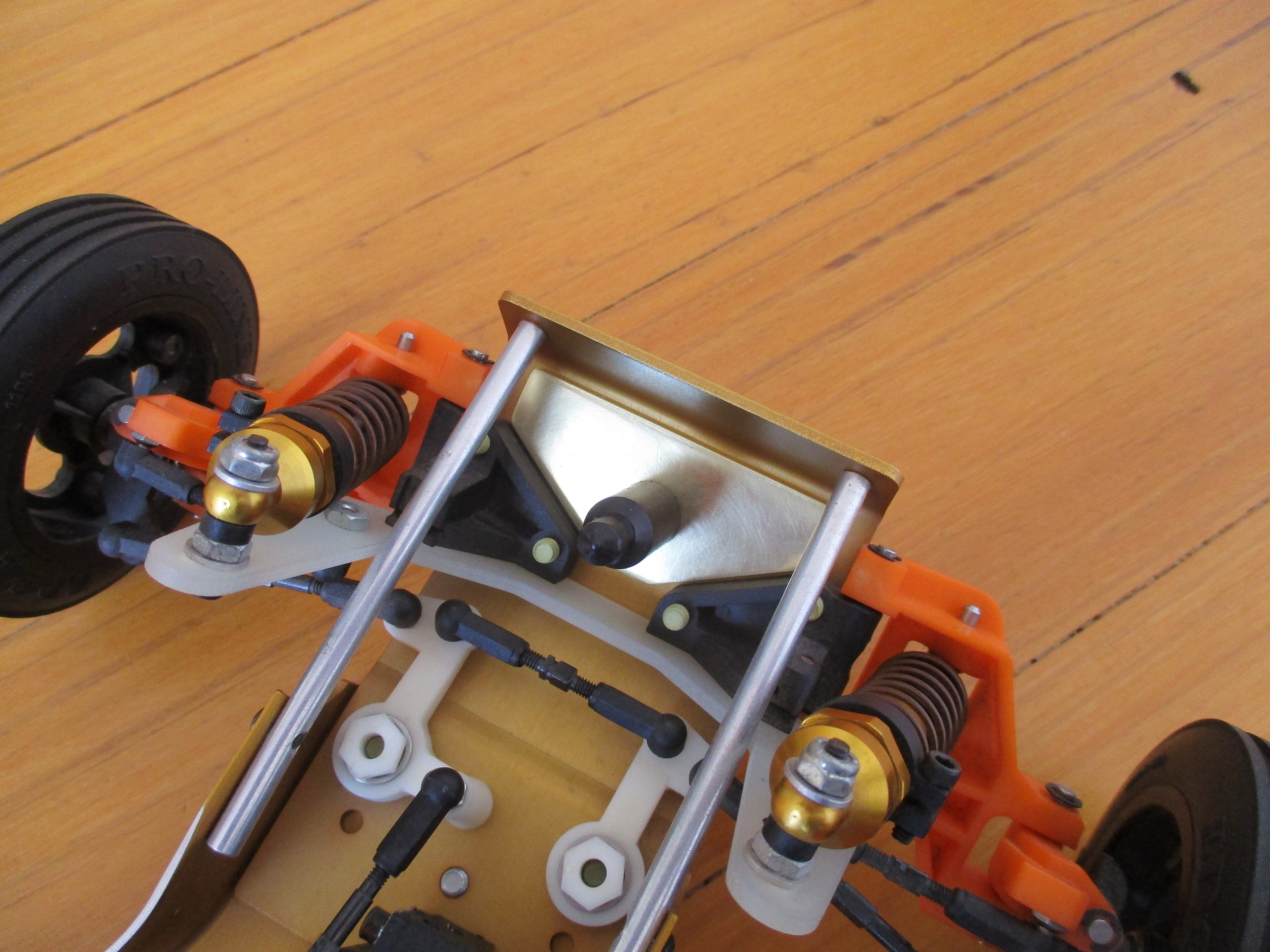

Whilst I had the brass out, I made a 14.5 gram nose weight for the Classic.

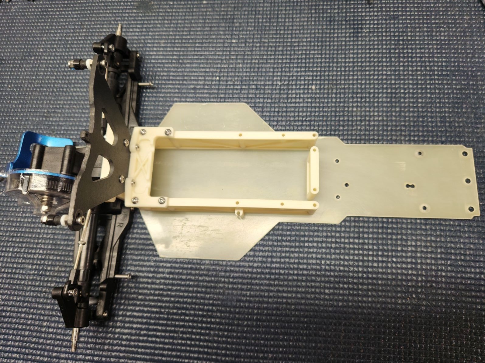

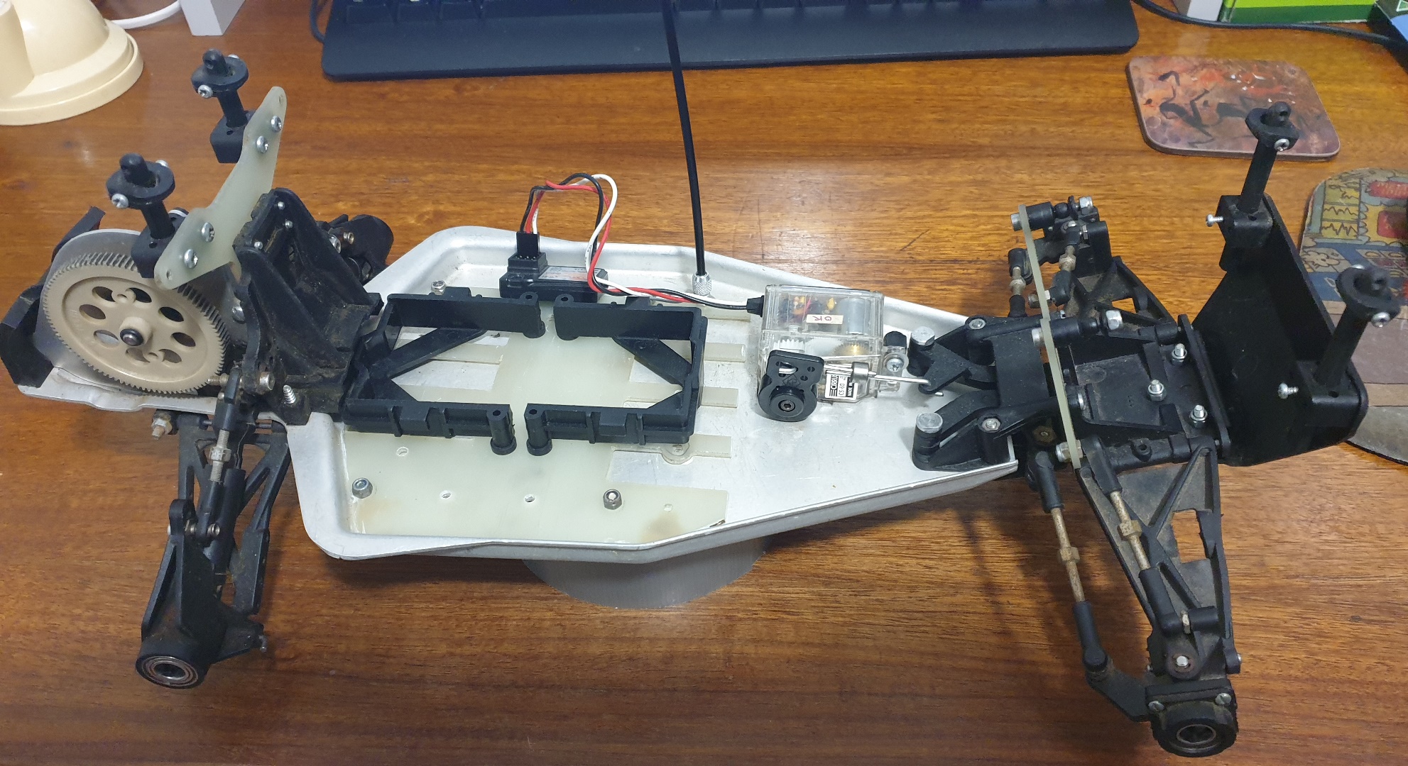

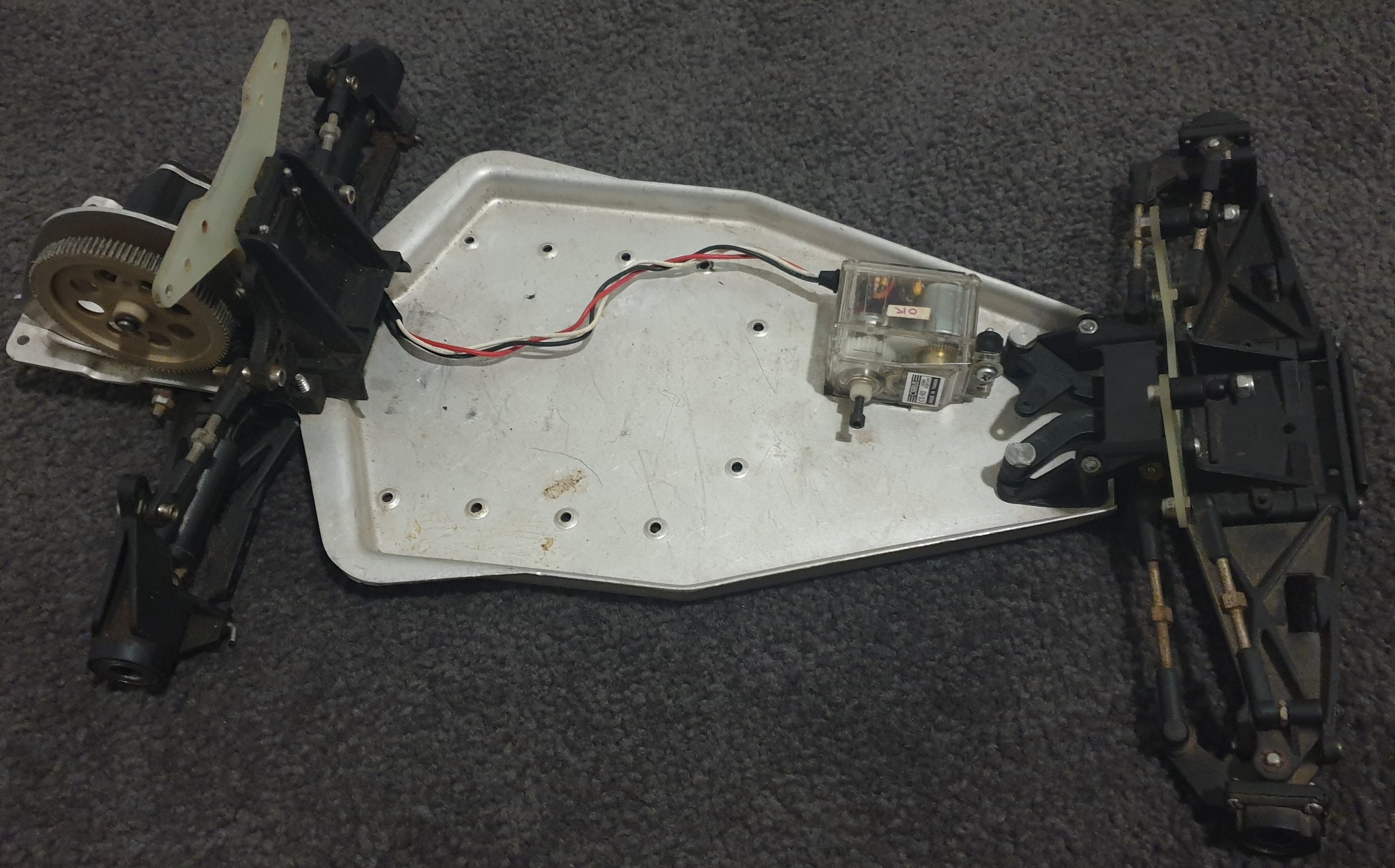

More work done on the Shotgun.... body fitted, radio gear sorted, and made my own LiPo tray out of a busted Cat XLS chassis plate. Have sorted electronics to use, and tested the receiver and servo. Still got to get back to the shocks, and then put it all together... but it's getting there!
This truck is almost as old and crusty as me!!! 8)
