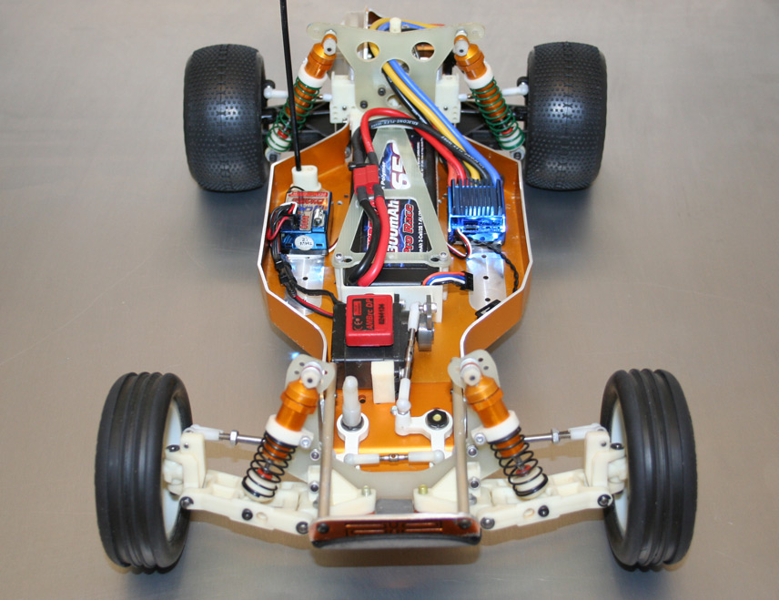

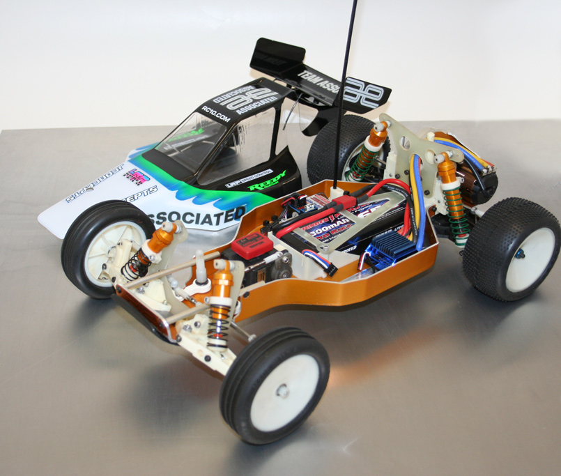

Since I painted up a new body shell for my RC10 gold-tub racer, I decided to strip the car down yesterday and took the anodized parts to work and did my 1980's-1990's treatment to the tub, nose and motorplate. Took me a few seconds to remember my old milling techniques, as I haven't milled anything in a long time.
It has taken many months now to get the 14-15 yr old rust off, fine tune the buggy and hands; but now I intend to get serious about the racing... but still have fun!
As soon as I put her together, I fell in love again!

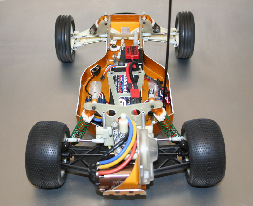

Yesterday I bought an LRP X-12 8.5T brushless motor to run today in my Gold Racer RC10 for the 1st time with a real mod motor and it was awesome! We had 3 other RC10Talk members there, and I also brought out my Boxter Replica, Jay Halsey Replica and Curtis Edinger RC10 to the track for people to enjoy as I have been asked a few times for them.
Long story short, the stock RC10 with an 8.5T motor and 5300mah 65C Lipo was a match made in heaven. The car felt like it was on rails! So much traction that I cleared the insane long distance doubles every lap of the qualifier and A Main today effortlessly, and drove thru the corner and onto the straight-away with so much power that the old gold RC10 was in a straight-away long wheelie on numerous laps that kept the spectators gasping, which could be easily heard on the driver's stand. It was amazing to drive from my standpoint and each time on the track, I have fine tuned the car in baby-steps to get it running strong.
Hopefully the other members can chime in with comments from their perspective.
From my perspective:
No need for aftermarket anything, no upgrades for an 8.5T brushless motor required, etc... Stock stealth transmission, stock slipper and pad, gold shocks, #1 pistons -35wt oil, etc... just your normal run of the mill RC10 Championship Edition style buggy.
