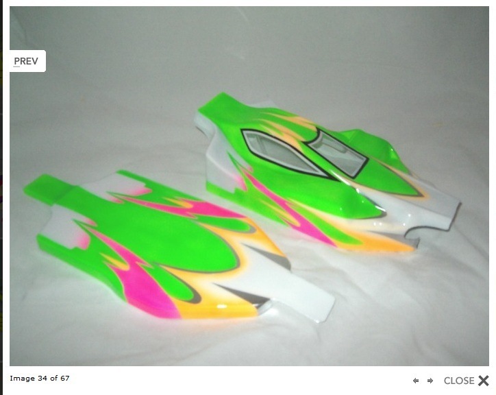

OK, i have to ask, what are you thinking on the bodyshell Alex? This begs for something very, very special lol.

Not sure yet, a take on a Masami shell for sure.
Perhaps I'll get Custom Blitz to paint the shell similar to my MR4 BX worlds shell I got done a few years ago, which was based on a Masami shell. Probably with a darker green and a bit more pink :D
