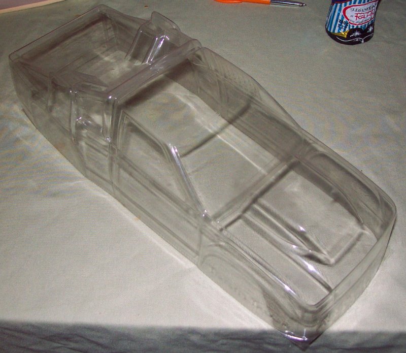

On the plus side, got this team truck body at the track today for $20($15usd). Was offered to me because i'm the only guy running a RC10T. So some good things come out of racing vintage cars all the time, if people find vintage stuff you're the first to know about it!

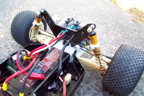

Here is my first RC10T runner in the making. I'm going to be putting sand paddle tires on it and using it on the beach a lot, probably get a waterproof traxxas servo and receiver box and possible a mamba max 5700 combo powered by maxamps lipo. It's a graphite chassis that will have a custom top deck for support. It's cut down in the front to allow for the 10T front. And I found a use for my A&L front shock tower that I have to order rear shock for, because the front one are too short. I might add T4 axles down the road too. This one needs it's own thread possibly.

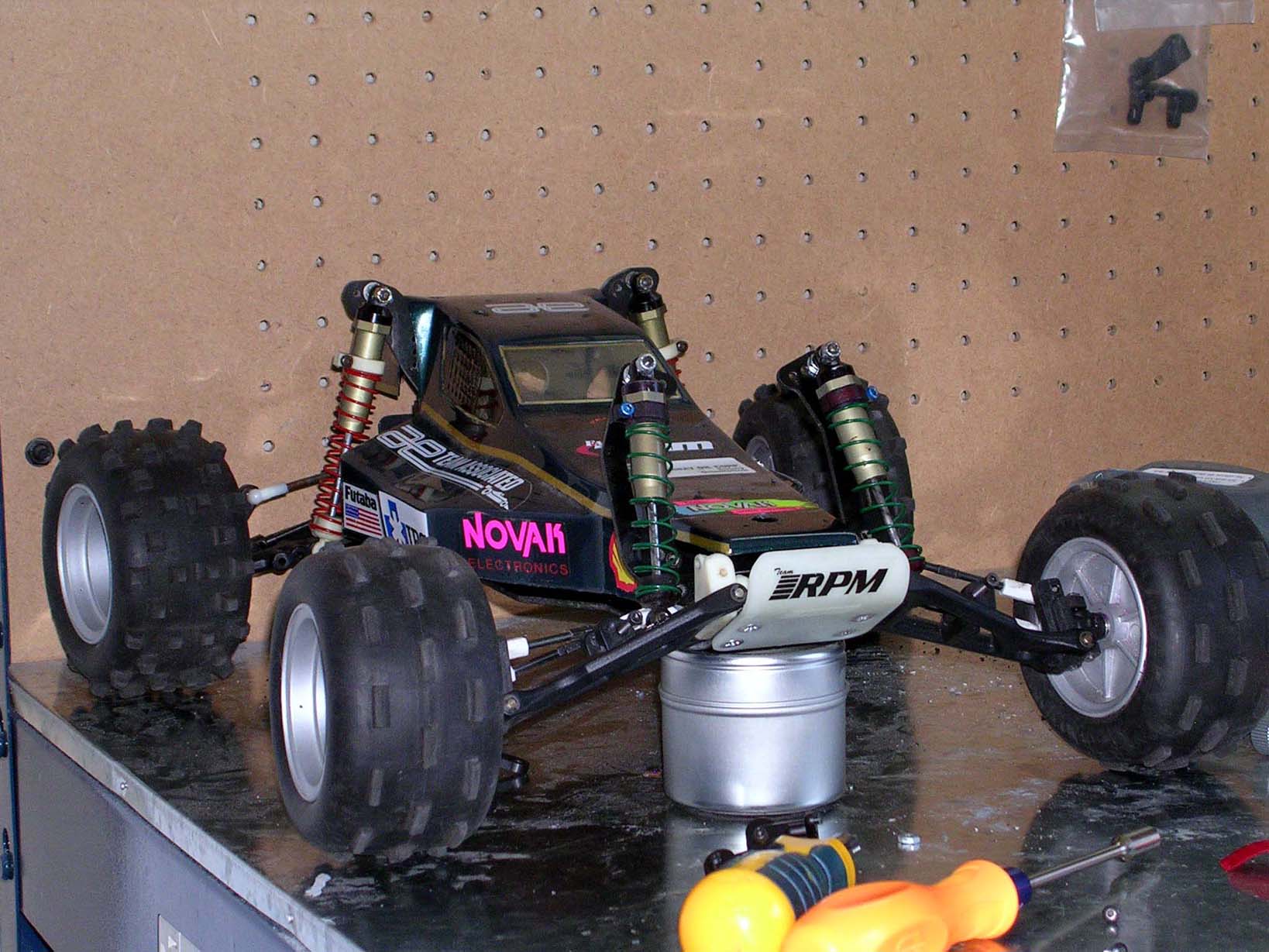

Re: RC10T runner(s)

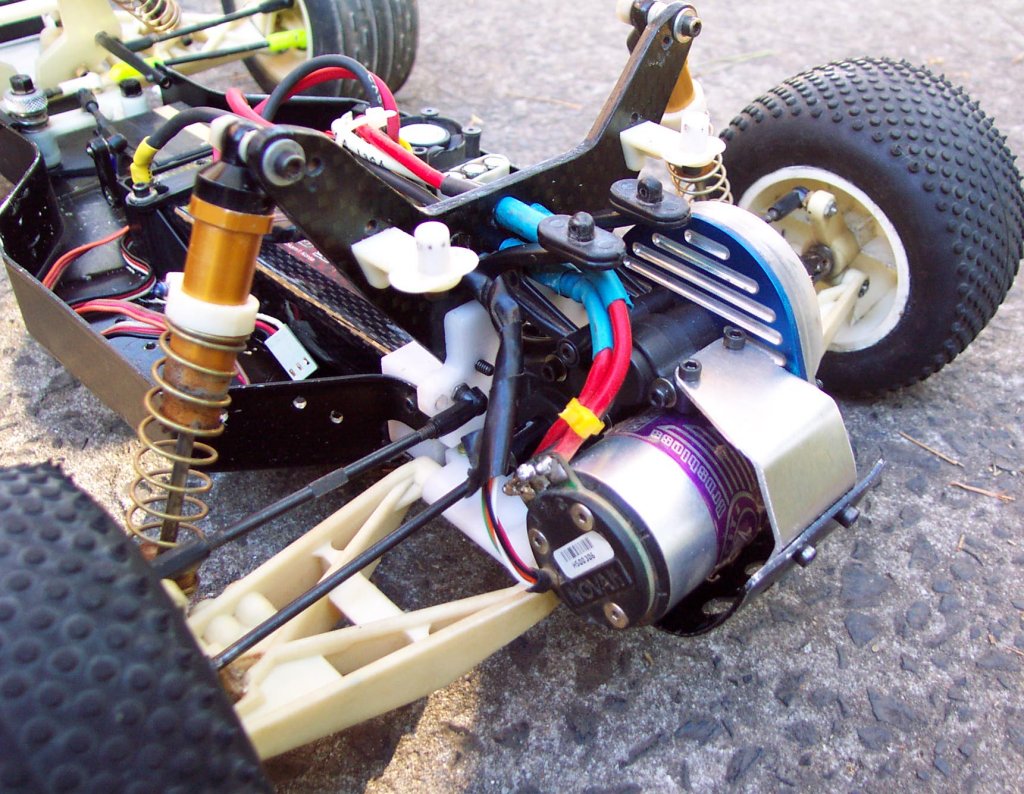

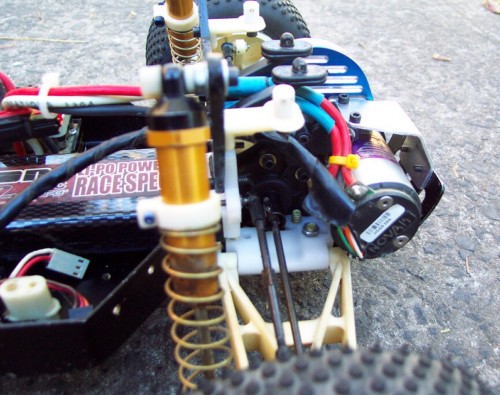

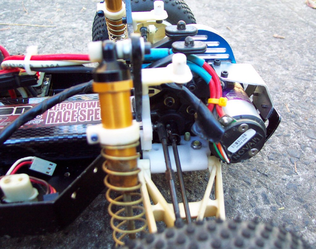

Got sick of busting idler gears in the standard gearbox with the crazy brushless motors i'm running so I made a T4 gearbox fit. Machined a delrin bulkhead and bit which attaches to the gearbox then to the 6 gear holes in the chassis. Then made a carbon fibre rear tower without the big hole so that the T4 trans brace/body mounts would have somewhere to attach. I'll probably bend up a 1 piece motor plate/chassis brace. Made the bits for a buggy project but figured this one needed it more. Also made some delrin rear arm mounts with rounded corners where they usually tear. Broke one today in a traction rollover, but instead of snapping through to a screw hole it ripped apart right down the hinge pin hole.
Had to put an RPM front bar on to stop it losing the front e-clips every race..

Re: RC10T runner(s)
Too cool upgrade mr. bugle!
It's hard to see the new parts though; did you make pictures before you mounted them?
I don't know hiow I missed this thread; 2 thumbs up for all the race action pics!
