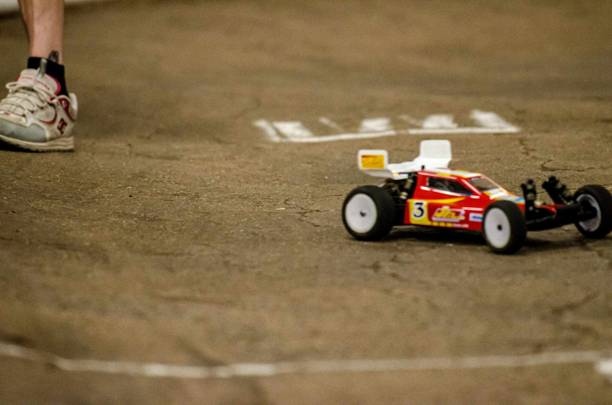

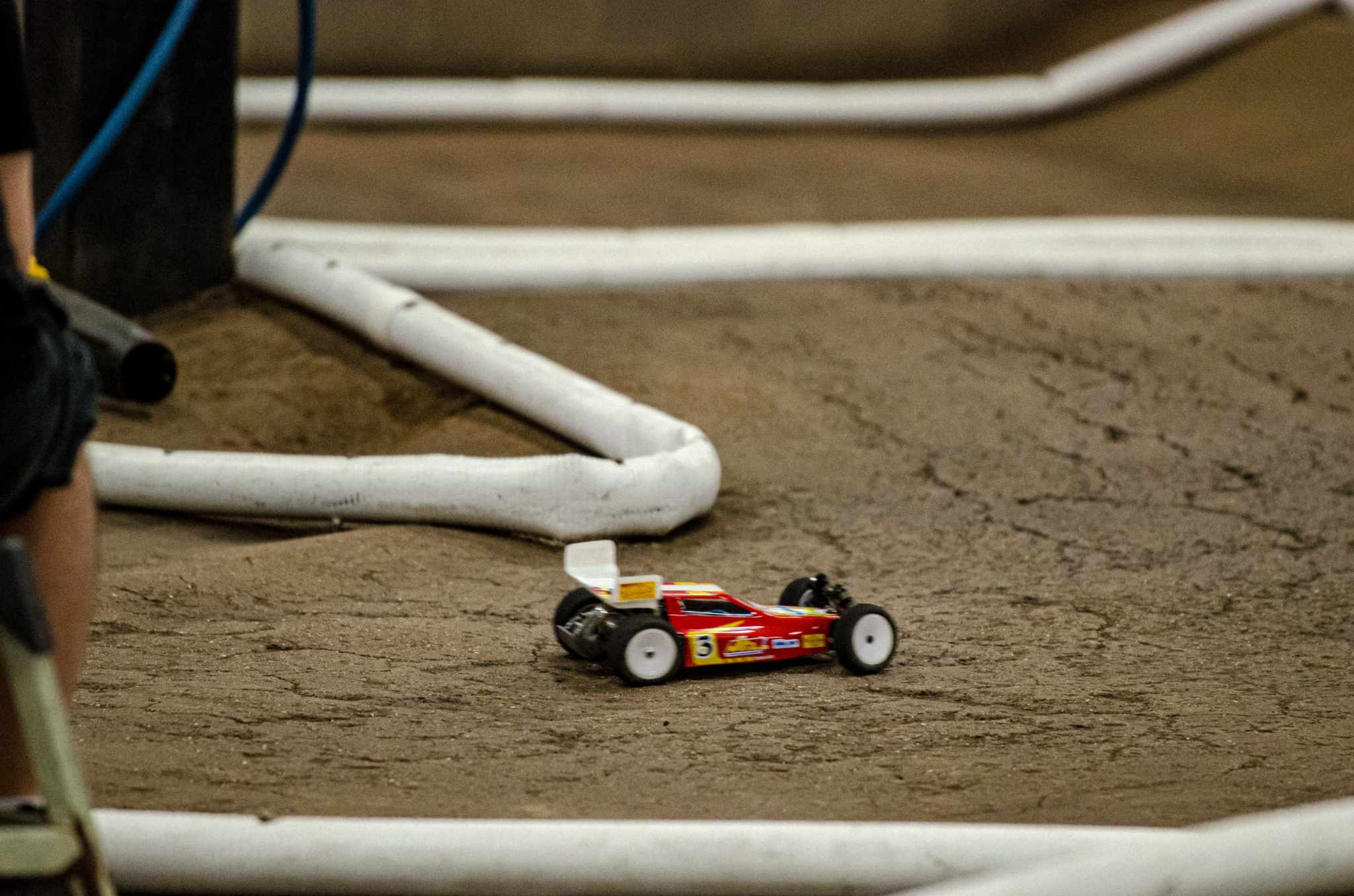

Re: My JRX2 restore/race build
Post by ChocoTaco73 »
A few action pins :twisted:
James - Losi fanatic :lol:
Lavigna
Posts: 1462
Location: Petaluma, CA
Has thanked: 1099 times
Been thanked: 1418 times
Post by Lavigna »
Not many folks racing with 5 link setups. I applaud you for doing it. Great thread you have put together. I really like the look of the 5 link set up for modern racing.
Great action shots!
