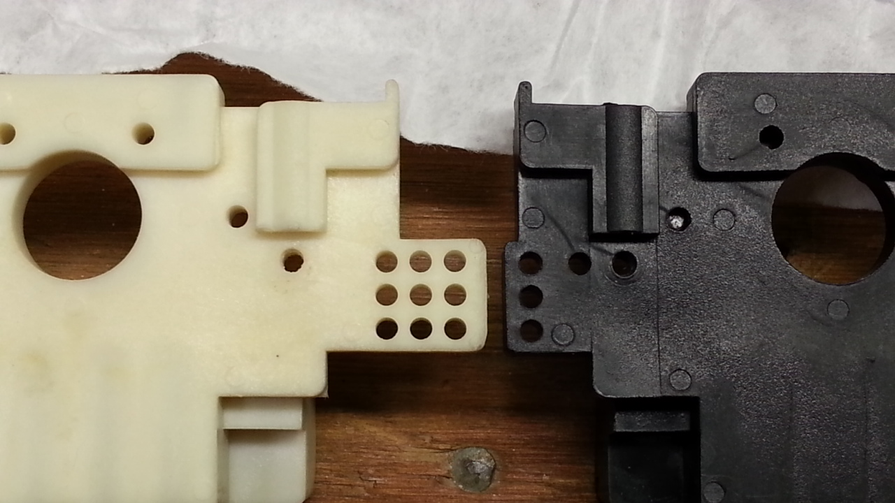

Rear bulkhead lacks the proper worlds holes, and they want the head of the diff bolt on the spur side, that's backwards from the norm

What addtional worlds holes are you referring to? There is already an additional hole inside apart from the array of 9.gomachv wrote:Rear bulkhead lacks the proper worlds holes, and they want the head of the diff bolt on the spur side, that's backwards from the norm

A 2nd series bulkhead on left (same as rere), original worlds style on right. Outer 6 holes were removed, but one was added in the middle.Patiofurnituregt wrote:What addtional worlds holes are you referring to? There is already an additional hole inside apart from the array of 9..

As far as the extra hole shown above, in the original worlds kit that was the hole that they wanted you to start with

They were on my white Team car bulkhead and black CE bulkhead as wellgomachv wrote:
