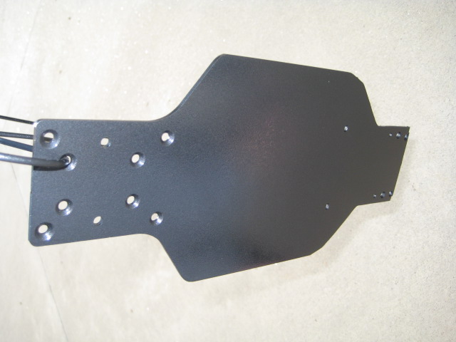

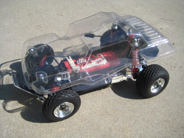

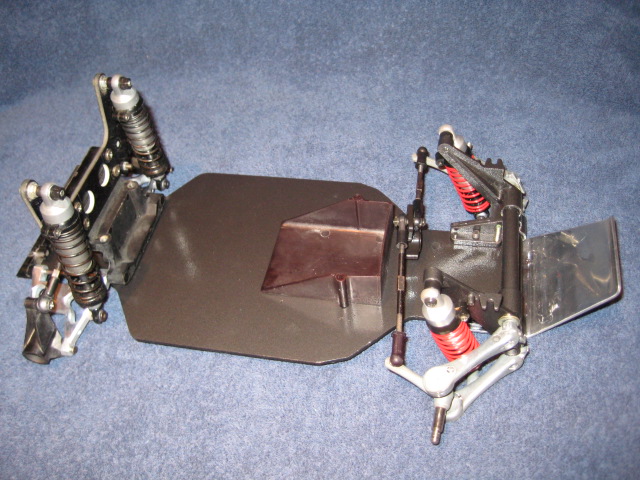

At last!
Chassis has been painted.

That looks great! What paint did you use?Diggley wrote:At last!

fastang wrote:That looks great! What paint did you use?Diggley wrote:At last!

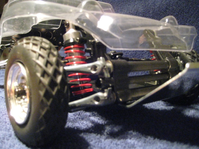

Thanks.
Rust-Oleum Universal Advanced Formula "Hammered" All-Surface Paint.
This stuff is great, it leaves a slight textured surface, & isn't too glossy.

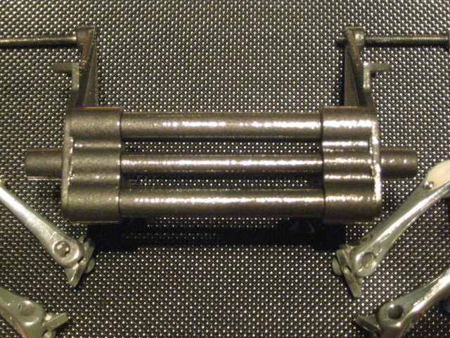

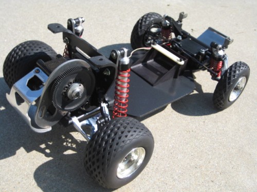

Just finished doing a little front end work too....polishing the arms was a pain..

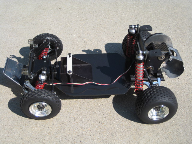

Re: I have an idea...

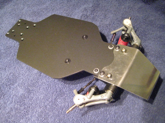

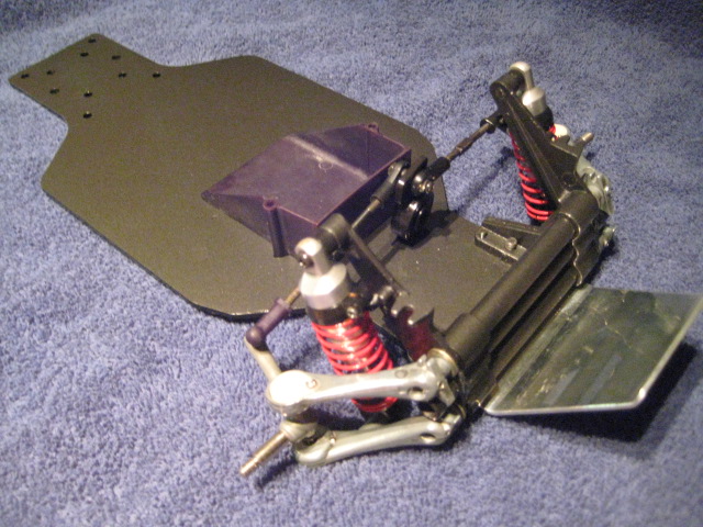

Progress!!!

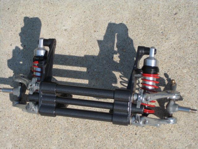

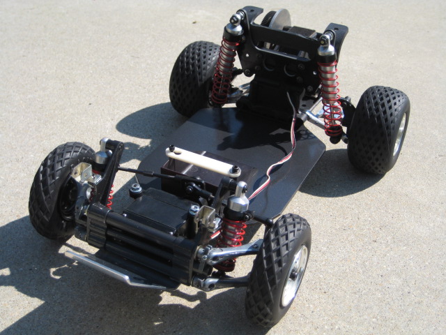

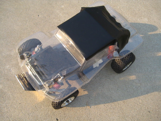

More progress...

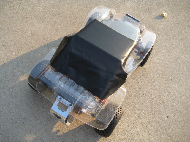

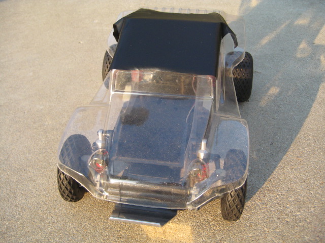

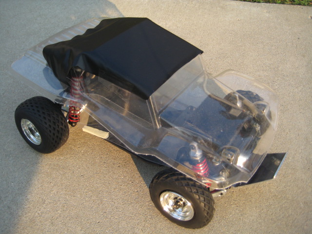

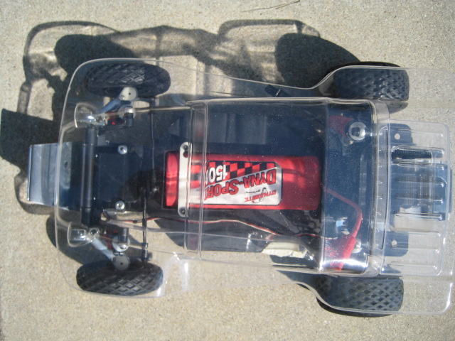

Vinyl top is getting trimmed & fitted.
Just a little more work, & I should have the look I'm looking for...

Awesome project and some fantastic fabrication going on--I love it.
Question about those blue control arms & faded Kyosho Gold shocks...did you use Easy-Off to remove the anodizing? If yes, that's a cool tip I'll have to remember!

Coelacanth wrote:Awesome project and some fantastic fabrication going on--I love it.
Yep,
Easy-Off Heavy Duty.
Washes off the anodizing like it's water color....just don't leave it on too long.

Awesome, I never knew! Now, after the anodizing is removed, how would you prep the aluminum for a subsequent anodizing with a different color, for example? Have you ever done that?Diggley wrote:Coelacanth wrote:Awesome project and some fantastic fabrication going on--I love it.
Yep,

Awesome, I never knew! Now, after the anodizing is removed, how would you prep the aluminum for a subsequent anodizing with a different color, for example? Have you ever done that?[/quote]
I've never anodized anything yet, I always wind up polishing aluminum parts.
I soak the parts in a plastic bag until the coating washes off, the parts are then washed in dish detergent, rinsed, then they may be carefully sanded (if needed) to remove any blemishes. Mothers Mag & Aluminum polish is used next to get a nice shine.
I would bet that once the old color & scratches are removed from the aluminum, it would be ready to add color.

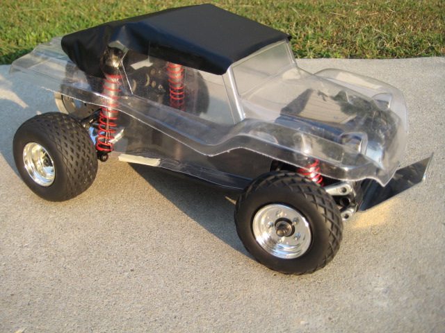

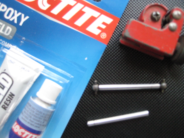

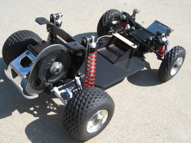

Well,
After searching everywhere, I gave up on finding the proper length dog bones...
This one won't get run much anyway, so I think the shiny aluminum axles will add to the bling factor.. I'm not worried about breakage.
