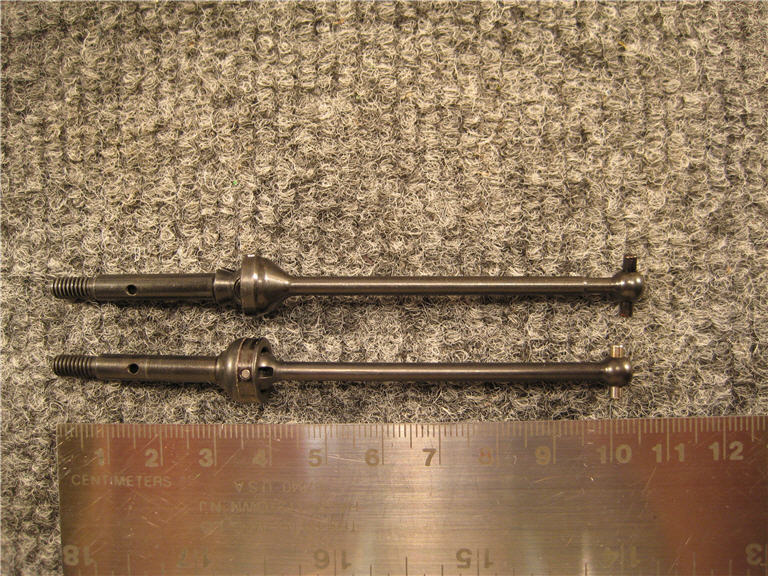

Doug, any chance you can measure the CVA shaft, and the CVA stub? Maybe there is a difference in the CVD/CVA stub axle?

I'm just thinking that there must be a part difference somewhere, if you do not machine that hub and use a B4 CVD then you bottom out into the drive cups with 3/8" left before the chassis touches the ground :?:

the axle length of a b4 axle compared to a b44 is the same. the b44 is shorter from the bearing flange on the end of the axle to the end of the bone compared to a b4.

old pic from paul...

Thanks Jason, that does clear up things a bit :wink:

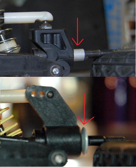

I think this is where the difference is...
Eau Rouge wrote: Thanks. The rear track is very close to an original RC10, when you include the B4 wheel/offset.
  • Stock RC10: 7.375" rear track width (9.000" with jellybean wheels/tires installed)
    Modified RC10 with B4/B44 outer drivetrain: 8.000" rear track width (9.250" with B4 wheels/tires installed)
    Stock B4: 8.313" rear track width (9.750" with b4 wheels/tires installed)
I measured mine at 9.5" with Losi XXX wheels installed.
--Joey --

Isn't that because the inside of your hubs have been relieved for clearance, though? That allows more axle to move through the hub, no? An extra .125" on each side makes your rear track .250" wider.
That's a .125" spacer on mine—stock B4 part.

Yes, that is the point I was trying to illustrate, the machined hubs versus the stock hubs.
Earlier I had said I would measure it up, knowing you had already done the stock '10, B4 hubbed '10 & stock B4 measurements.
Just getting the information out there for everyone.
