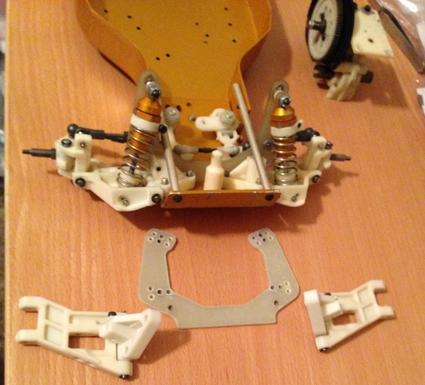

The front end and wide A arms: I am a little curious about the front shocks...do I need longer ones than the stock units?

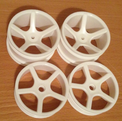

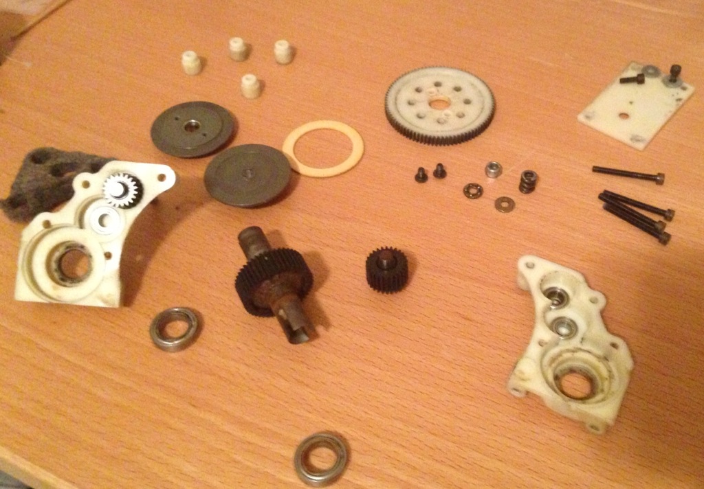

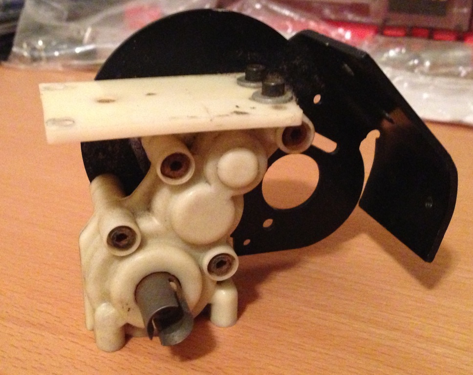

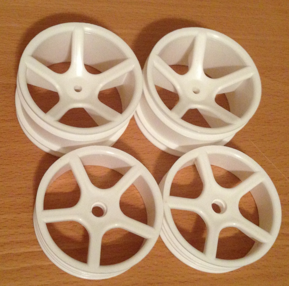

New Stealth trans: Stealth disassembled: JC Racing wheels: I also have MIP CVDs on order along with some miscellaneous screws/clips/etc.

Hello, a A stamp chassis is not the best option for a stealth runner, you will have to drill it. The RC10 with short arms had .56 stroke shocks, the wide arms version had .71.

I am working in disassembling everything to clean, but it's been quite a while since I worked in one of these...does anyone have a suggestion on removing the roll pin from the top shaft in the Stealth? Thanks.
- Posts: 12335
- Has thanked: 1129 times
- Been thanked: 3917 times
Re: A Stamp Goldie rebuild
I grab them GENTLY with a pair of small side cutters. Works great but don't snip!

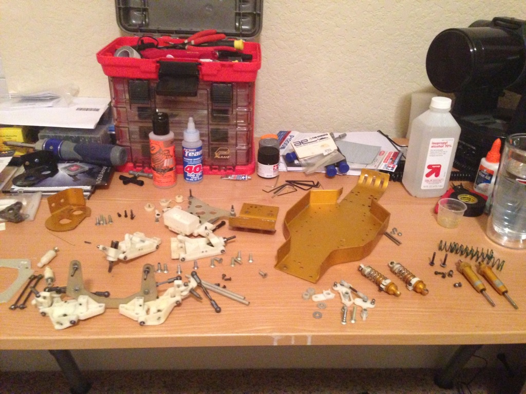

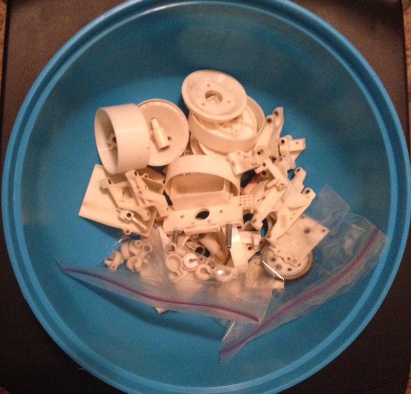

Finally got everything disassembled so I could clean the nylon parts:
I now have a bin of nylon parts ready for a soak in simple green and a scrub with a toothbrush: Progress is slow for sure, but I'm getting closer to reassembly, so I'm pretty happy about that.

Noticed that the shock ends on the rear shocks had a crack on them:
Are replacements even available? Is the 'bay my friend here? I suppose I could wait until the re-re parts come out. I now have a bin of nylon parts ready for a soak in simple green and a scrub with a toothbrush: Progress is slow for sure, but I'm getting closer to reassembly, so I'm pretty happy about that.

The shock ends on the re-re look different. Ugly even. Yes, eBay is your friend. Easy to find with used shocks, not too hard to find new in bag but expensive.
