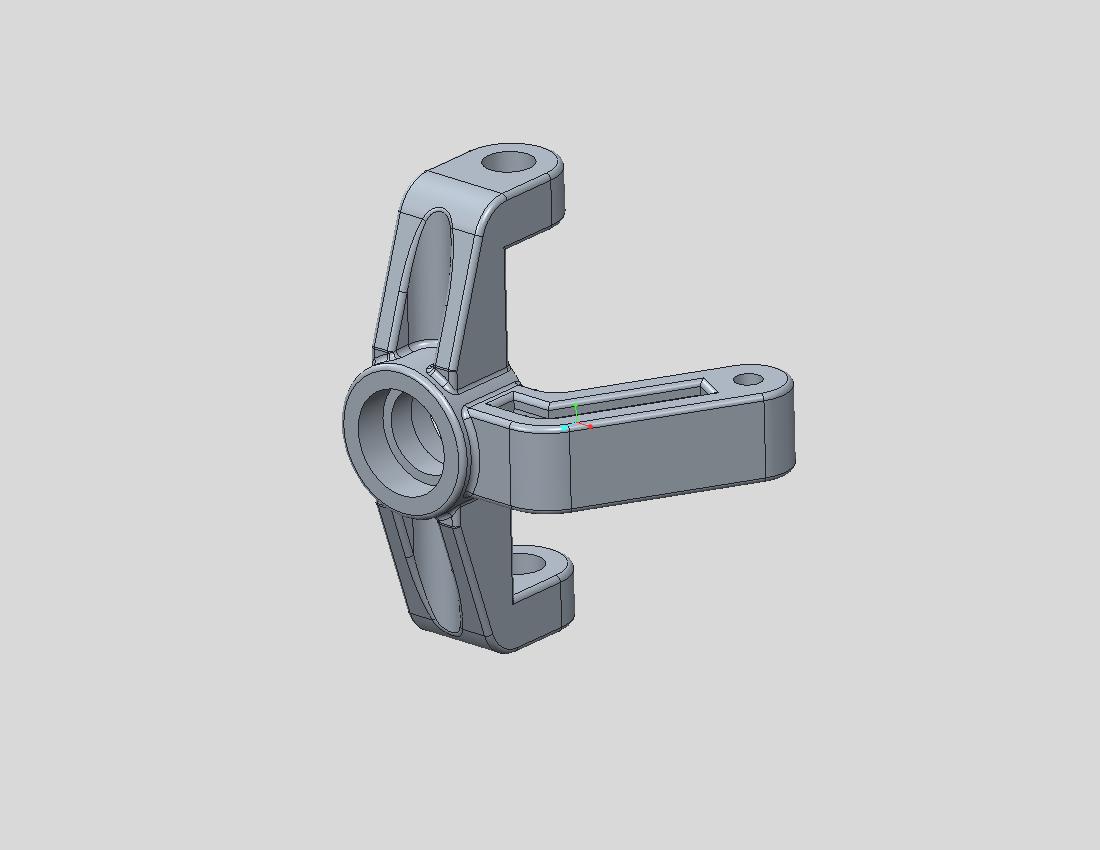

New steering blocks. These are the same left/right, so keeping spares will be much easier.
I'm hoping that maybe we can finish this thing up around the end of May and start offering the components for sale then. We'll see

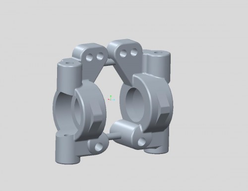

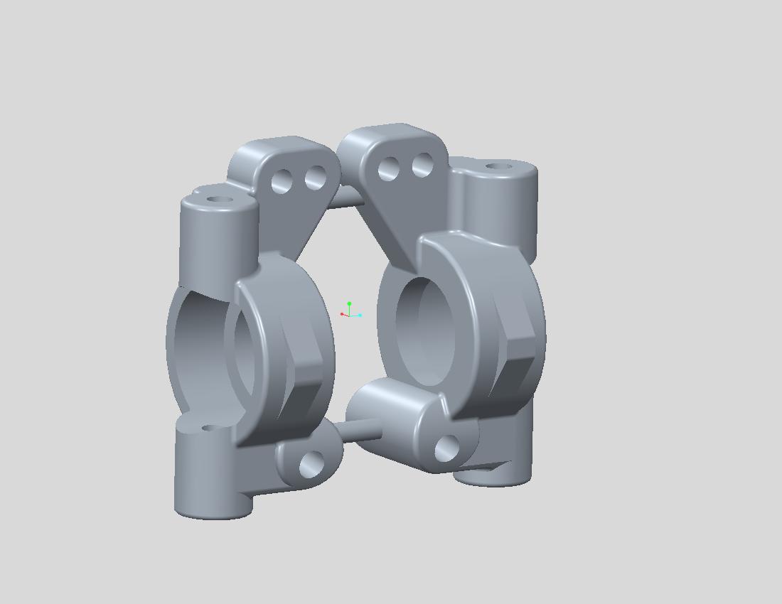

Updated caster blocks. We had to raise the camber ball stud location about 3/32 to solve a clearance issue on the tower side of the camber links. The stud will move up the same amount on the tower, so the geometry will stay the same.
Jeff has sent me the car, I'm supposed to get it tomorrow. I will begin figuring out front transmission mounting, the rear bulkhead with integrated belt guide mounting, and the front belt tensioner.I'm hoping that maybe we can finish this thing up around the end of May and start offering the components for sale then. We'll see
