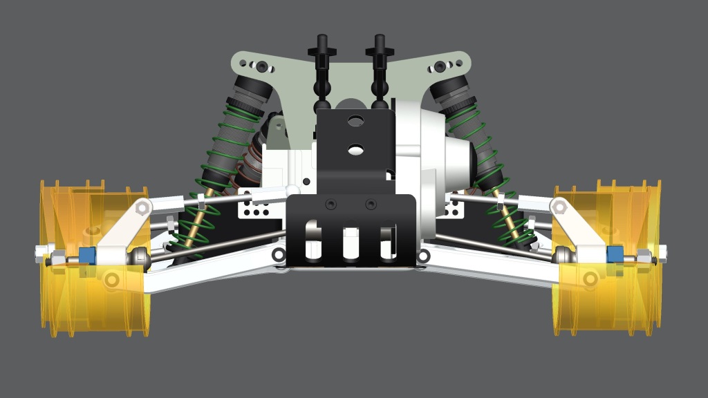

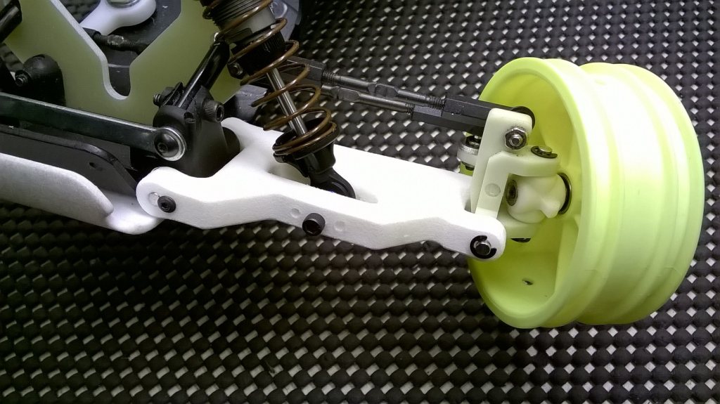

CVA bone clearance improved with V2 arm. To get same amount of droop V2 side needs 2.8mm less limiters inside shock.

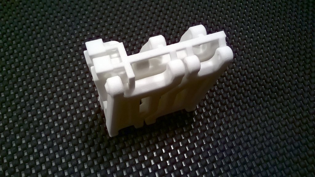

Joey, I could offer a V2 "kit" on Shapeways but there are no price advantage. Price is same as "V2 rear arms" + "V2 front arms" + "V2 arm mounts". And polishing process doesn't work well with big kits. Therefore I'm going to offer kit only on Imaterialise. It might take some time because I need to make the tight packed sprue design first and order it for myself. After that I can offer it to you through Imateriase site. That's how Imaterialise process goes.

Thank you!Niki wrote:V2 parts ready. New arms are much stronger around hinge pin areas and rear arm has a new bent shape.
Also eagerly awaiting the V2 on I.materialize.

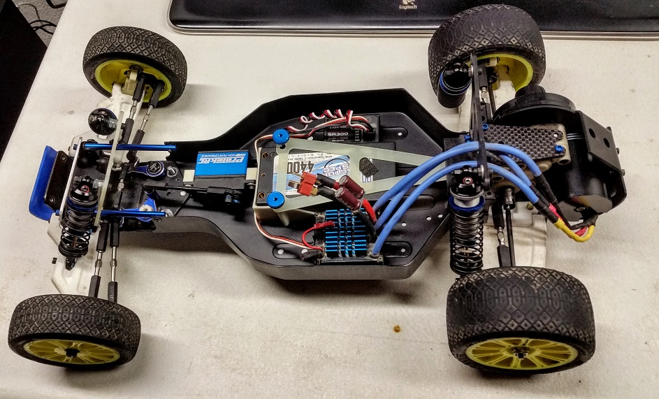

Here is how I am now running the Re-Re worlds quadra-symmetric car with the shorty pack forward. Yes it has a broken aluminum *sigh* screw. New motor and ESC arrive next week. The track is prime for slicks right now and I don't want to buy slicks for this car at the moment... Last week I was thrilled to run a personal-best of 20.3 in my B5M. I'm usually a mid-pack guy but I am always trying to improve. Top guys were doing mid 19's... Then Dakota Phend was racing one night a couple weeks back he ran consistent mid-18's on the same layout... really makes you see the difference...

I.materialise will ship first V2 set for me next week.
- Niki
- Posts: 524
- Location: Finland
- Has thanked: 3 times
- Been thanked: 45 times
Re: Quadra-symmetric RC10

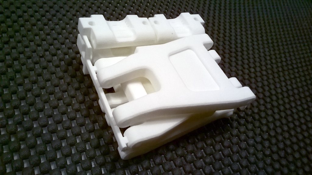

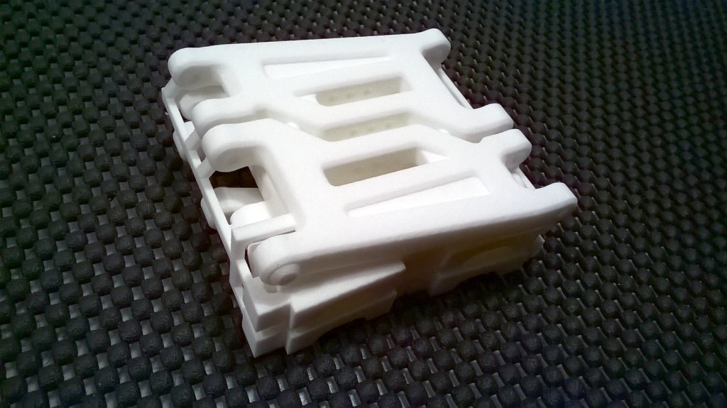

Quadra V2 front arms, V2 rear arms, V2 arm mounts 3-1 and 3-2 tightly packed... I.materialise made again high quality parts.

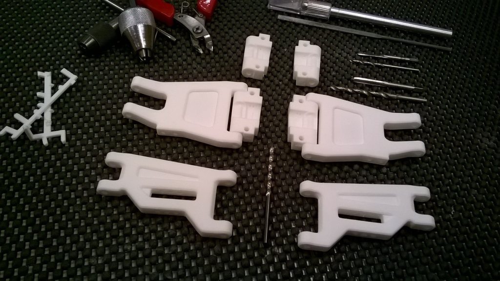

Jared, drilling what holes? You mean reaming out the hinge pin holes
1/8" reamer and be smooth about it. No drilling needed.

Thanks guys... Jared, just let the part quide tool in your hand, it will be perfect
These are the tools I use:
Good quality 3.2mm drill bit (I use it only for this purpose)
4-40 tap and drill set
8-32 tap and drill set
...and then the usual stuff.

If anything the drill bit aligns the hinge pin holes better.
The captured hinge pin arms are a little trickier as you have to feel for when your at the end, taking care not to drill all the way through. A piece of tape wrapped around the bit as a depth guide makes it easy if your unsure.
