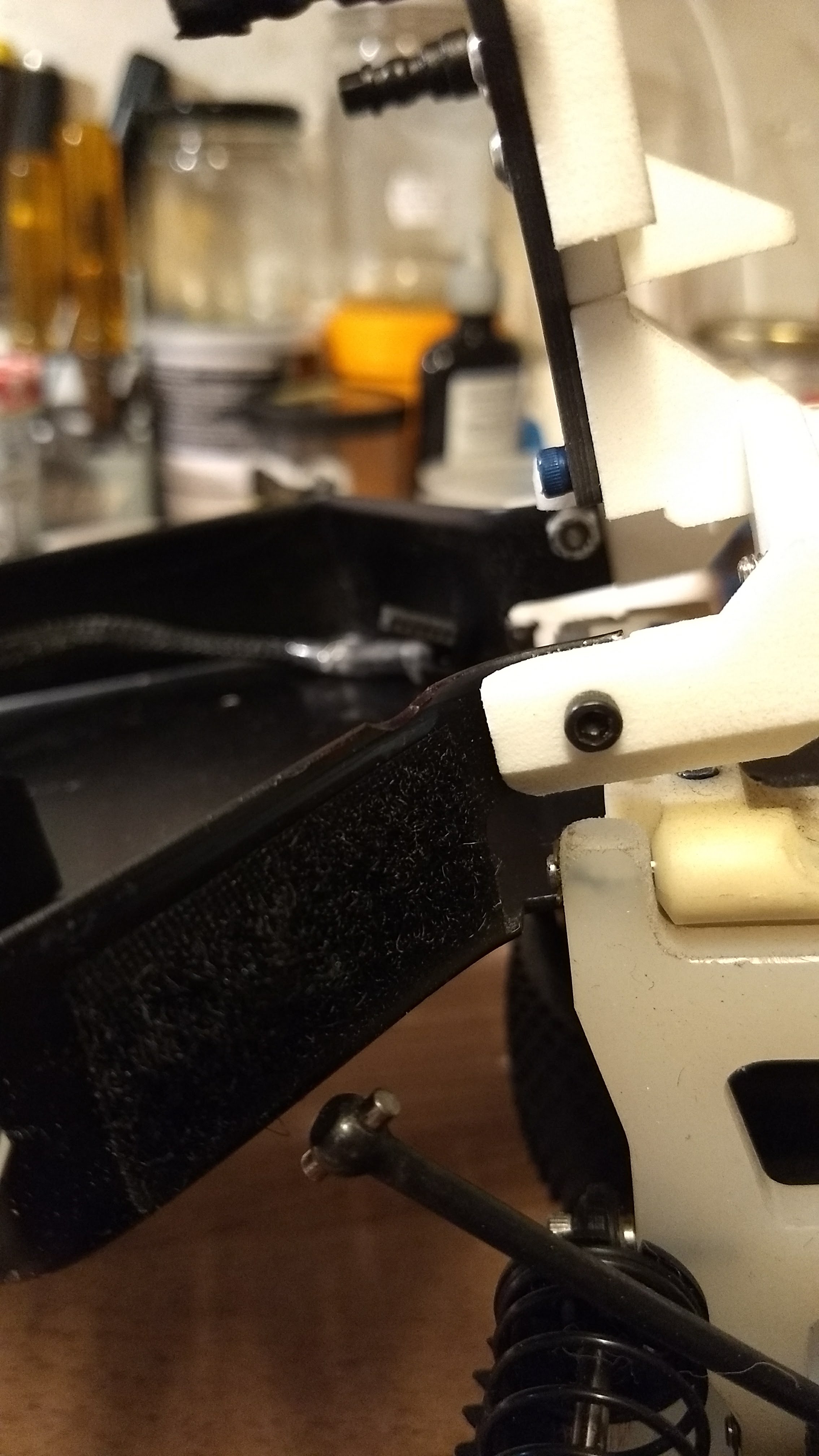

A bit of short on time here, but trying to move on, still...
For the car's last race in a couple of weeks (will be a B6.1 this fall instead! Enough of this retromod-running BS
), I want to fix a few things to finish in style, including that darn steering which I still think is disfunctional.

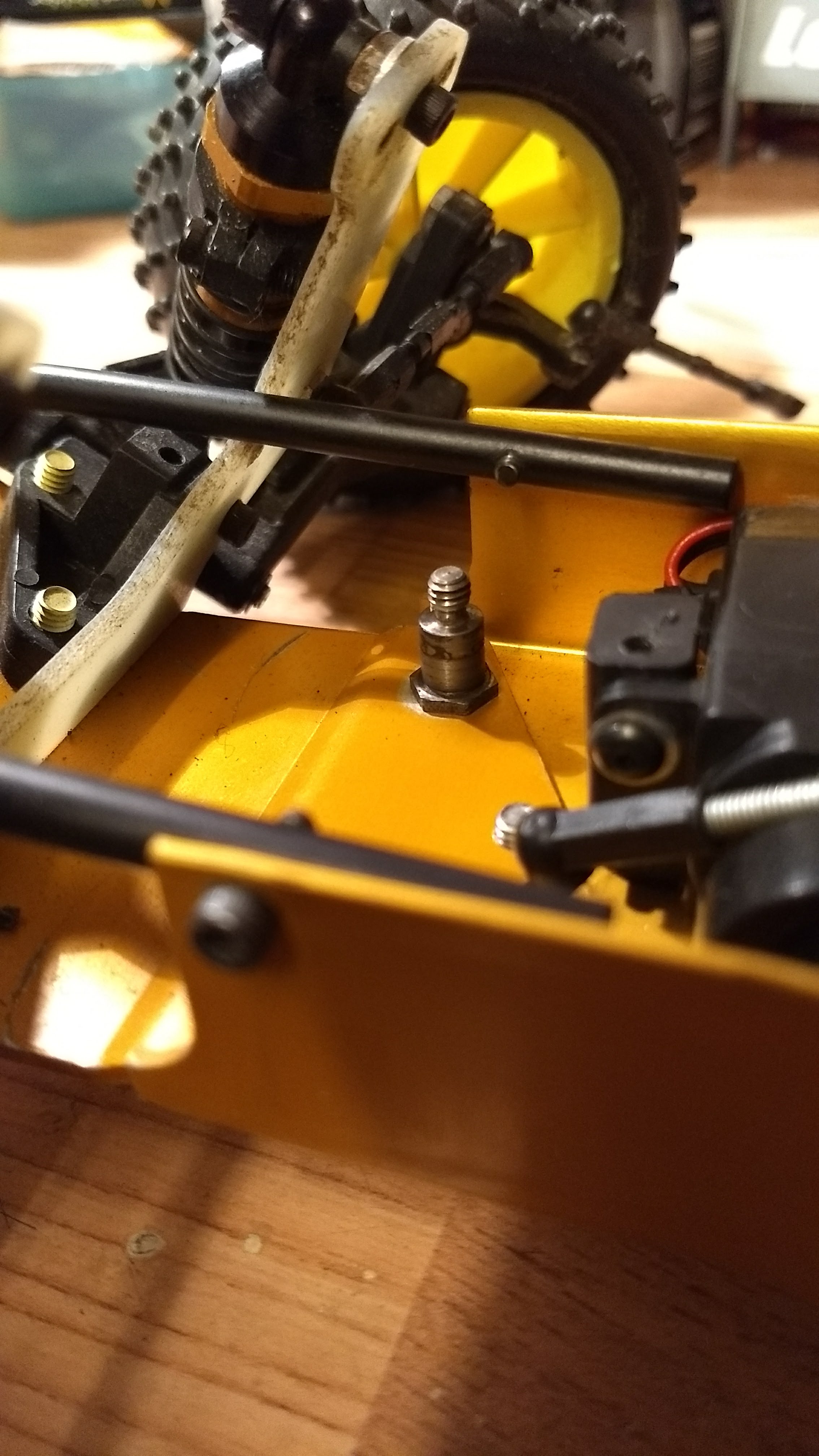

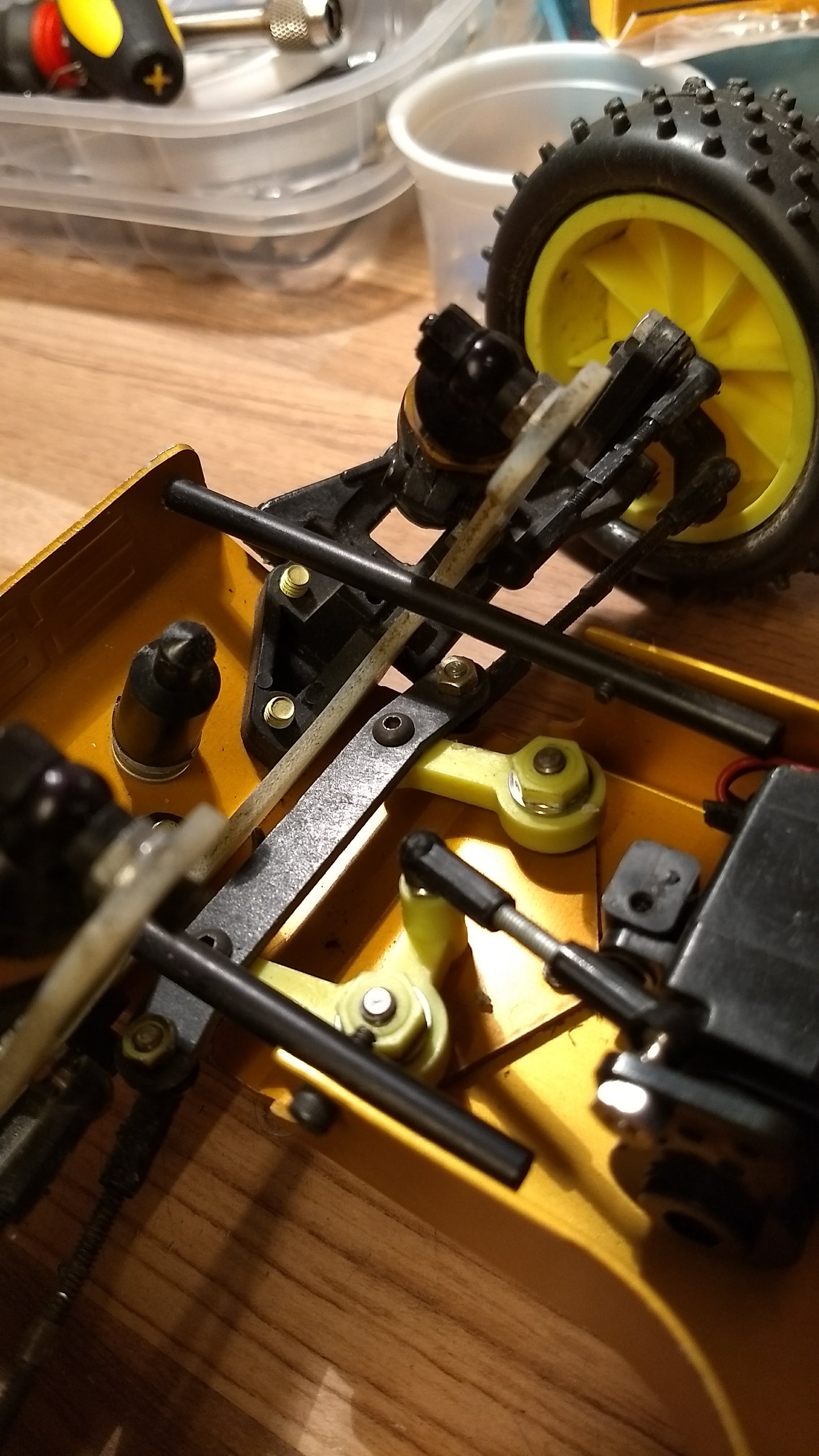

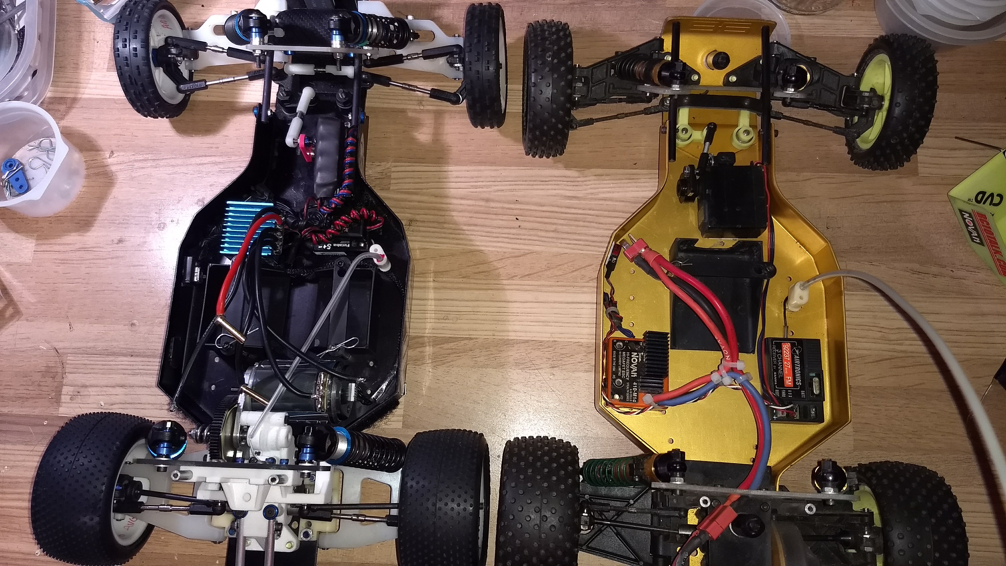

So, time to pull out the runner CE Stealth and pillage some more parts (for a good cause):
This car sports a proper, vintage, pre-Jeff A&L steering from the glory days!

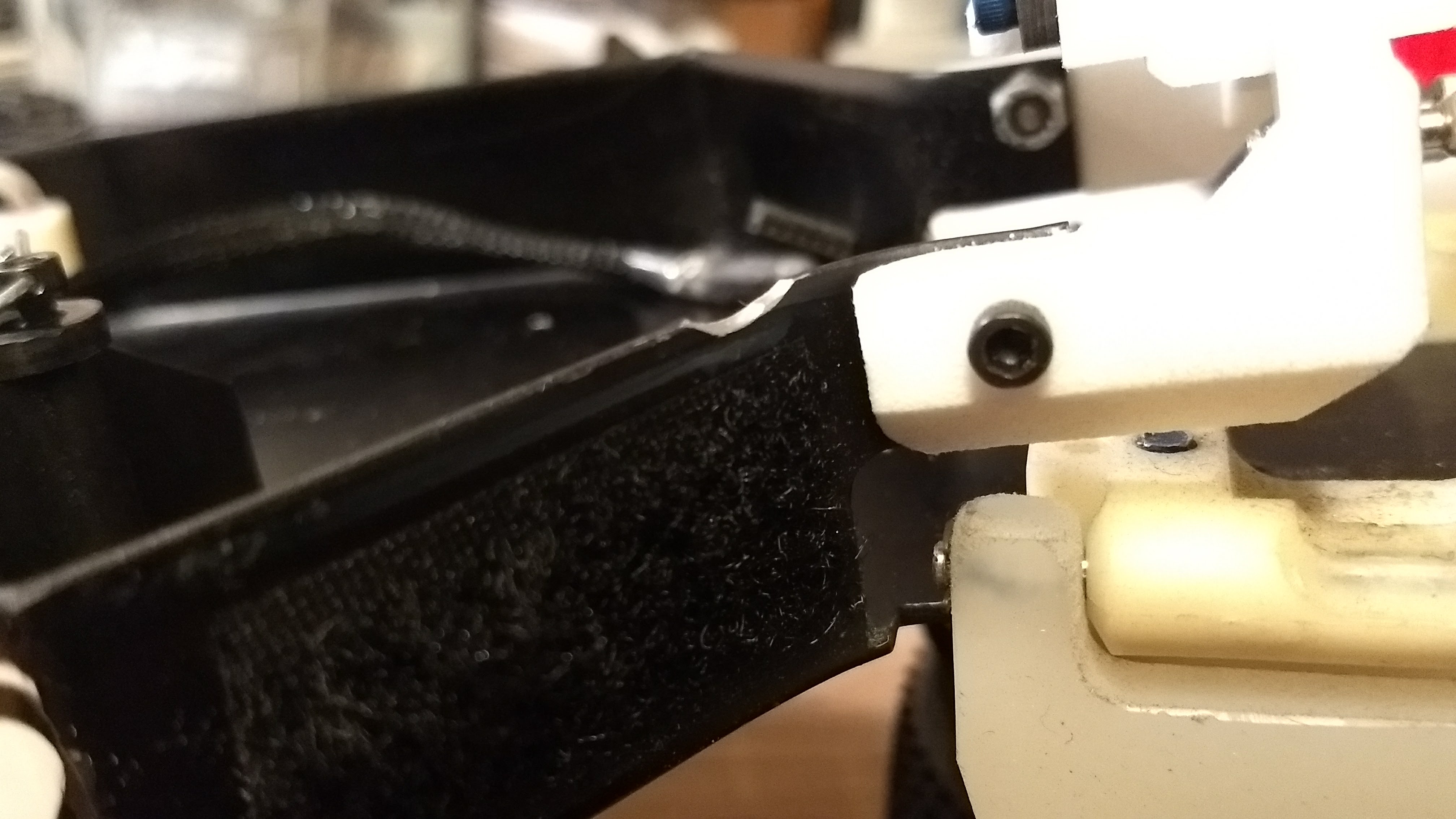

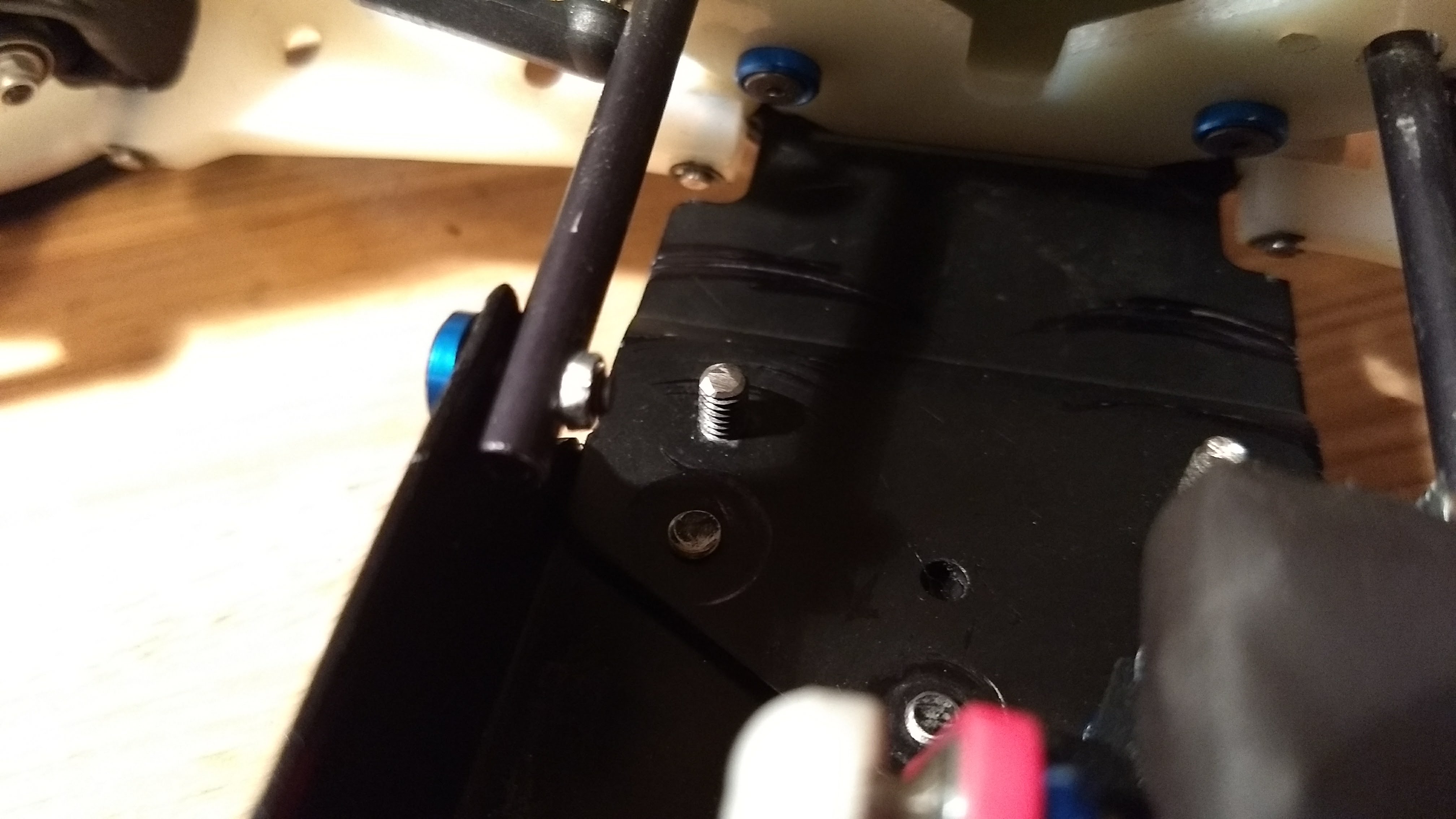

Disassembly time... and I find out that there are stands in the steering assembly, meaning shorty screws are needed.
So I have to pull out the dremel and cut some BHS screws on the B1M - remember I'm on LWB setting, so the far away holes in the nose plate aren't countersunk:

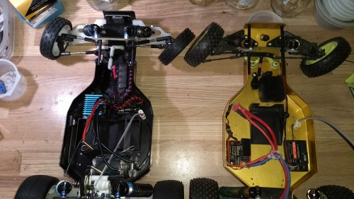

Before bolting it on, a few comparison shots that show (1) the LWB of the B1M and (2) how the steering/ackermann look better on the A&L setup (more lock AND more differential steering!). Still, once raced, the B1M will get its RPM steering back, or maybe a worlds re-re steering, really, as it will end its life as a mild runner (if runner at all)
More to come when I have more time... which is proving a challenge these days

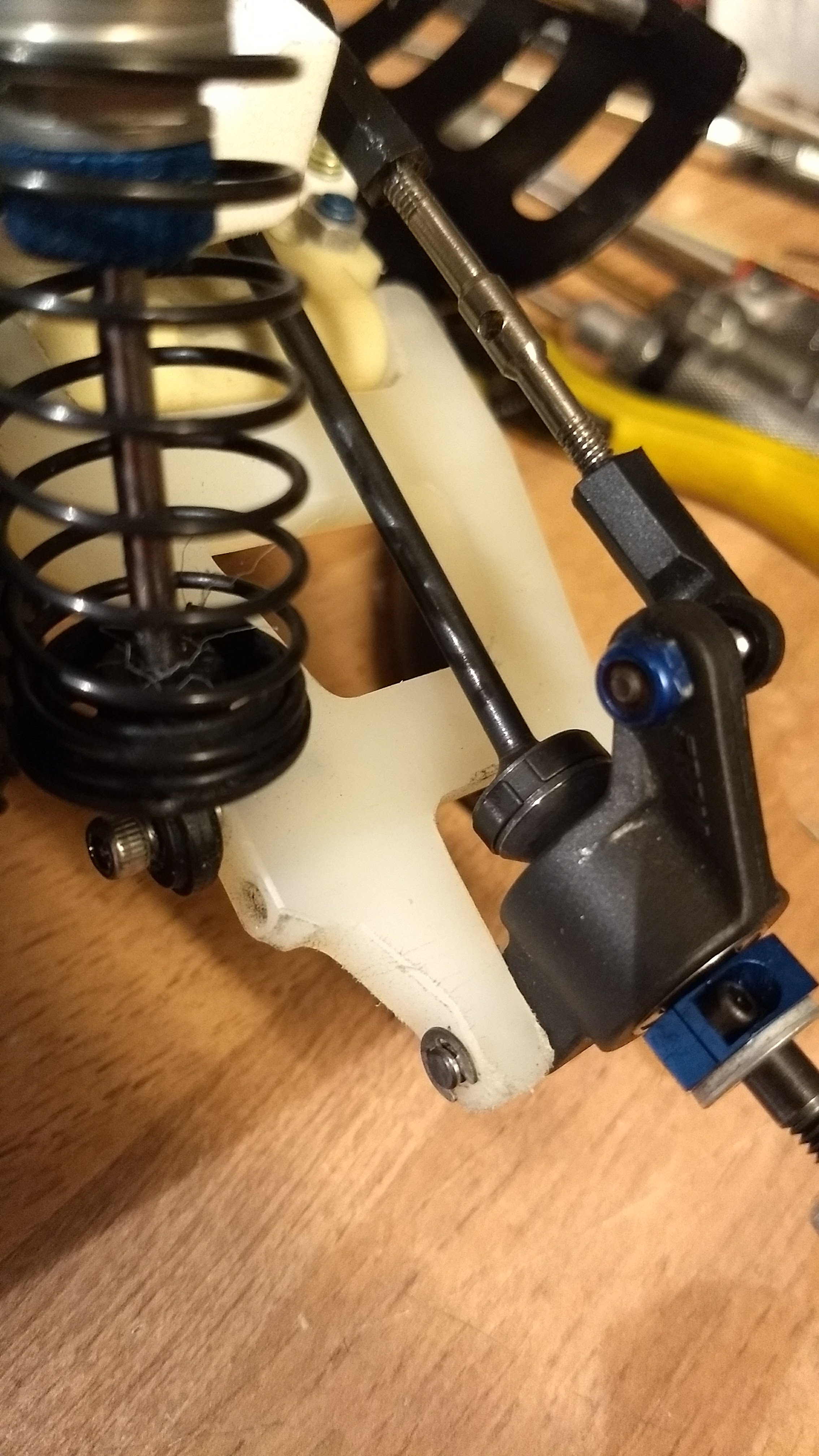

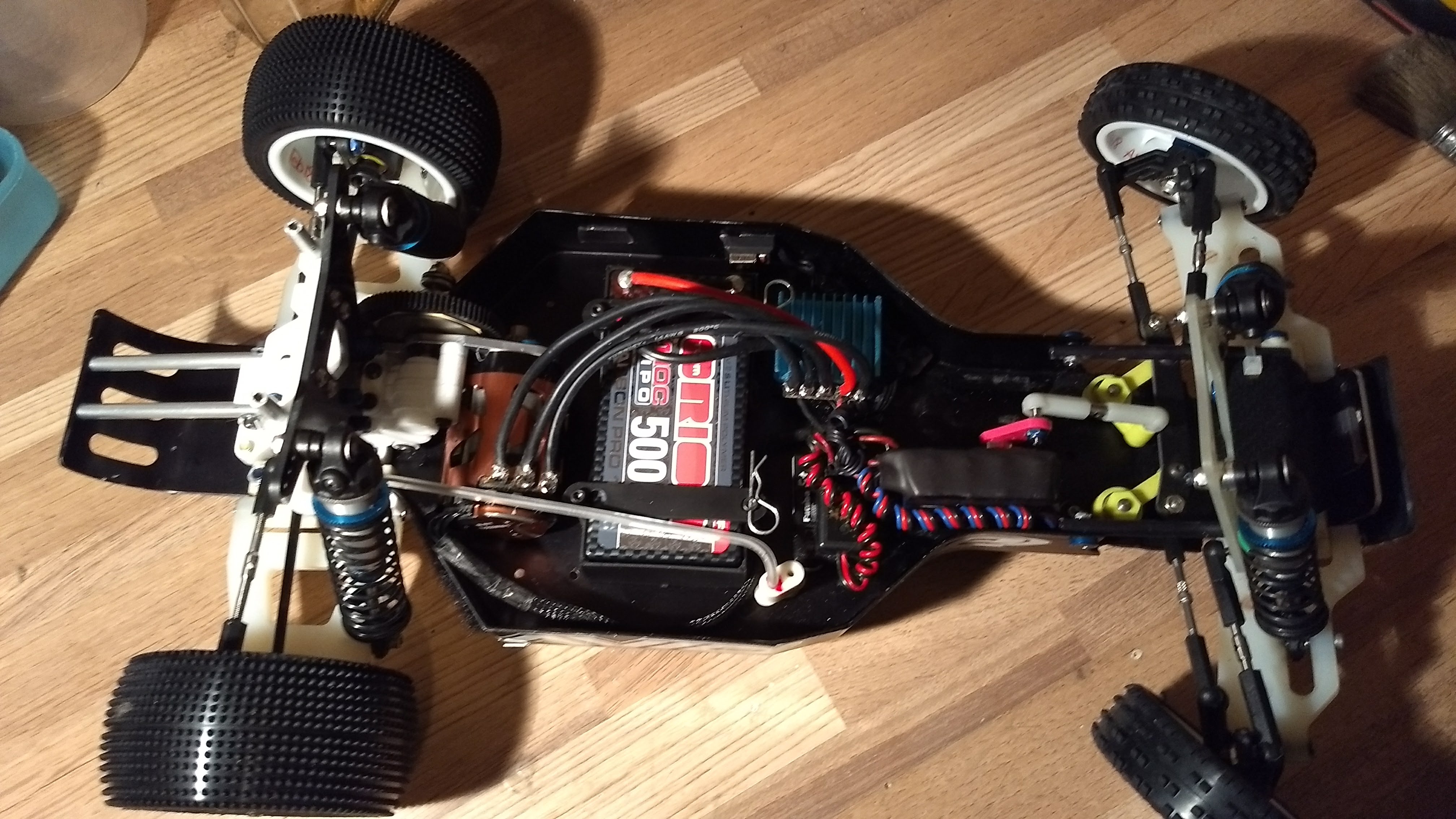

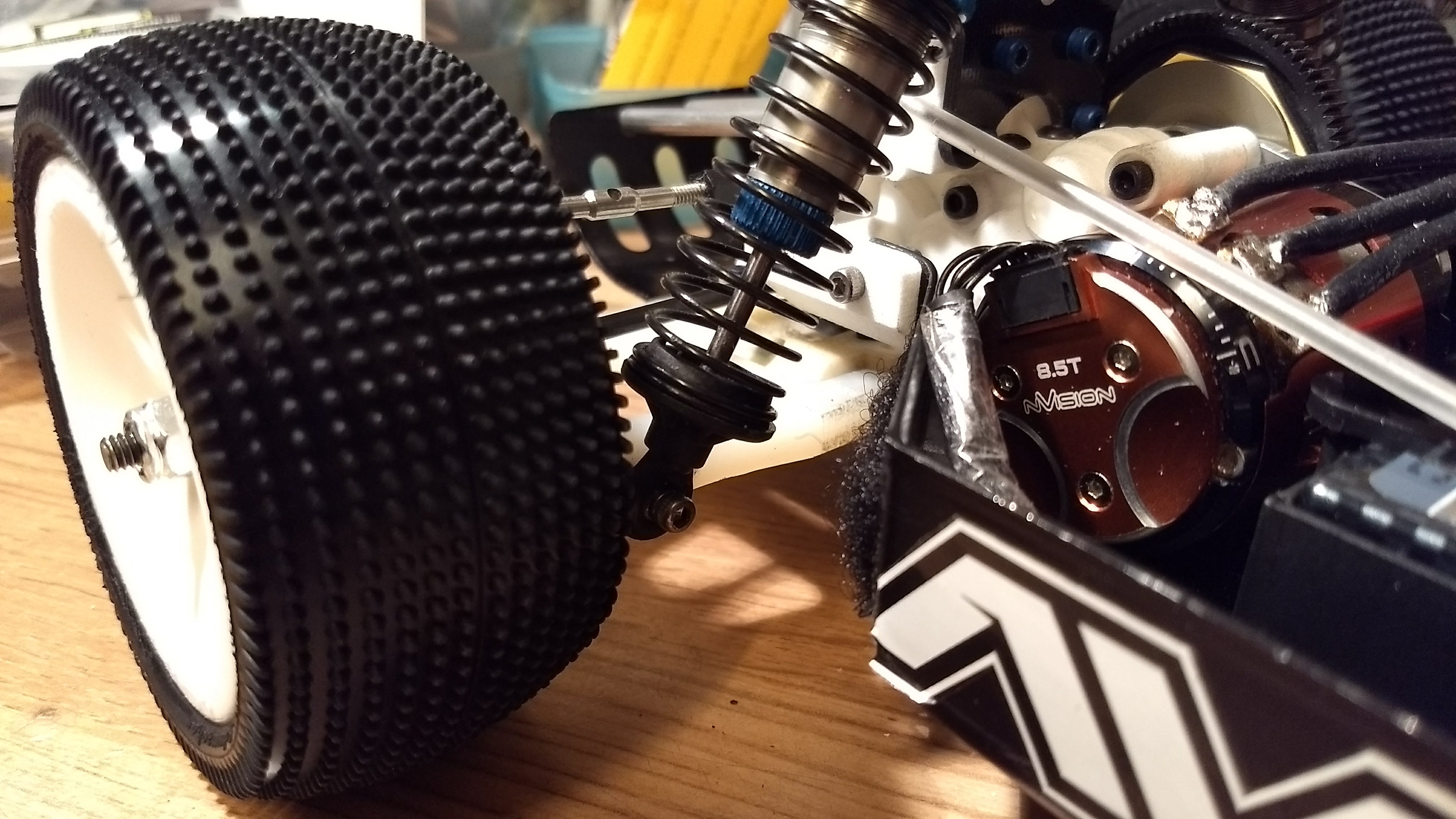

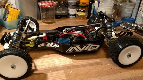

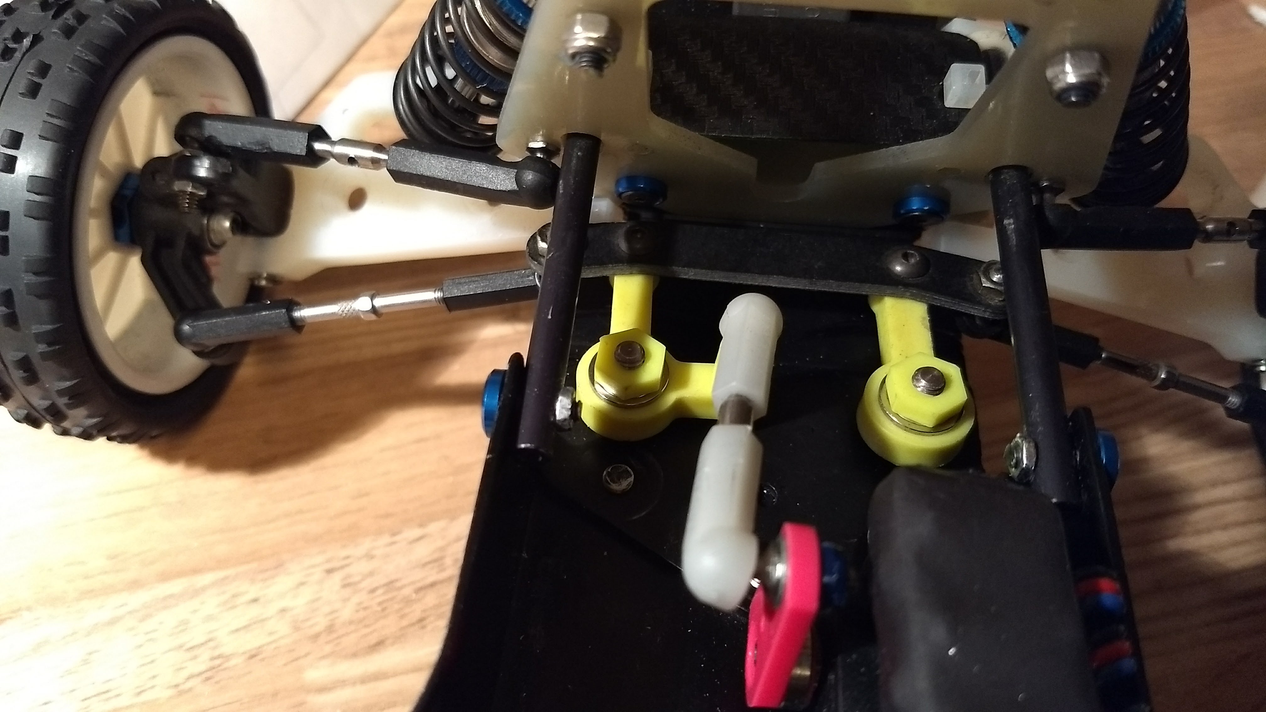

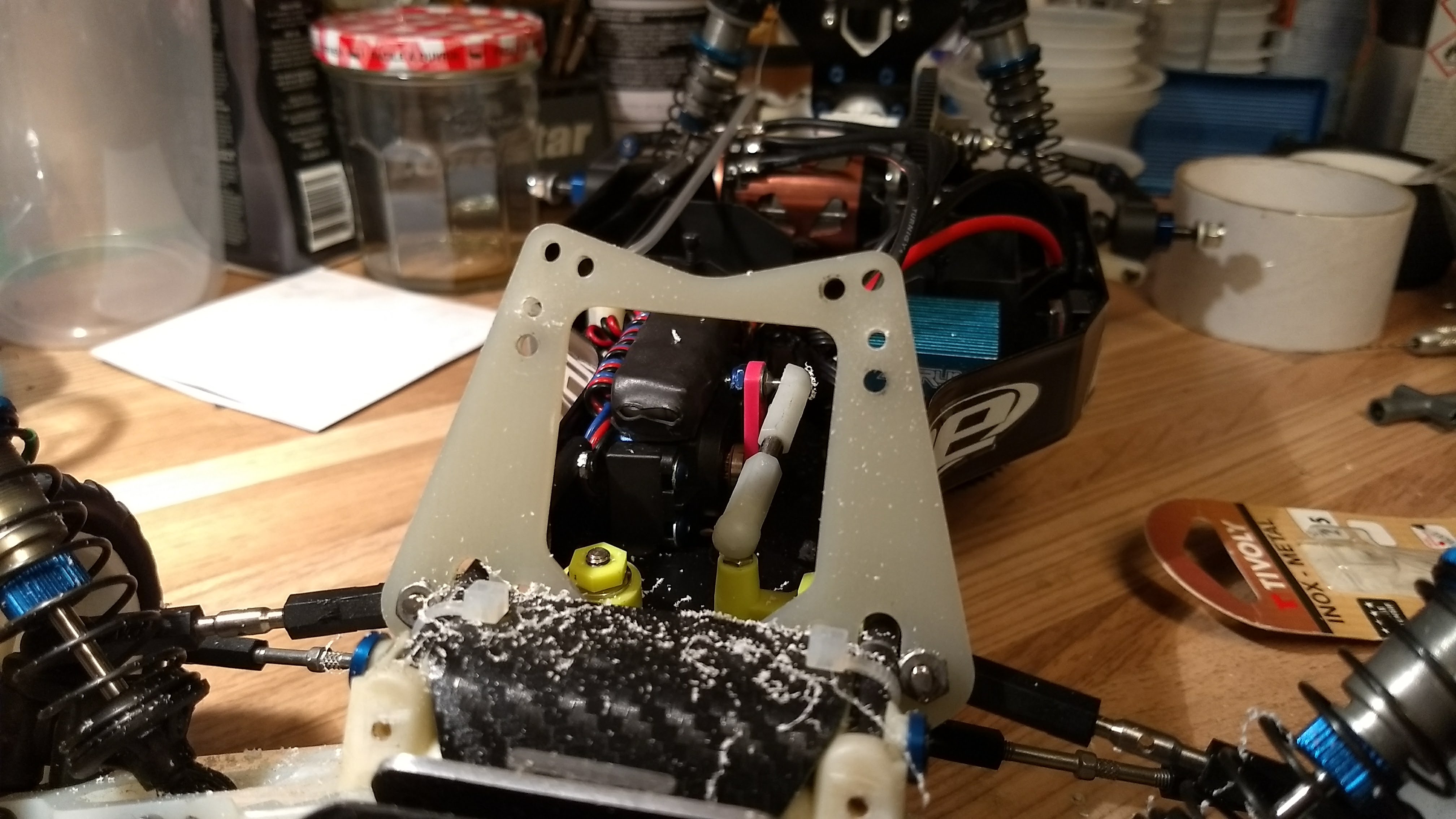

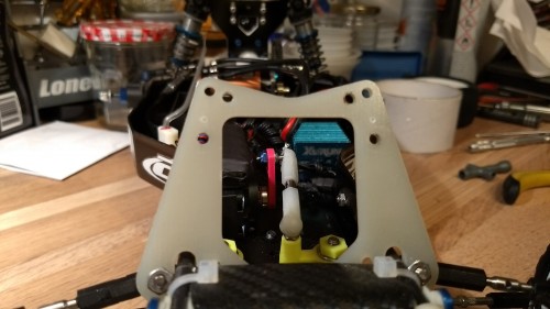

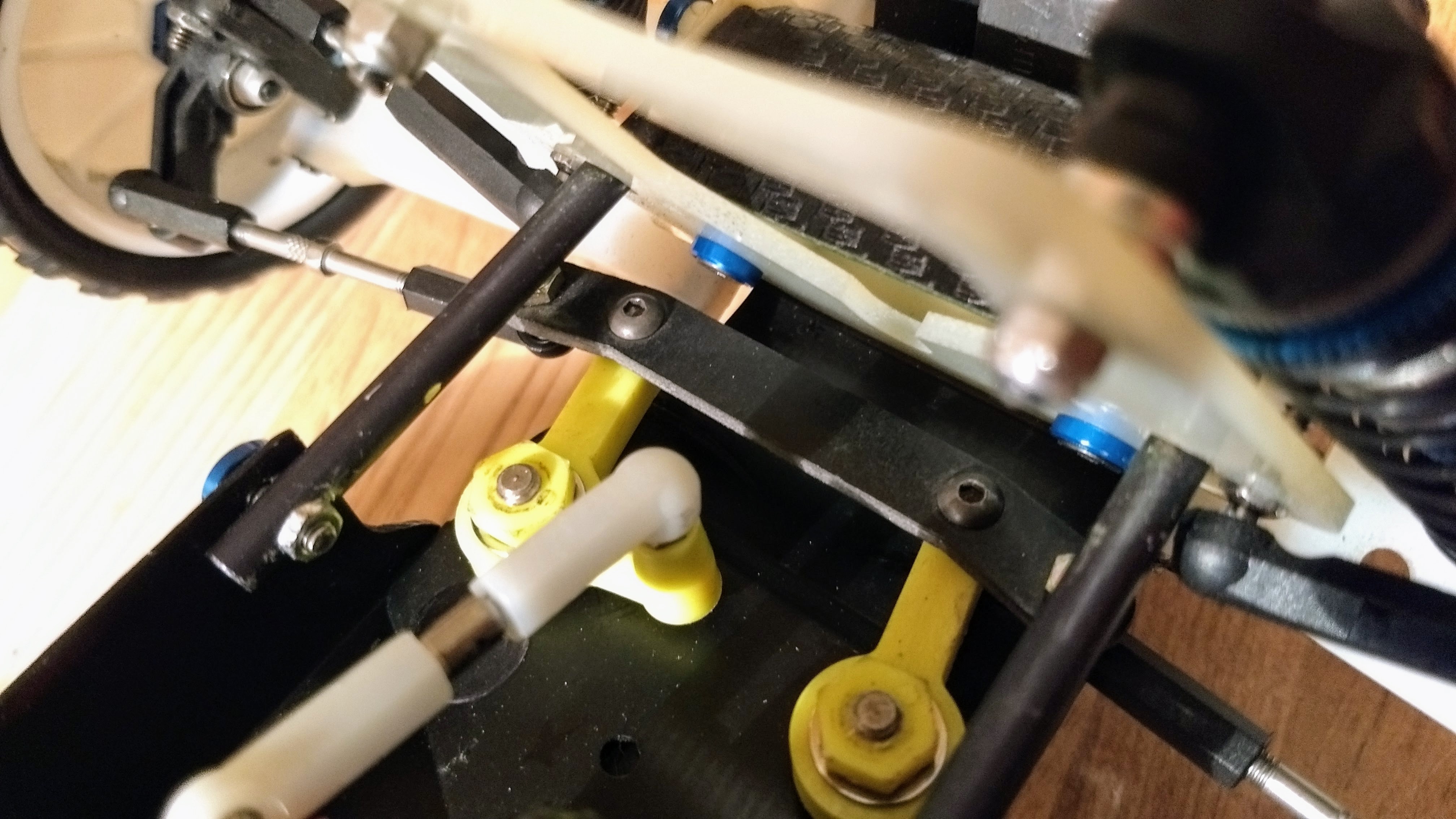

I could log in a couple of hours on the car these past few days.
Steering now fully installed... with a mix-match of turnbuckles to make it all work, as the tecnas I had were too long since now the connecting bar reaches further.
It's a bit dirty because, again, it's my runner's. the lo-profile nylon nut threads are stripped, I'm waiting for some new ones anytime now
But I'm happy to report that it's better in EVERY aspect:
- less wobble on the inside wheel
- more throw on the outside wheel
- differential steering that looks better
- less toe variations on compression/extension... should make it for a more predictable car.

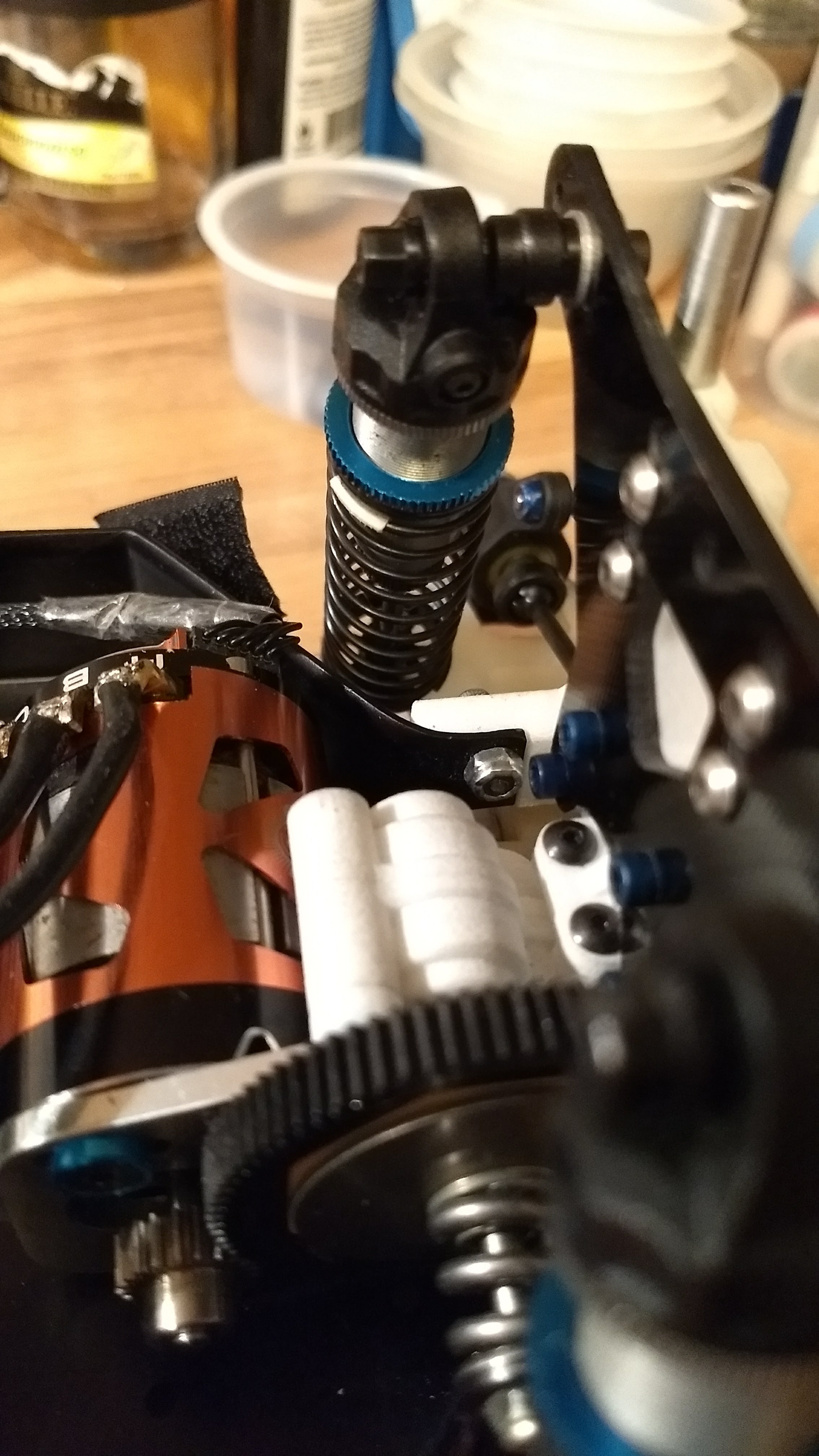

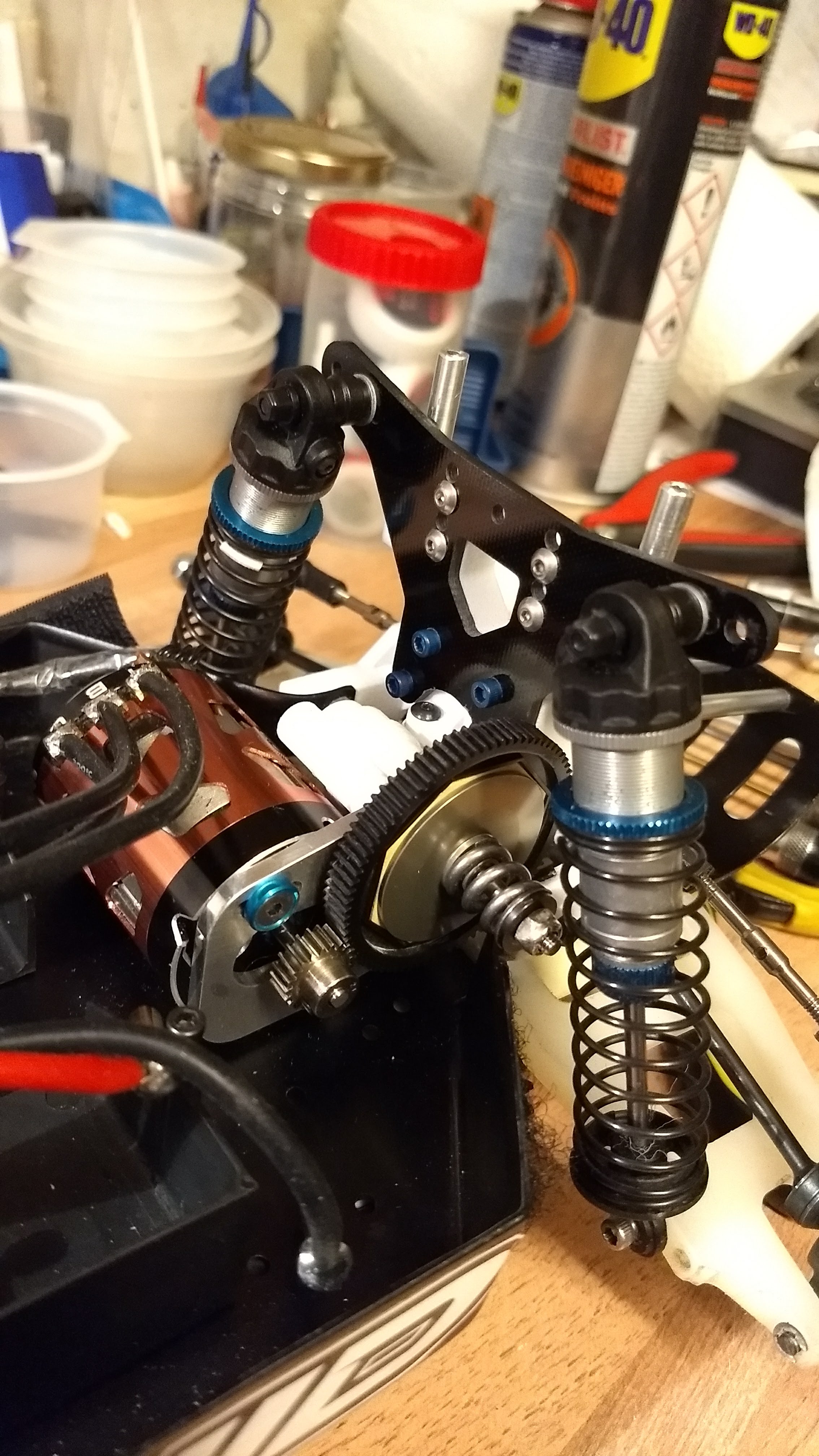

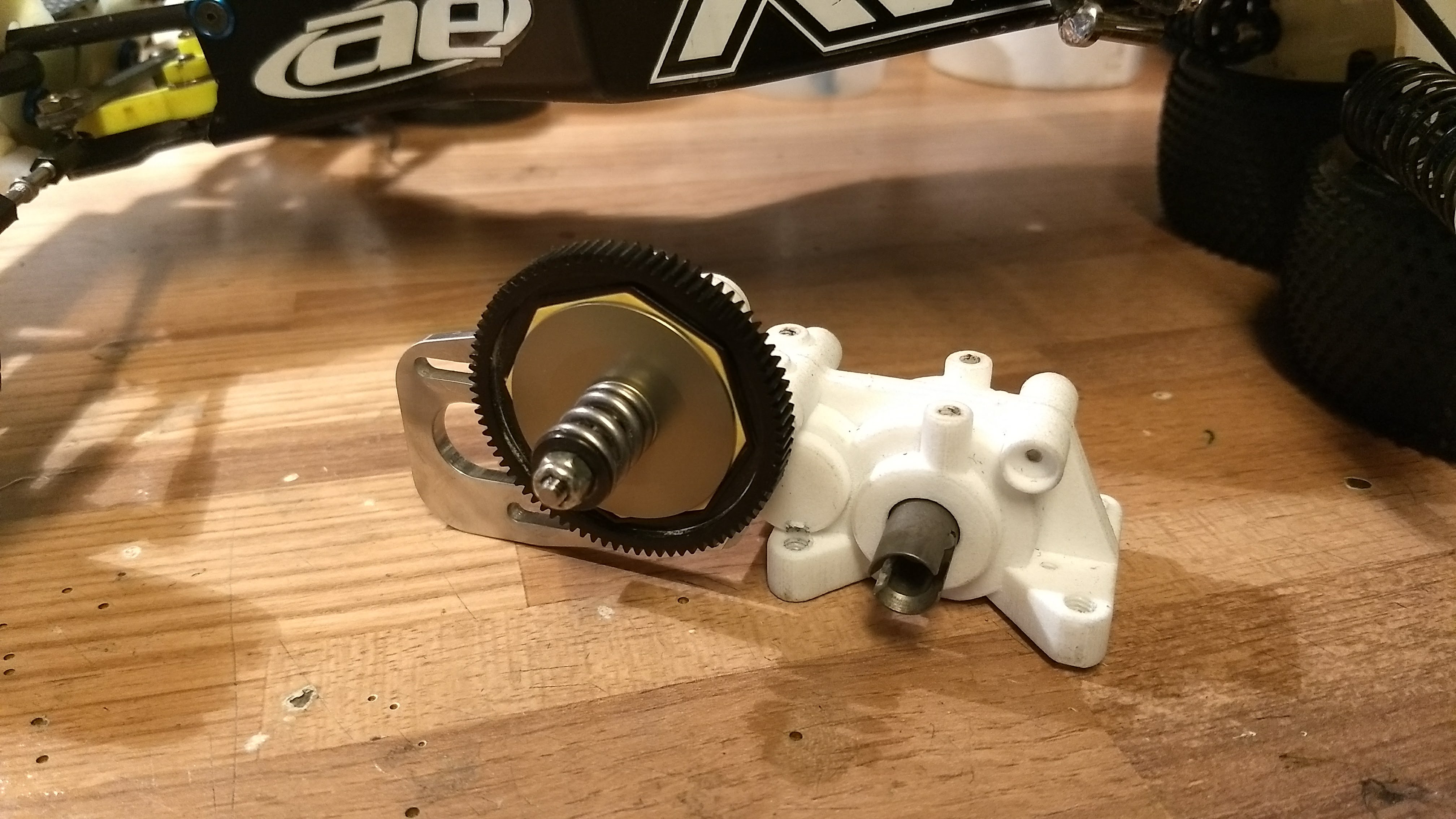

Then I pulled the transmission out, to replace the motor. While I was at it, I cleaned and rebuilt the diff (lots of motor spray involved). I just LOVE the stealth diff... it's such a treat to rebuild, it feels so good right after, and I've done so many over the years that I can do them with my eyes closed and one hand tied in the back
Overall the diff had 16 packs and was feeling slightly gritty, but it could have done one more race no problem. But given how crappy accessibility is on this car, I figured out, what the heck.
Gotta love that compact design from CPD
I also noticed that the V2 slipper I had installed (can't remember whether I had mentioned I had upgraded from a V1), the spring was dangerously close to the tub... As I don't have scr8p's dremeling skills, I did this in a few seconds.
That car might be a runner, it's still ugly that way - so the sharpie comes to the rescue

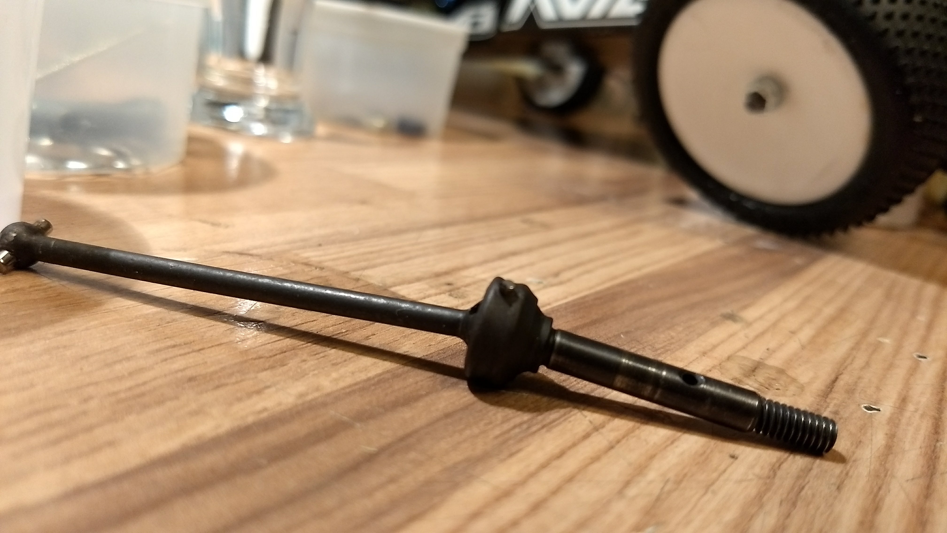

- fix that darn rear UJ with a proper retainer clip (the shring wrap was pierced by the pin...)

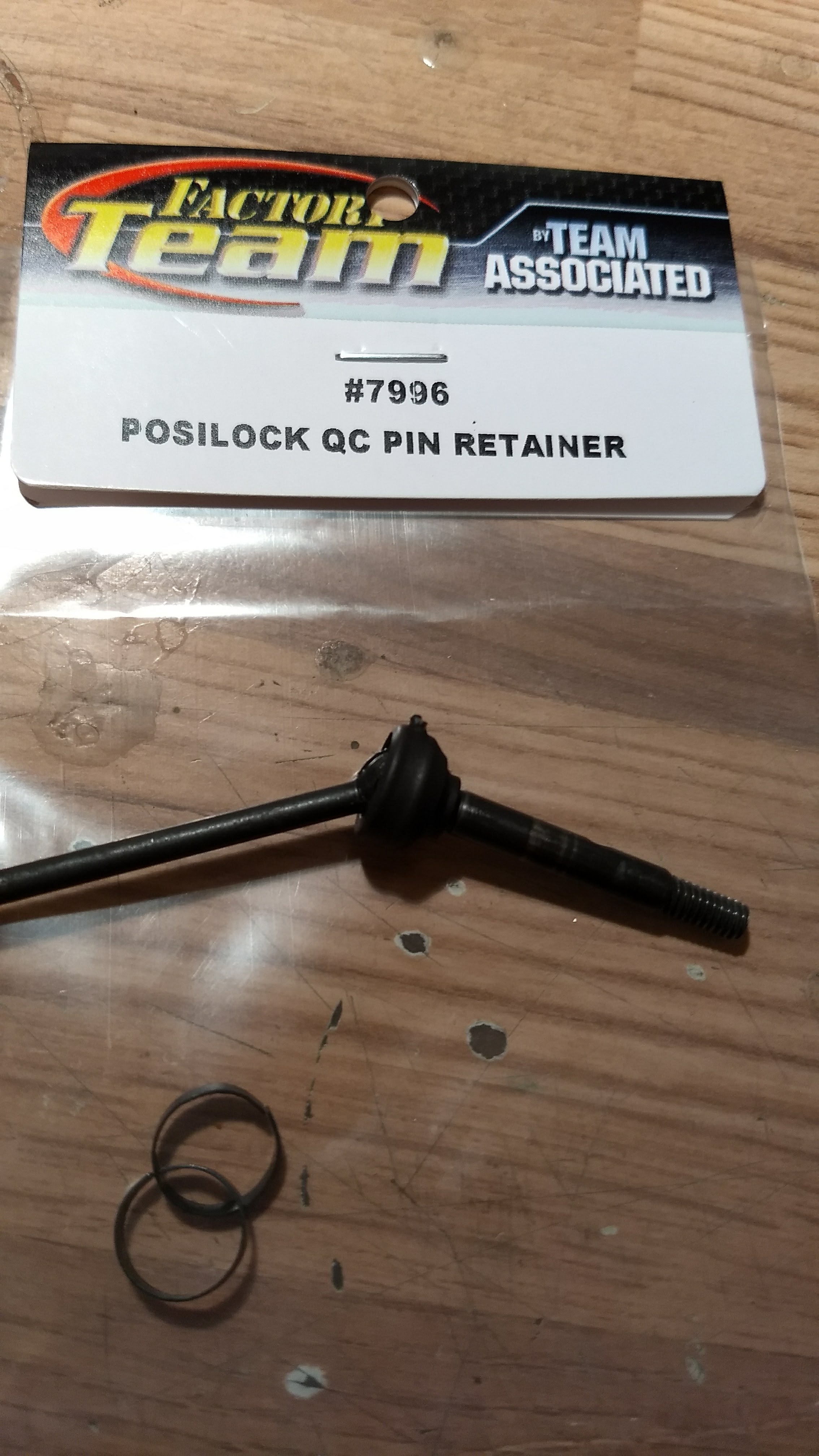

Reading your post just reminded me of a question I've been meaning ask; why not just use the provided grub screw with Loctite to secure the CVA pin? Then, add the included retainer ring for added insurance (like belt and suspenders). Securing the pin via shrink wrap alone is just asking for trouble IMHO (like fixing a flat tire with bubblegum). Unless, I'm totally missing something here which is entirely possible.
- Lonestar
- Posts: 4270
- Has thanked: 623 times
- Been thanked: 171 times
Re: Lonestar's RC10 OIN - turned B1M Racing chronicles (Race #2 on P.5)
Good comment and cannot agree more with you! That's why I am using the grub screw already - and it is loctited. And, yes, I've degreased the snot out of the the whole thing... still the pin flew off both races, and even went half-way through the shring wrap last timeXLR8 wrote: ↑Thu Feb 15, 2018 9:49 am Reading your post just reminded me of a question I've been meaning ask; why not just use the provided grub screw with Loctite to secure the CVA pin? Then, add the included retainer ring for added insurance (like belt and suspenders). Securing the pin via shrink wrap alone is just asking for trouble IMHO (like fixing a flat tire with bubblegum). Unless, I'm totally missing something here which is entirely possible.![]()
I think the issue is that the grub screw is a 4/40 instead of an M3 thread - less grabby thread on that short a length. Additionnally, the head is a tiny dinky SAE size (what is it, 1/32 or something) that prevents you from tightening it like you normally would by fear of stripping the thread...
Hopefully the grub screw AND a retainer clip will work this time

Wow, okay. Well, hmmmm. I'd thought, under those circumstances, that pin was there to stay. If the grub screw won't hold the pin, I fear that flimsy retainer band might not hold it either. What's next, break out the welder??
I wonder if the hole the pin passes through might be a little oversize and this is allowing the pin to work itself loose?
- Posts: 1254
- Has thanked: 727 times
- Been thanked: 26 times
I have had that problem before, I found the grub screw was tightening up but wasn't actually going in far enough to
grab the pin.
Now I check by just having the cylinder thing and screwing in the grub screw, looking through the hole, the grub screw
should cover half the hole.

could be partially it - the pin would likely have flown off earlier in the day though... it still took it about a full raceday to work itself out... probably more a vibration thing.DaveM wrote: ↑Thu Feb 15, 2018 4:21 pm I have had that problem before, I found the grub screw was tightening up but wasn't actually going in far enough in to
grab the pin.
Cheers, Dave.![]()
Next time I need to grind a flat spot on it where the grub screw touches it. For now, this'll do... (I think)
And, back on the car...
I'm using plastic shock stands now, too... while the STRC ones are back on the traxxas shelfer.
And the car reassembled with a proper 8.5T race mill now. This one feels sooo different in static that the throttle feel should be a totally different one on the track - not necesssarily a good thing. We shall see.
Still a few things to do but we're close to completion.

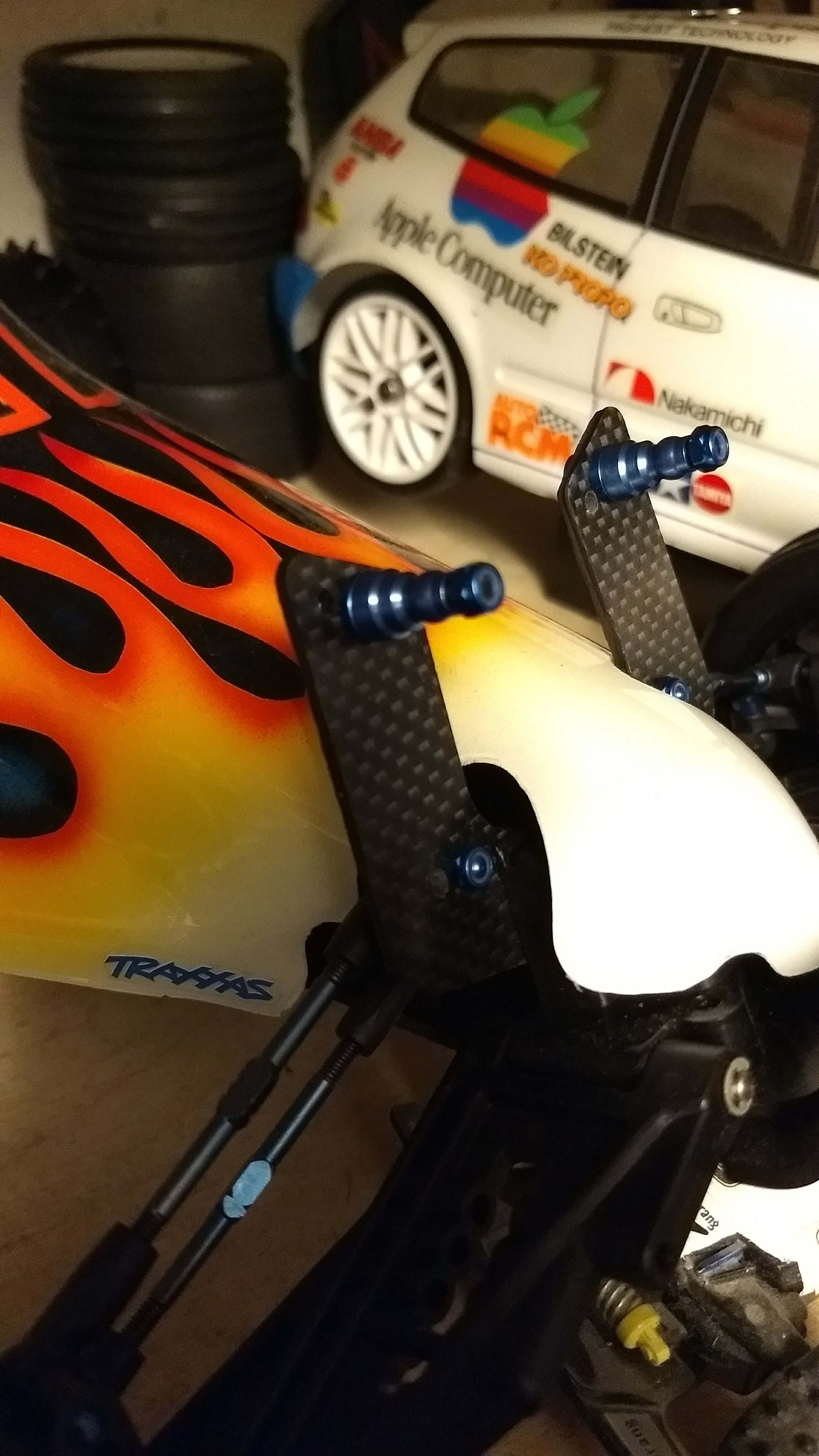

I'm debating whether to cut the body and install those B5 wing mounts I bought for this car, or to leave it with the old-school wing tubes. A naked rear body looks good when there's a transmission to show off! Here there's just a weird blank, open space at the back... Still not quite decided yet as a proper wing and mounts would make it an easier car to wrench on (and marshall... I'm always freaked out when the marshalls take an wing-tubed RC10 by the wing...)
@mk-Zero Brian, one more thing. On the left side, the screw that mounts the bulkhead to the chassis, right next to the spur, is spontaneously working itself out. I use a loctited lo-profile nut as recommended, but I think that, given the amount of stress in this area, this is not enough. Either thespur needs to be spaced further inin to use a proper-sized screw/nut, or the screw/nut asssembly needs to be swapped (nut out), or something else. Just feedback

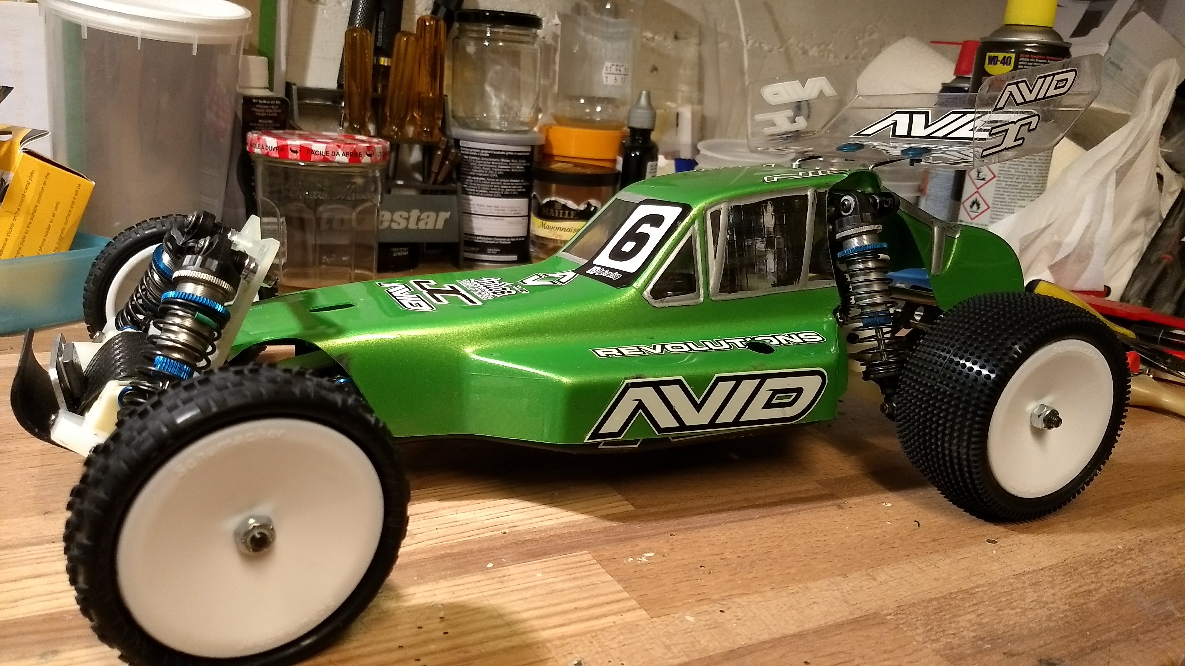

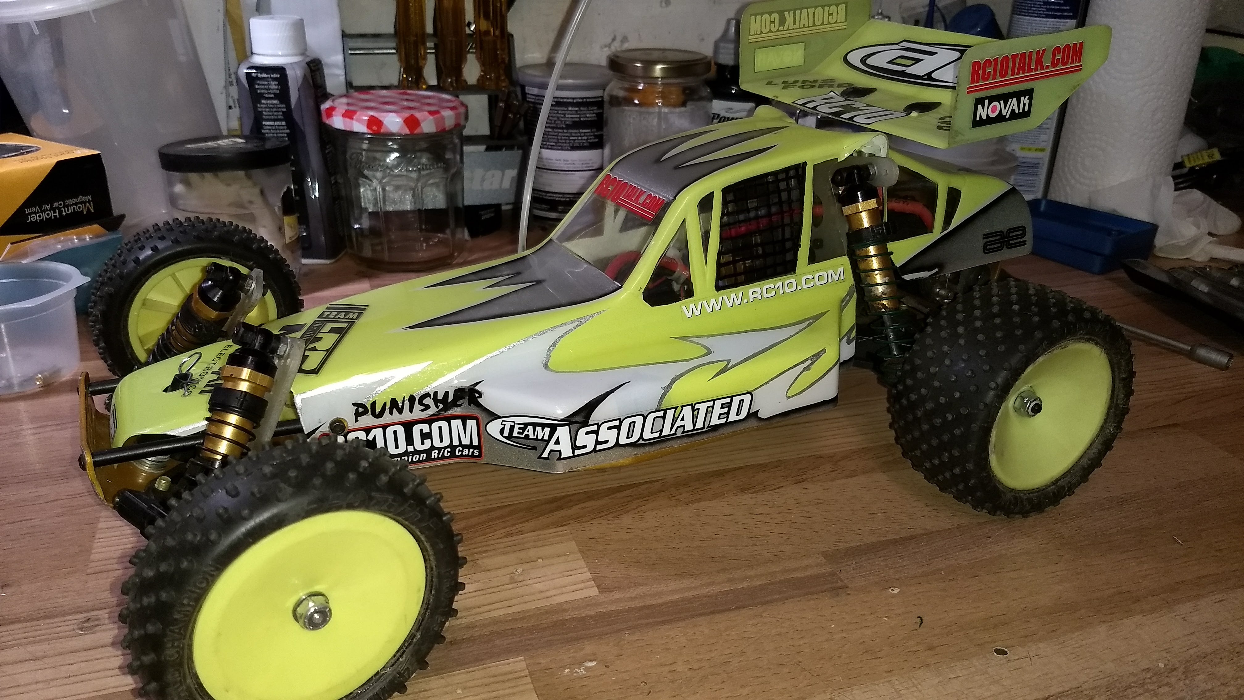

Last update before raceday saturday - which will be the car's racing career swan song
NOS fluo yellow nuts received - thanks Mr. YouKnowWhoYouAre
RPM world shock tower pre-drilled for custom shock mounting points (yeah I know... sacrilege... I don't care anymore, the whole car is blasphemy anyway
And drilled + tapped M3 so I can get some support from something else than then dinky M3 locknut in the back of the tower that allows for quick changes (rather than the original sandwich construction). I do this on all my racecars if they don't have the lunsford/xray quick mount systems.
I then rebuilt the shocks, and changed rear pistons from 1.7's to 1.6's so I can get a bit more pack with still some about acceptable static hydro. I'm now on 1.6's-32.5 F & R. We shall see. The (B5) shocks had actually swallowed quite a bit of air, the fit of the lower plastic collar around the shaft isn't too impressive. I wonder if the B6's are better... Anyway. Damping has always been my challenge on this car from day zero, whatever the shock model I'm using...
And now with new spec shoes (schum cactus rear)
Couple of final shots:
and body is back on - ready for battle!
watch out for a race report next week
