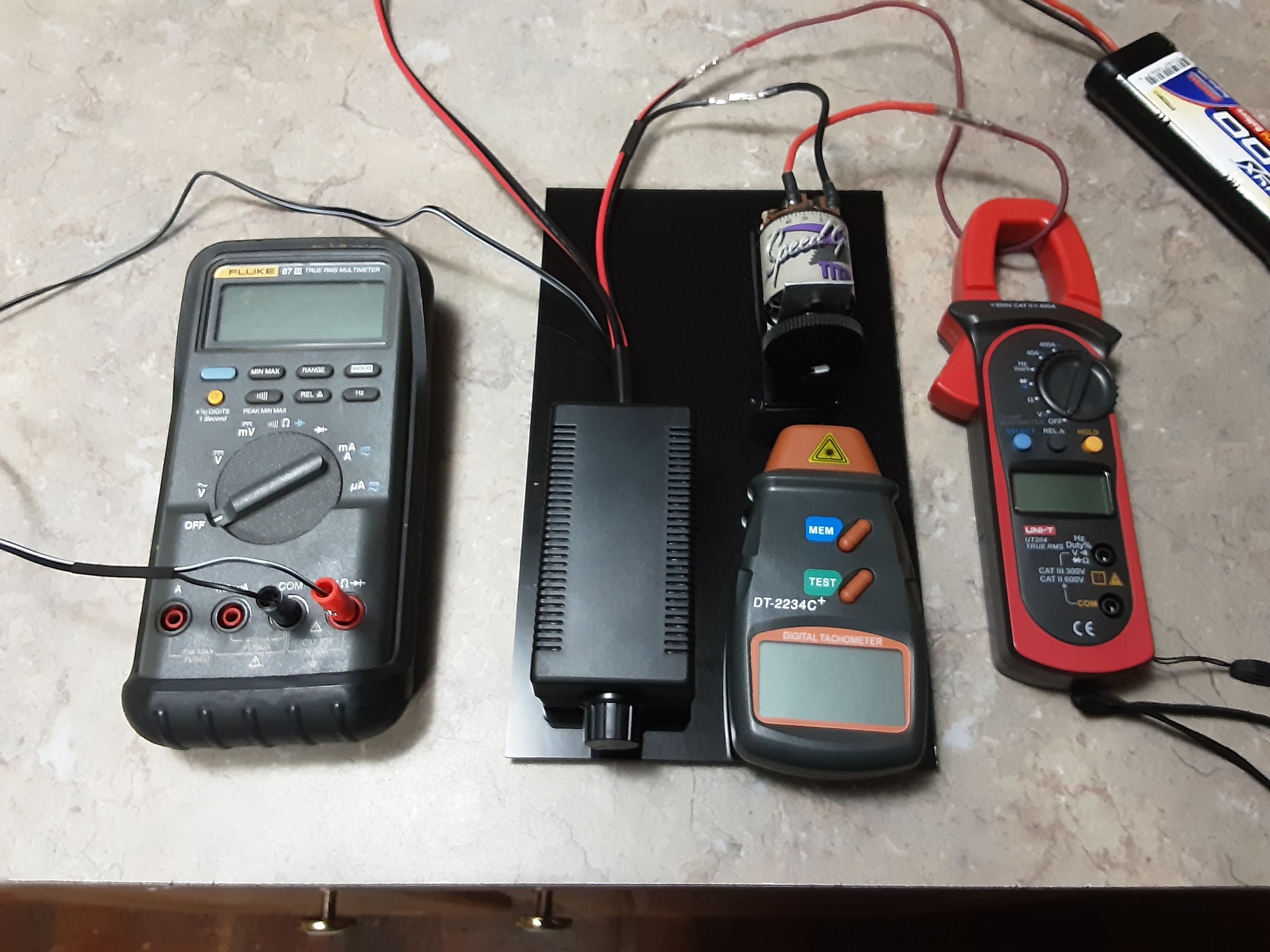

Finally got my rig up and running, sorta. My power supply did not like the inrush current demand of the 15T Trinity, so I grabbed a 6 cell pack that still had a little juice in it.
I made a mounting plate from 1/8" lexan and put 3M pads on it, stays perfectly still.
When I wired the speed control, I add a set small wires on the motor side with banana plugs. They plug directly into my DVM, keeping me from having to fumble with test leads.
The motor I tried out was a Trinity Titanite, 15X2. It is Factory rated at 33,700 rpm, at whatever voltage and timing they chose.
This motor is in the "as is" condition when I removed it from one of my trucks. While still in good condition, it could use a quick once over.
I grabbed a pack that wasn't topped off, so I only had 7.1 volts (and it was fading). At 0° timing, it ran 29,600 rpm and pulled 5.3 amps. When I get a chance, I'll try a fresh 7 cell pack so that I can trim it back.

That's a tidy setup , I need to do something similar with my V meter wires .

Nice setup, JC. 8) Has anybody tested a brushed motor on a fully-charged 2S LiPo that hit 35k RPM yet? Of my 5 motors I've tested thus far, only 2 broke 30k: the Le Mans 240SB @ 30,457 rpm and my surprising Le Mans 480S @ 33,446 rpm. I rebuilt that one long ago and it probably has some other comm under the hood than the original...maybe a 240SB comm. :shock:
I have a Trinity D3 that almost broke 30k, coming in @ 29,753 rpm. I have a bunch of other brushed motors but they all need rebuilding first. No time for that right now...

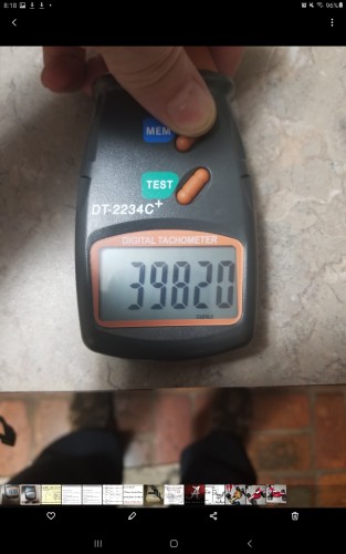

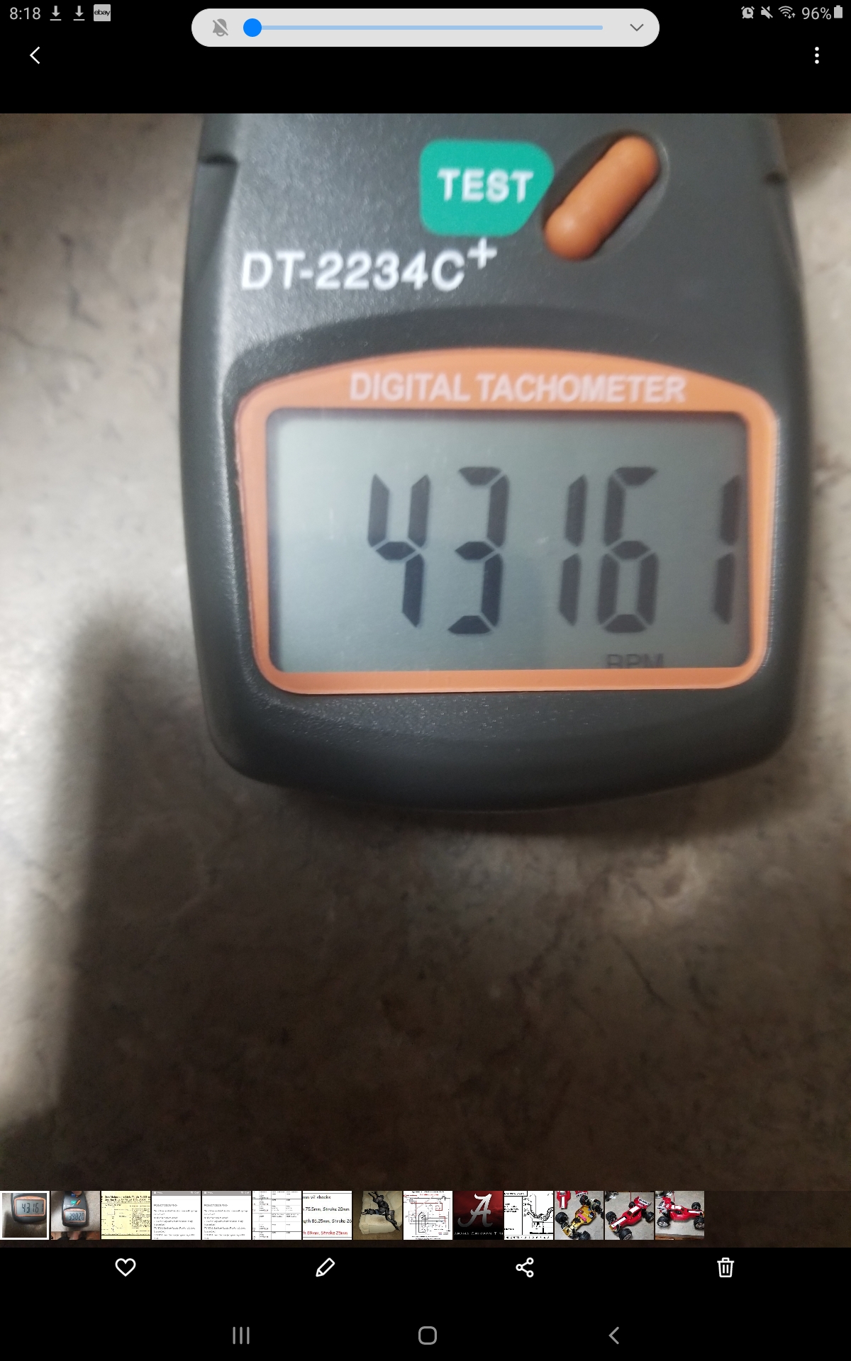

Coelacanth wrote: Fri Mar 12, 2021 11:36 am Has anybody tested a brushed motor on a fully-charged 2S LiPo that hit 35k RPM yet? Of my 5 motors I've tested thus far, only 2 broke 30k:
Here you go.
Kyosho 12X2 Mega. The comm and brushes aren't fresh but they were cleaned with a comm stick. Timing at 4°.
7.2 volts- 39,820 rpm.
7.4 volts- 43,161 rpm.
I tried to spin it all the way up on a fresh 8.4 pack (~10 volts) but the tachometer couldn't get a reading.
