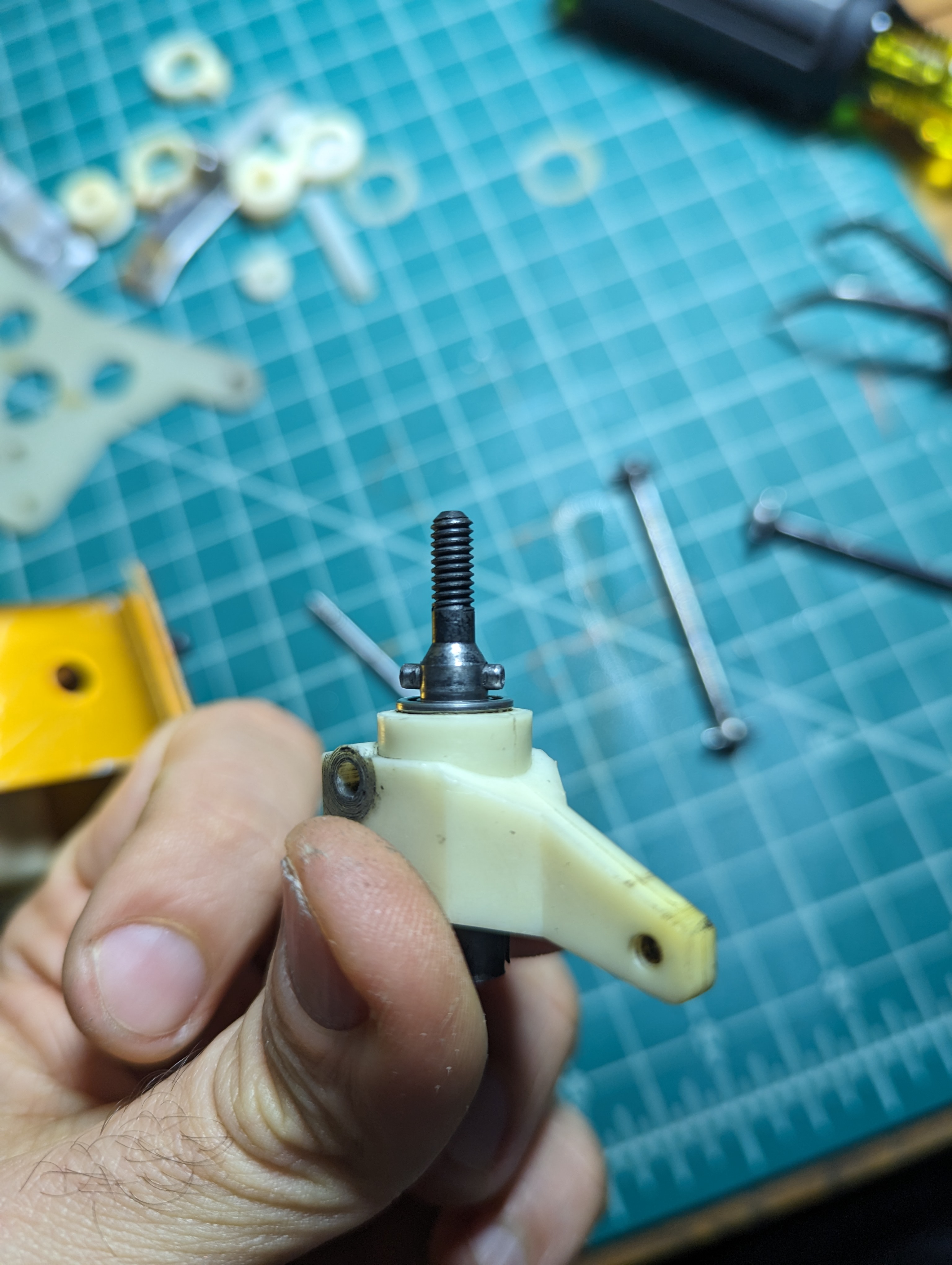

Back with a quick question. I'm finishing up the rear end and noticed that these pins are extremely loose in the rear axles. According to the instructions, they should have been hard to insert but they pretty much slip right out. I'm assuming these need to be really tight in order to keep the axle from slipping out of the hub. Should I order new ones?

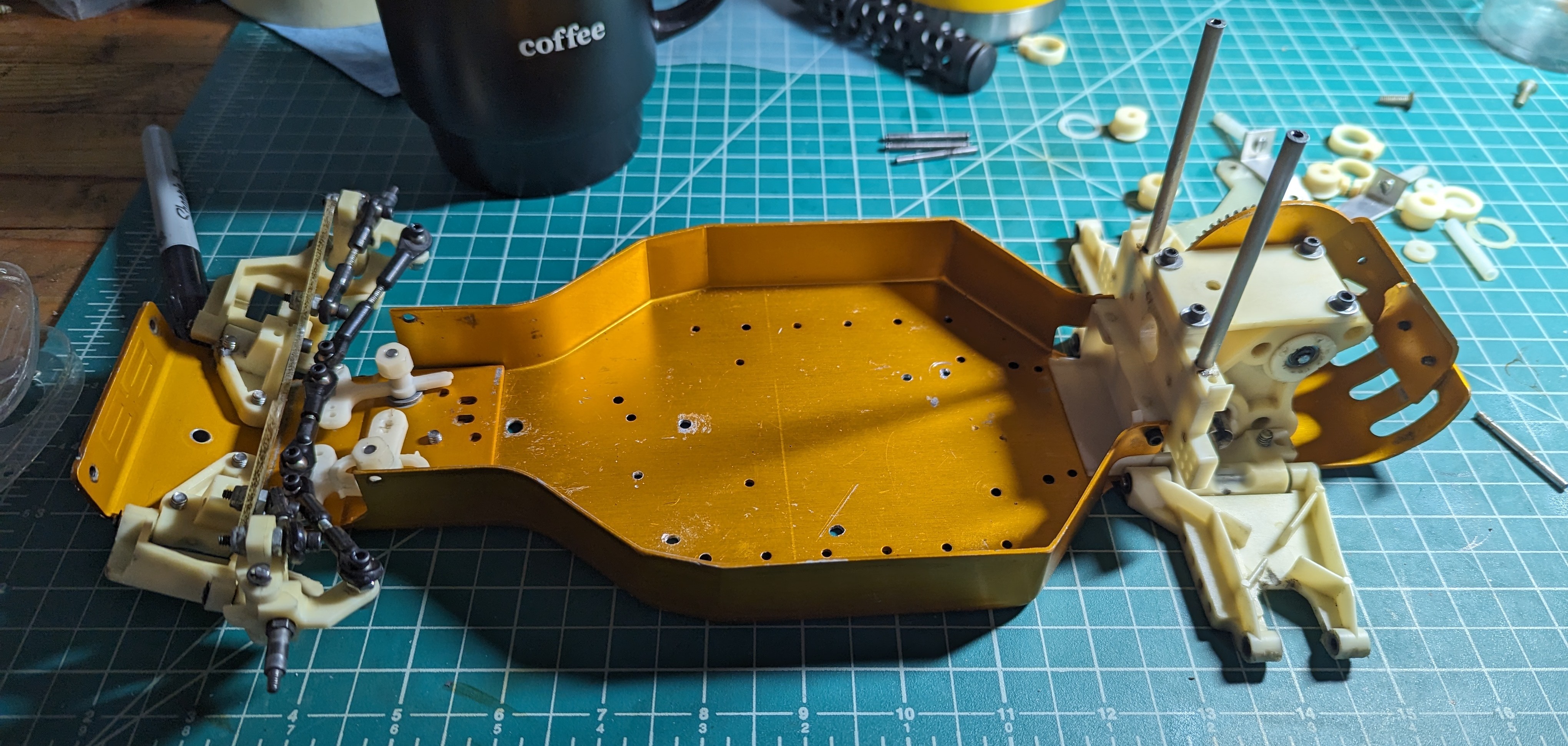

Oh and one more thing. I do not have the felt seals for the two sides of the transmission. Is that a required part or can I do without it? Can I maybe just cut some felt from the hobby store into a washer shape and use that?
Oh and here is the current state. Got a bit distracted building a TT02 kit but I am back at this now. Missing more parts than I originally thought. Need to buy body mounts eventually. And then also missing one of the 2 plastic pieces that sit on the felt seals as well.
Posts: 3677
Has thanked: 2520 times
Been thanked: 2822 times
Re: Gifted an old RC10. Restoration Process
Did you decide against doing the outdrive bearing mod? That no longer requires the felt seals.
JoeP
Posts: 44
Joined: Sat Sep 23, 2023 12:54 pm
Been thanked: 5 times
Post by JoeP »
Frankentruck wrote: Thu Nov 09, 2023 5:47 pm Did you decide against doing the outdrive bearing mod? That no longer requires the felt seals.
You know .. I totally forgot about that. Going back to remind myself now. Thanks
