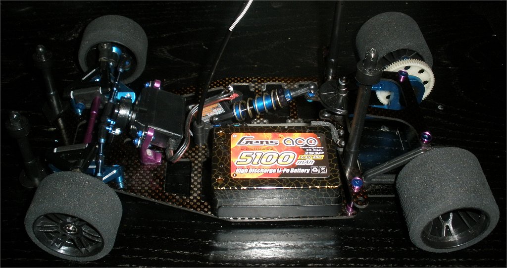

So considering a battery for this car, and suggestions to use a 1S LiPo with a 13.5T motor, I browsed about HobbyPartz.com and had this idea...I could pick up a saddle-pack like this, but only use one of the cells. That way I'd essentially be getting 2 batteries for the car, for $39.95...only about $10 more than the cost of buying a single battery. I suppose using only half the pack would mean the capacity would be 2550 mAh instead of 5100 mAh, but that should be pretty sufficient run-time with a 13.5T motor.
http://www.hobbypartz.com/98p-25c-5100-2s3p-hardcase-saddle.html
Does this sound like a good idea?
- Phin
- Posts: 2818
- Location: NY²
- Has thanked: 87 times
- Been thanked: 248 times
Re: RC12L3 Resto: '87 Buick GNX Build
One battery out of the saddlepack should stay at 5100mAh and have a voltage that gets cut in half to 3.7V. Which is what you'd be looking for in a 1/12 battery.
If it was mAh that got dropped to half then voltage would stay at 7.4V and that would be no good.

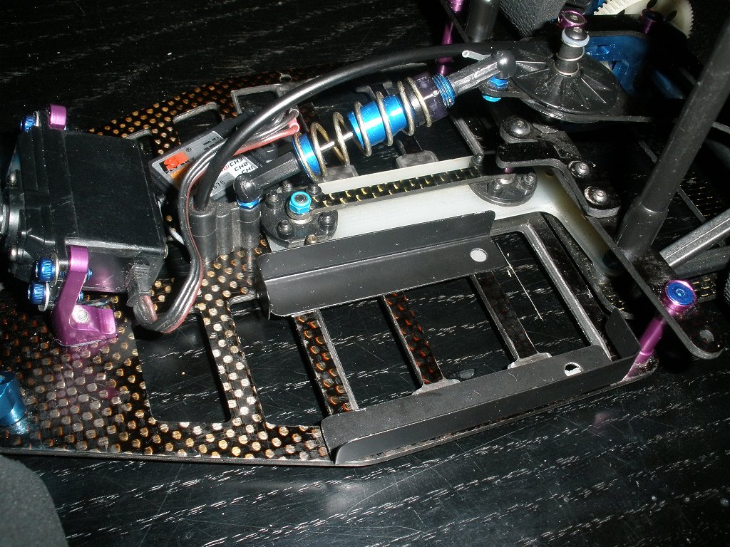

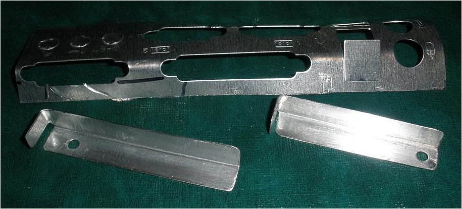

Since I seem to have run into an obstacle with ESC & 1S LiPo compatibility, I gave up on finishing the electronics and began fabricating a custom battery hold-down. It has been quite a challenge as this chassis was never intended to house a hard-case LiPo. I found that the battery was taller than the lateral carbon piece by just enough for me to cut out an L-shaped piece of carbon, then bolt it to the lateral piece to keep that corner of the battery positioned. I'll use the closer screw-hole to add a tab over the top of the battery which will screw down with a wing-nut or something.
I decided to butcher an old computer tower I/O slot cover as it had an L-shape already formed into it, and it's very thin, and seems strong enough to not bend too easily. I made corner tabs in each section and used a file to round the corners and smooth all the edges. The battery will fit like a glove. I sanded it down and it's waiting for a coat of SEM Trim Black to dry. The foam tape at the top right corner of the battery is just to protect it from abrasion when it's pressed snugly against the L-shaped piece.
All that's left to figure out is a way to secure the front of the battery.

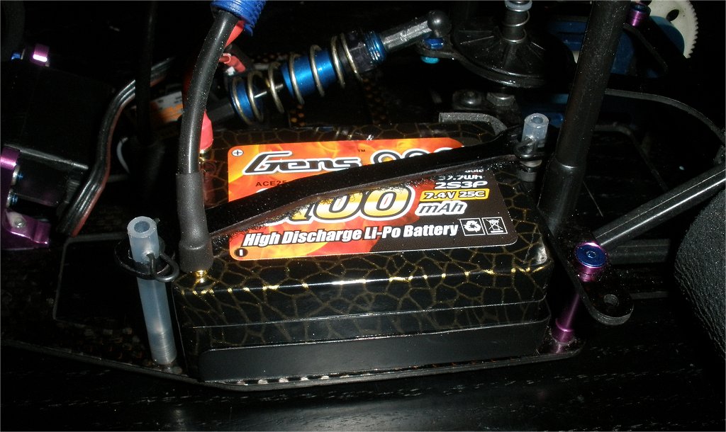

Progress pics of the custom battery holder. I either have to attach these to the chassis with double-sided tape or epoxy, because using screws would mean the battery couldn't sit flat against the chassis plate. I think the automotive-grade double-sided tape should be secure enough, and if not, isn't permanent...I'll try that out before perma-gluing the holders to the plate with epoxy.
The battery fits snug as a bug in a rug.
Now to figure out a way to secure the front of the battery...one idea is to cut an aluminum or plastic post to the correct length, drill a hole in the chassis plate and screw it in close to the bottom-left corner of the battery, then I could easily make a thin hold-down strip that would run diagonally from the top right (where the L-shaped piece is) to the bottom left. That along with 3 corners being secured by the metal brackets & L-piece should be pretty solid...anybody have other ideas?
- Coelacanth
- Posts: 7421
- Location: Alberta, Canada
- Been thanked: 325 times

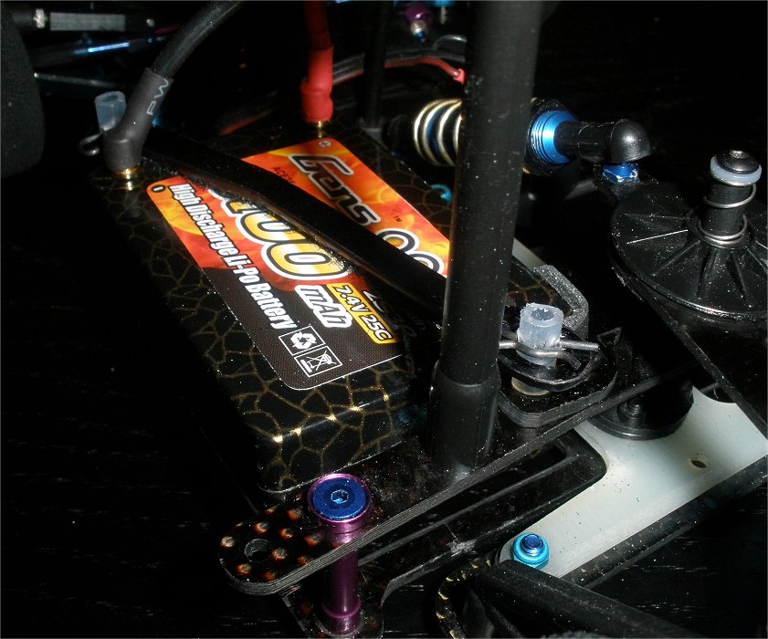

Battery hold-down finished. Even though this is my first Associated build, wouldn't you know it...there's a bit of Kyosho blood pumping through the veins. That's right, to fabricate the actual hold-down part, I chopped up a piece of Optima top deck that actually had screw holes in nearly perfect locations already.
Battery hold-downs for these old associated cars make a dummy out of me. I want to make something that holds the cells firmly in place, is easily removable, looks either trick or OEM, and costs less than $20. I have yet to come up with an idea I would call good.
Well, this certainly cost less than $20...some leftover sheetmetal, double-sided tape, old Parma body post cut into pieces and a couple body clips...functionally, this definitely secures the battery. For the cheap cost, it took a fair amount of work though, and as for looking trick or OEM and being easily removable...that's up for debate.FullThrottleTXOutlaw wrote:Battery hold-downs for these old associated cars make a dummy out of me. I want to make something that holds the cells firmly in place, is easily removable, looks either trick or OEM, and costs less than $20. I have yet to come up with an idea I would call good.

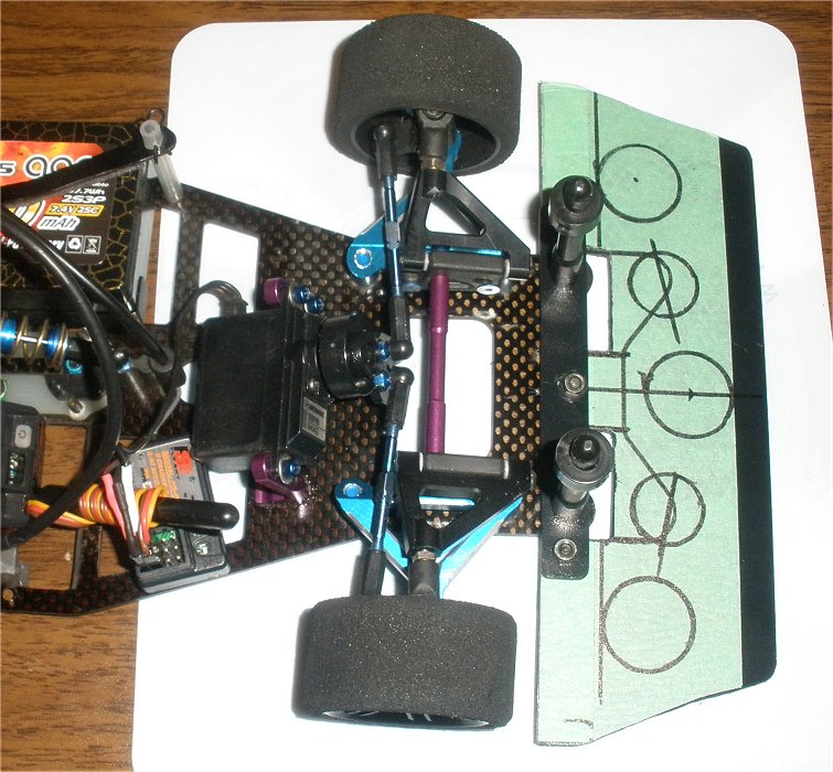

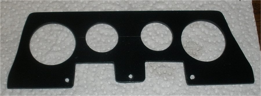

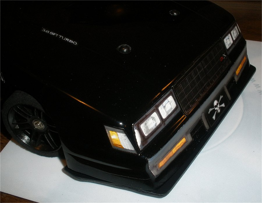

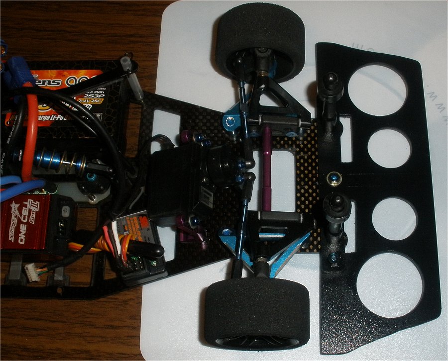

Custom front bumper finished
I needed a bumper to protect the body because the only thing I had for RC12L3 parts were these triangular plastic spacers that mount underneath the body posts and protect the chassis plate corners. I had to fabricate a bumper out of spare Kydex that would mount to the existing chassis plate holes, but also stick down just far enough to protect the chassis plate. I also got around to shortening the body posts to better suit the GNX body.
I'm gonna have to struggle to get this completed before the upcoming month's 1/12-scale pan car challenge.
After giving it some thought and some sketches and careful measurement, here's the bumper test-fit:
And the completed bumper, after some minor trimming with a Dremel and lots of filing & sanding the edges, and removing some sections to reduce weight:
