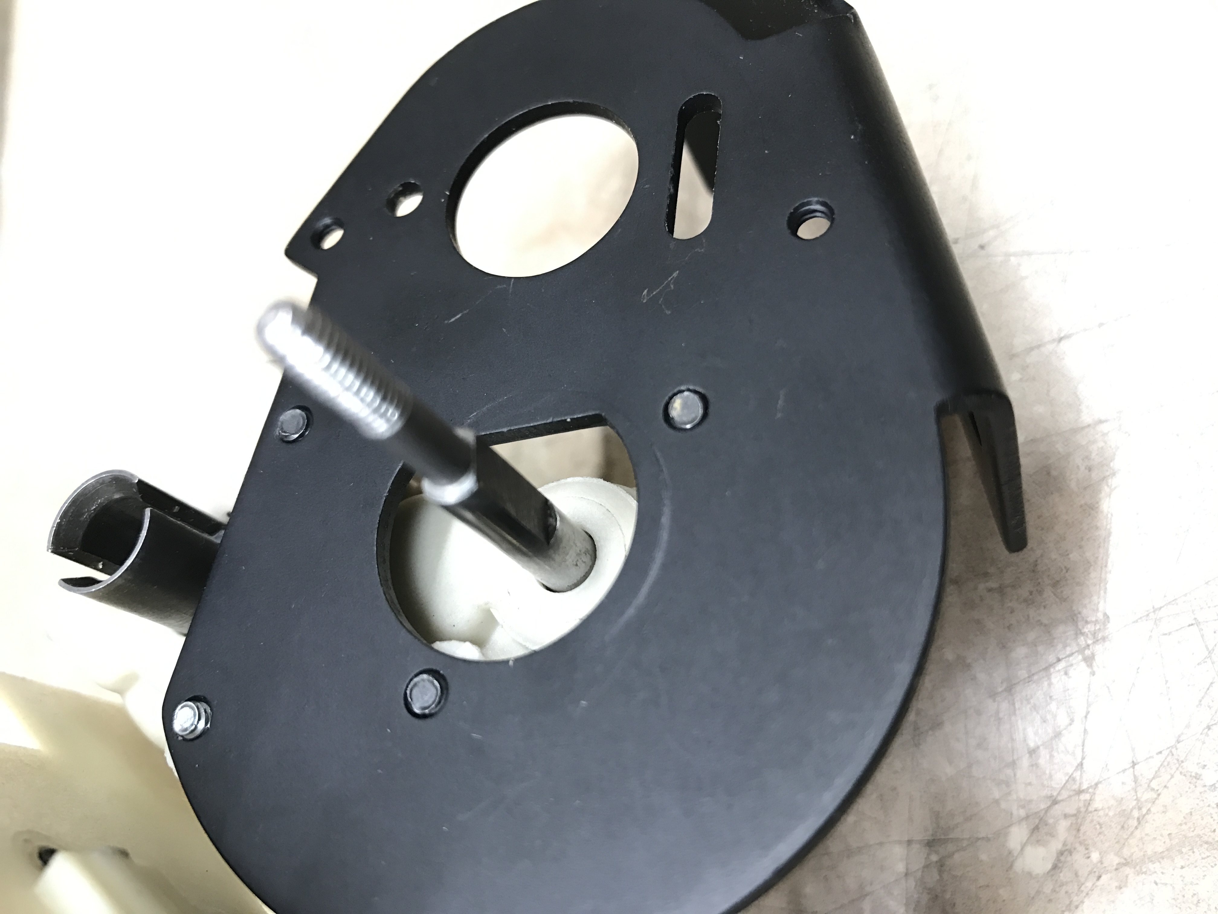

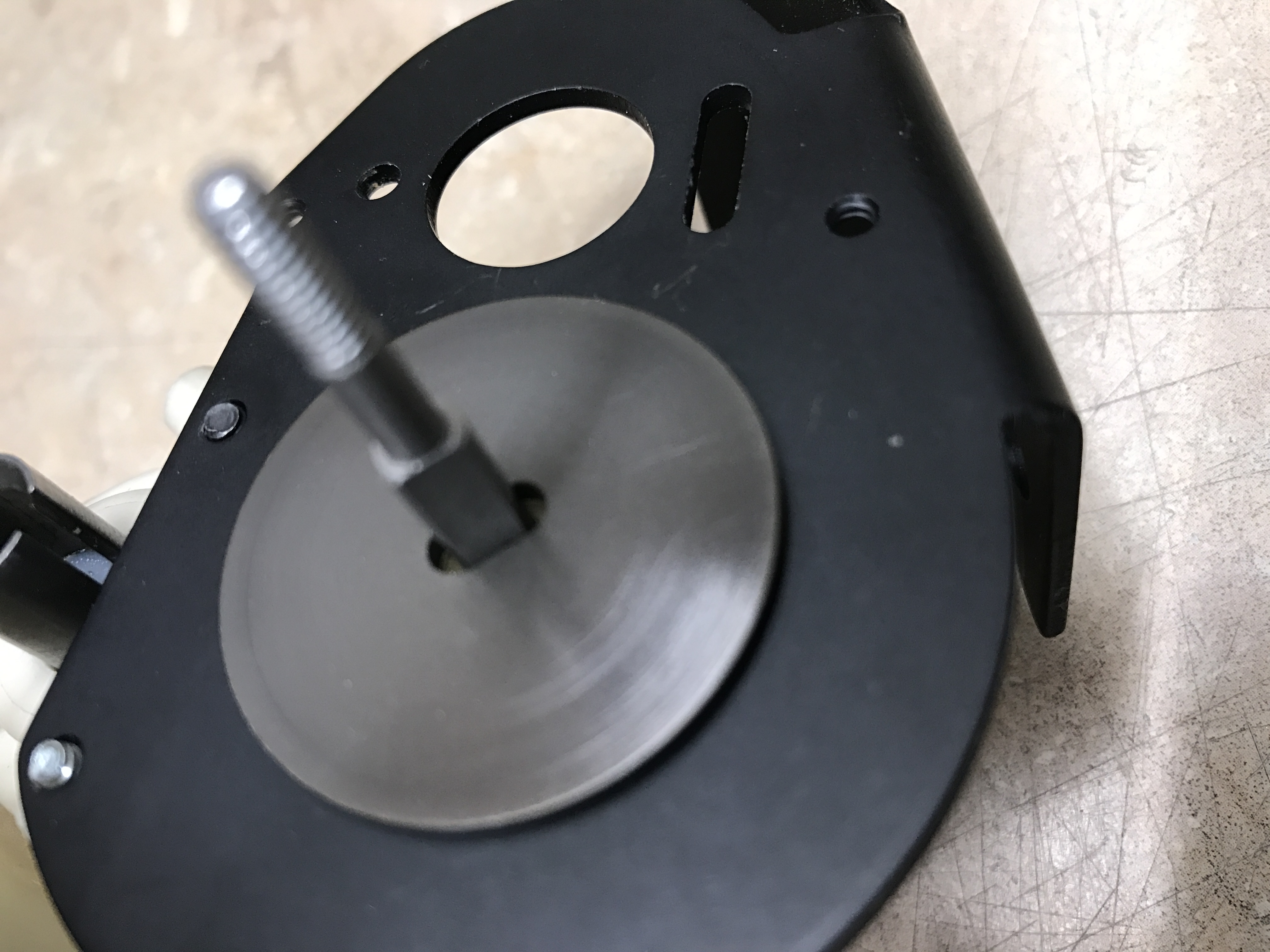

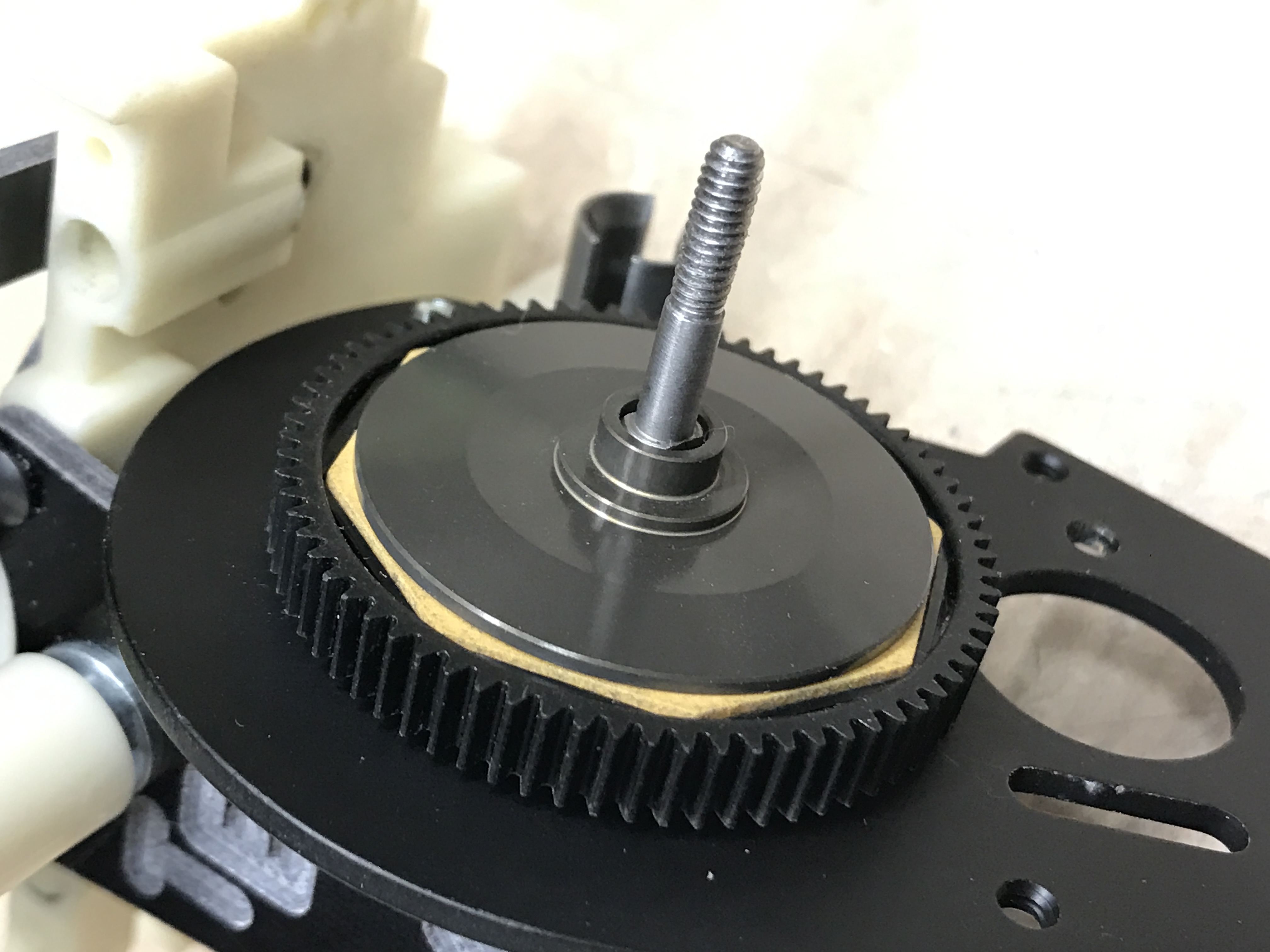

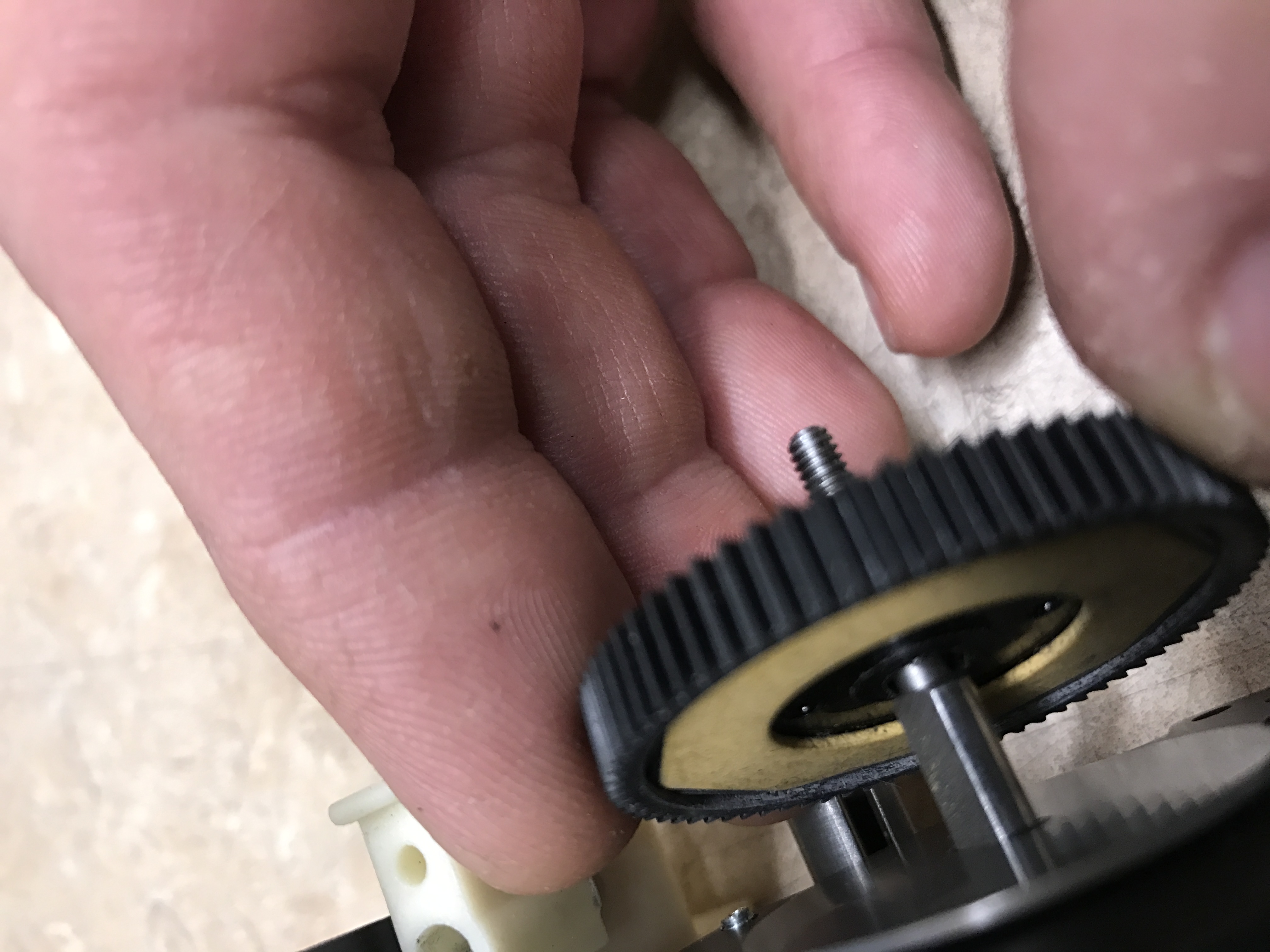

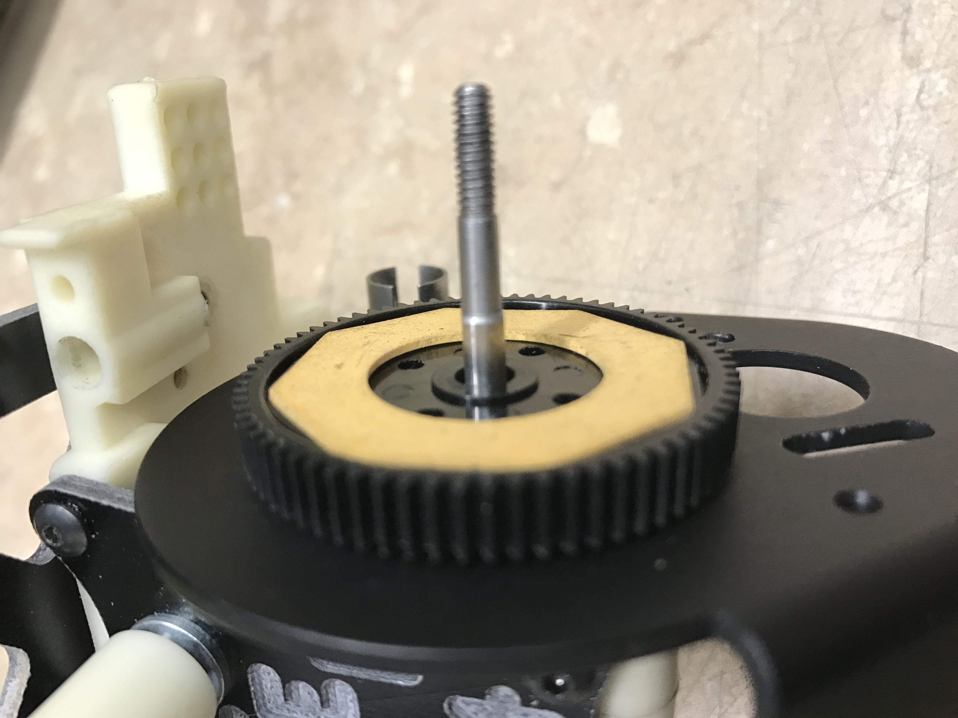

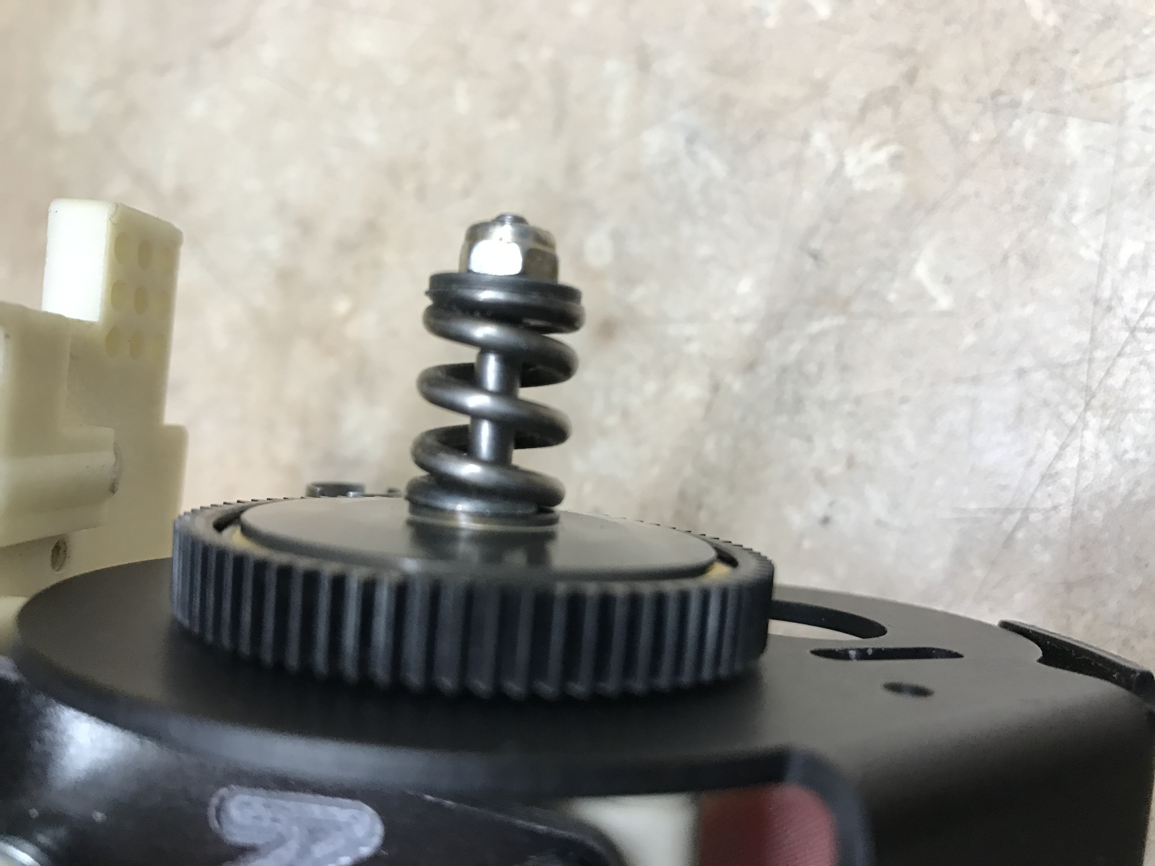

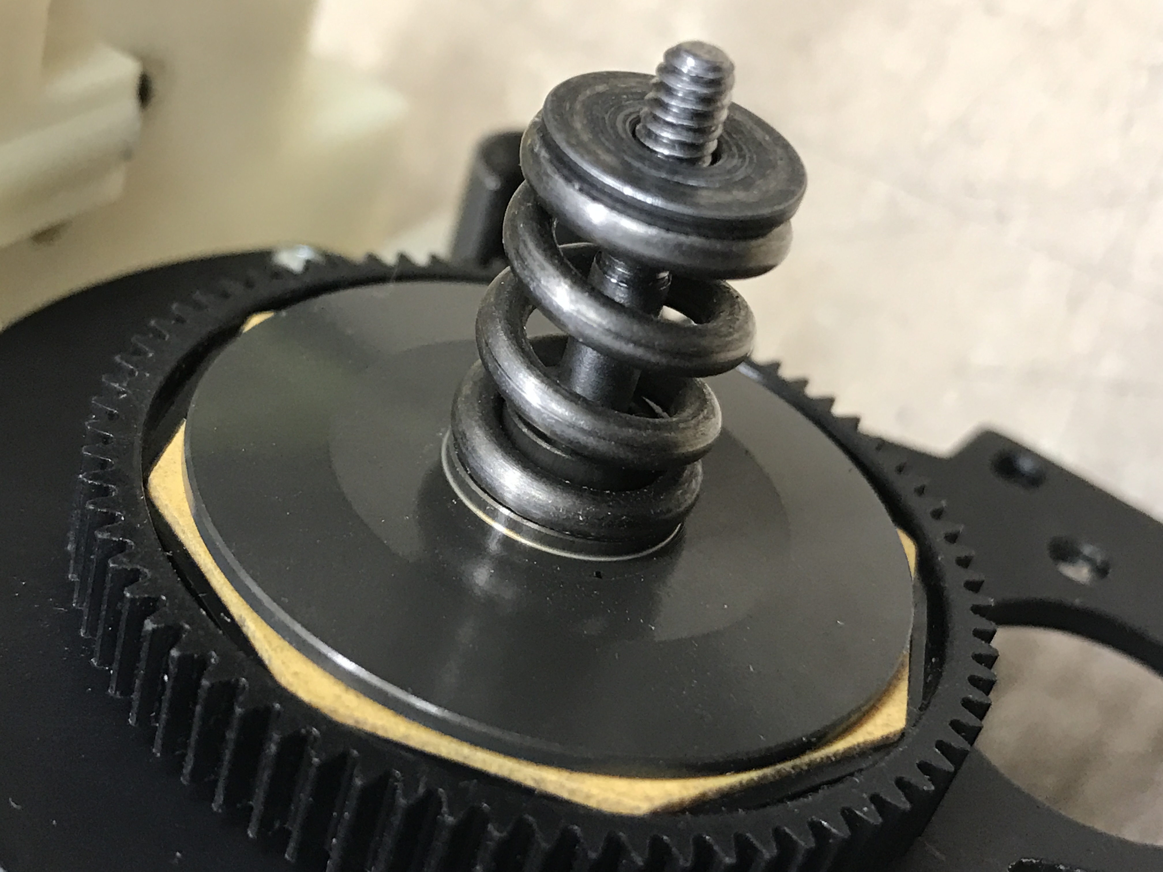

Some progress! But still issues w/ the slipper.
I want to thank GoMachV and Sc8p for spending part of their Sunday with me!
Now to the slipper. After GoMachV's hints, I did get the spur to operate correctly but realize the pad was not aligned property so I took it apart. Now I can't get it to work properly. Some pictures:
As you can see, the diff nut is pretty tight but yet my spur is still loose and spinning freely. The hubs seem to be seated properly and the pads seem to be nested within the grooves of the spur gear but yet the nut, washer and spring cannot get tight enough for the spur to turn the gearing. I've tried as evidenced by some stripping (need to get nut drivers instead of using pliers.)
Thoughts?
PS...How the heck do people put the wing tubes in w/o some mechanical help?
Thoughts?

- Posts: 12336
- Has thanked: 1129 times
- Been thanked: 3919 times
Re: My RC10 World's Re-Re Pre-Build Q's
I'm not sure exactly what's going on there. Here's mine, as you can see the nut is not on very far and plenty of threads left.
Ok. Thanks. I just think the sandwich between the slipper hubs aren't set properly but I can't seem to figure out exactly what the issue is...Almost like the pads are too slippery or not entirely set within the nesting of the spur but that doesn't seem the case..Very weird. I'll continue to look at it. I just don't want to strip the nut...

- Posts: 12336
Yeah its way too tight in the pic, but if the spring isnt compressing then there is something not right. Id start over, and make sure the pads are in the right spot and the slipper hubs are keying into the shaft correctly.
So, if you spin the topshaft the trans will spin. But if you hold the topshaft you can easily turn the spur?
OK, will look at it again.
If I spin the topshaft, everything spins correctly. If I turn the spur only, nothing else spins. I can hear the friction of it touching the pads but that's it. Topshaft doesn't spin.
I wonder if the spring is too compressed? Could be from my messing w/ it too...
Wow that's weird. I took mine apart and reassembled with pics. See if you can see things that are different as you follow my pics...
I may be taking a shot in the dark here, but doesn't one of the slipper hubs have a notch in it so that it "keys" onto the top shaft? I don't remember if both slipper hubs have that key, or only one of them. You might re-check your slipper hubs, and see if one of them has a flat keyed area that locks into the corresponding shape on your top shaft.
