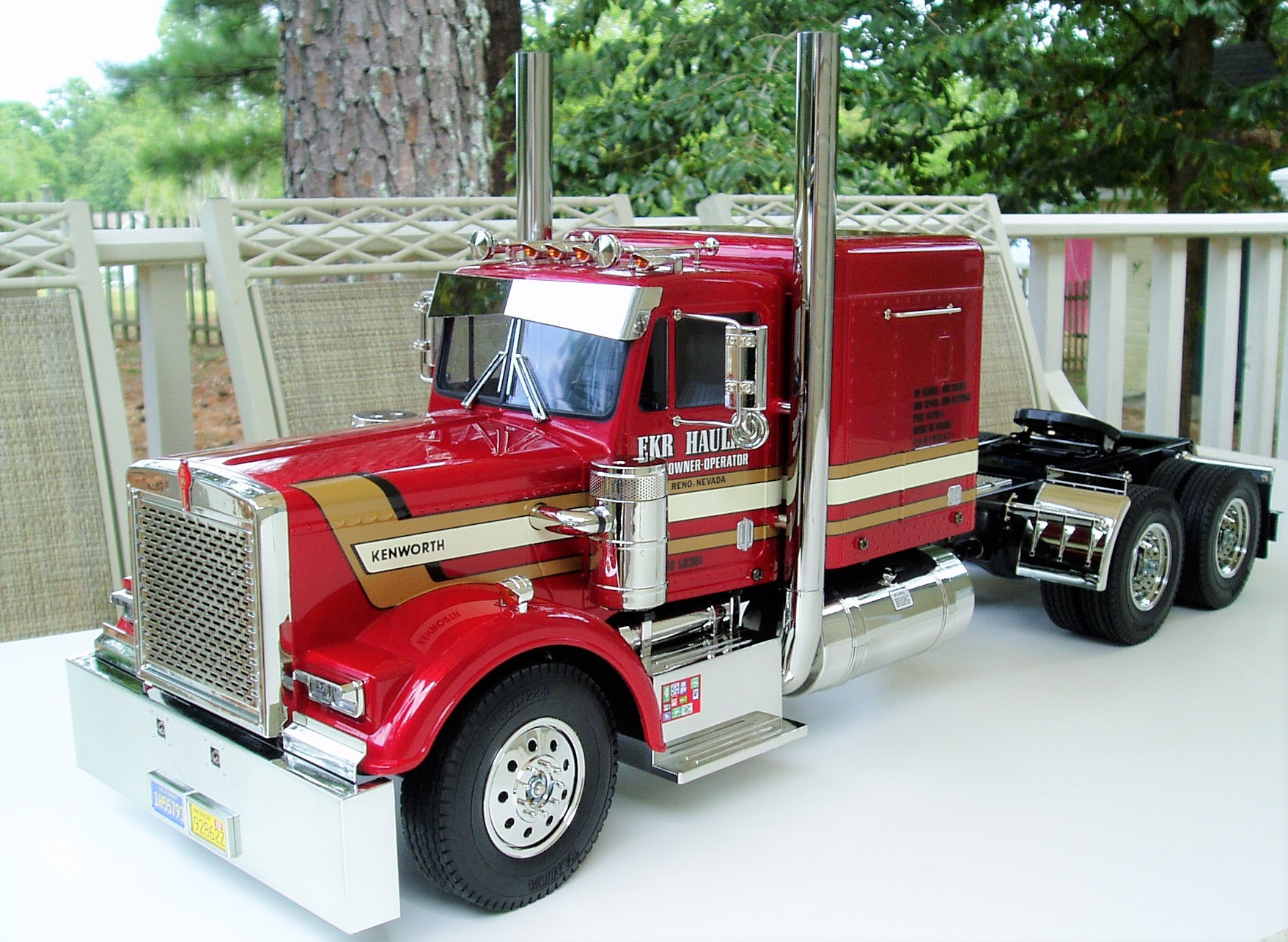

Anyway, clear gloss is your friend. So far, I've used it for all my hard body projects. Sanding and polishing can be tricky however. The most difficult polishing project I've tackled so far is this Grand Hauler. To sand and polish around all those rivets without removing them was a bear.

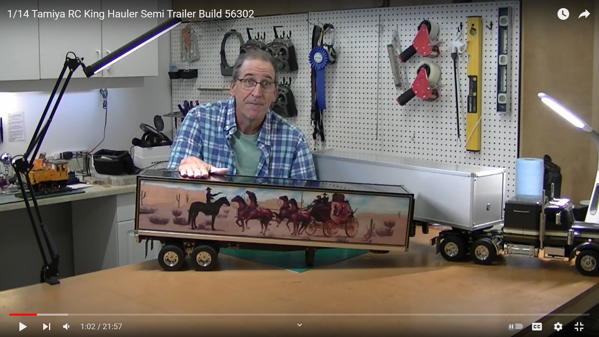

A little bit of staging could make the difference in scale disappear. You could mount the big rig up on a shelf with the Bandit low and in front to change the perspective, sort of focussing on the Bandit but with Snowman in the background.

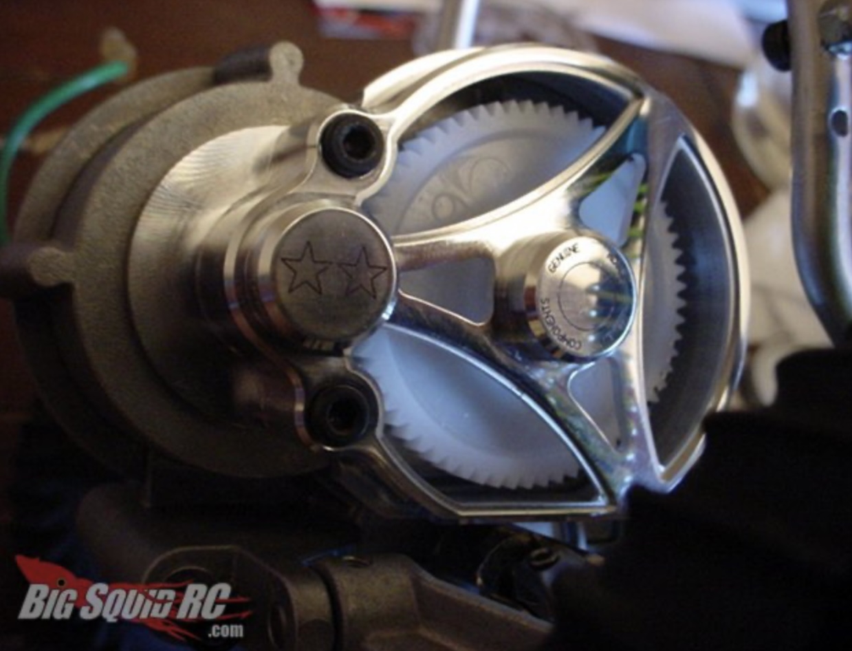

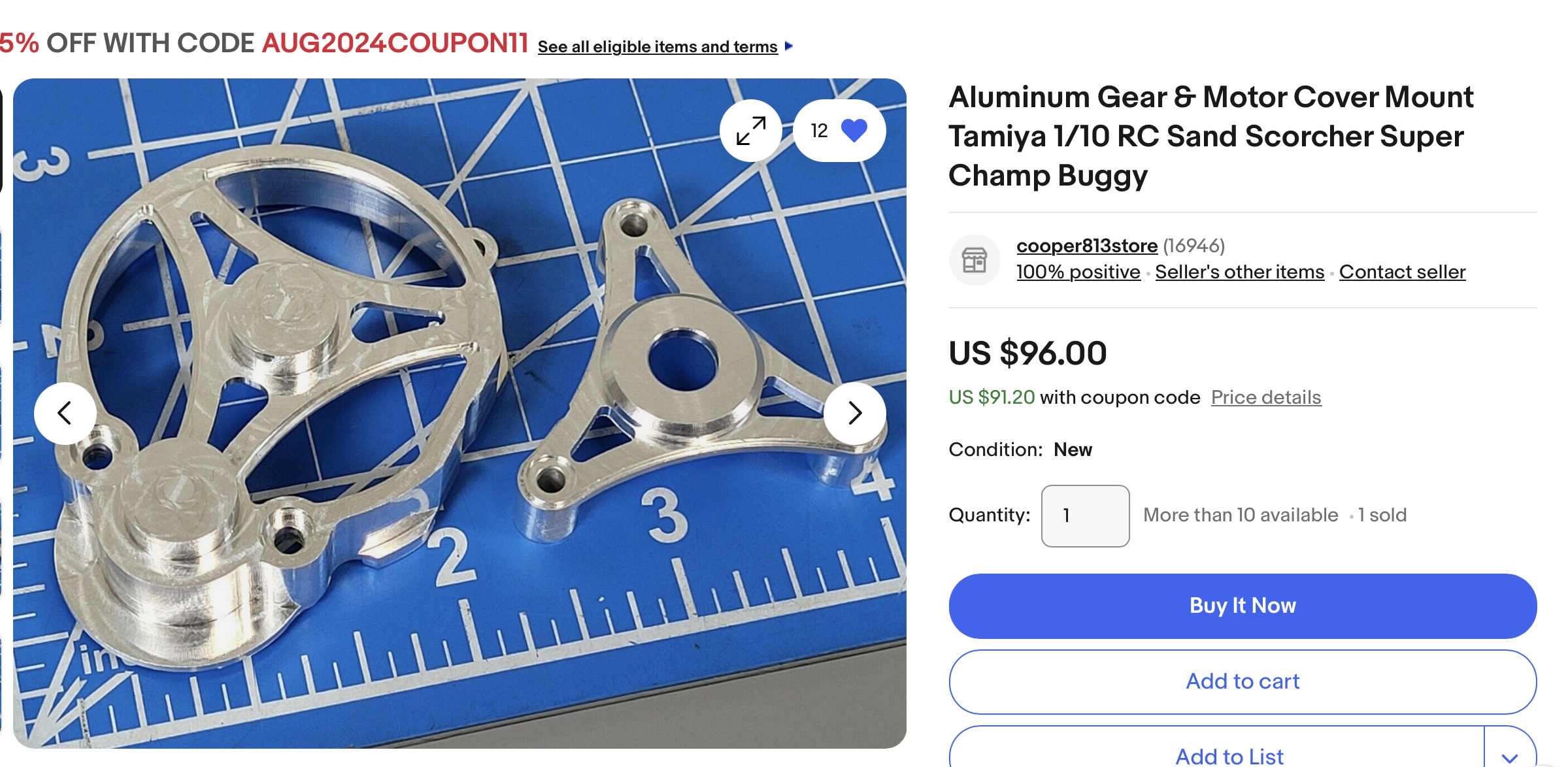

I like what you’ve done on the Sand Scorcher. Rogue Elements made a really cool gear cover. Looks like someone on ebay is now offering it, thought not as refined as Rogues.
- limestang

Thanks! Going to try my hardest to do this one right. That gear cover looks sweet, like the Tamiya double stars! Does it still provide for waterproofing?

The rogue design had a clear plastic insert. Looks like this would have to add this to the one on ebay.
- limestang
