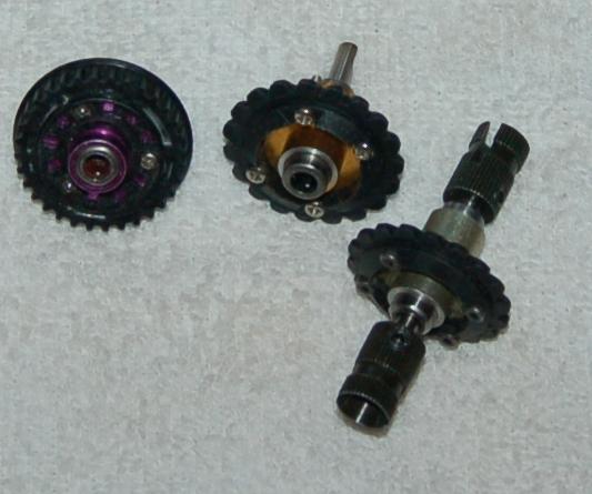

Are these the ones you're thinking of? The purple one is, I think, an HPI/Hot bodies part but the other 2 with the chain sprockets I picked up at my used to be local hobby store where I went to university. I would be willing to bet they've got a bunch more there, if you want their contact info drop me a PM and I'll get you hooked up.ROH73 wrote:If you decide to stay with the chain, there was a one-way front diff available with sprockets on it. I don't know the p/n, but I have it in one of my Turbo Optimas and it really changes the handling characteristics of the car.

OOOOOOHHH YYYYYAAAAAA That is some EYE CANDY. PM sent i hope their still is some around thanks for picture..
