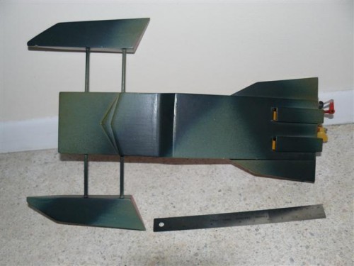

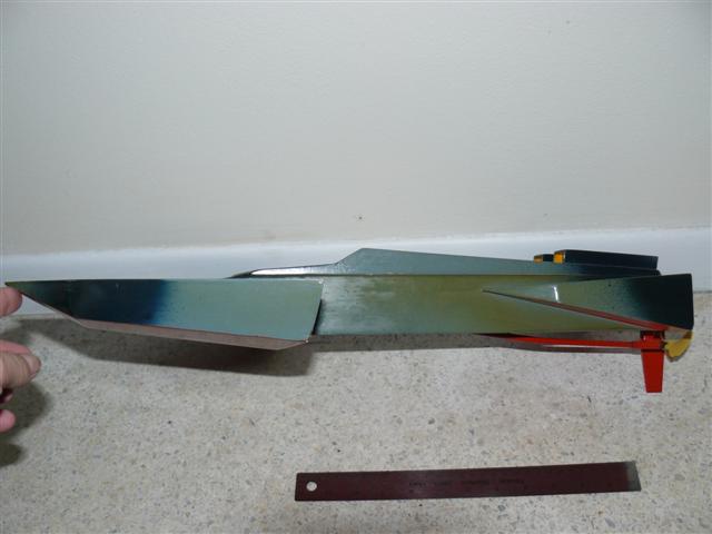

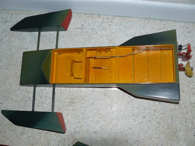

And I don't mean to hijack your thread but a couple pics to inspire your build the ruler is 12".
It would be for some real good action pics but if you feel unwilling or unable ill sharpen and balance a prop for you, please keep it two bladed or let me know the size as I may have one prepared when you get to that point.
