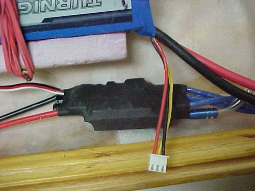

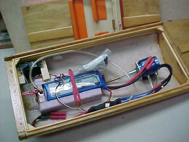

Alight, I've been meaning to get a boat since moving to a house with an inground pool about five years ago. Well I finally won one yesterday that met all the criteria I was looking for. :D Now I have a few problems. The first one is can anybody identify what model this is? The second is about the electronics.
I've figured out that the motor is a Turnigy AquaStar 3650-3500KV, and the ESC is a Turnigy Marine 60A (part # TR-M-60A) The problem is this ESC seems to be nearly non-existent. I'll need to know how to program it or if I need to buy anything in order to program it. I really don't want to spend the extra money but would it be in my best interest to just buy a new ESC?
What controller/receiver combo would you recommend I get.
What type are the reddish connector ends on the battery and ESC? I think they're called HXT?
Last but not least, what charger would you recommend I get? Believe it or not, this will be the first time I've run an R/C with a LiPo. :o

There's not much help I can offer but that will too fast for a pool, unless it's massive.
Ditch the HXT connectors, they are dangerous as you can plug battery into battery, and are a pain to solder and seat in the plug.
The Imax B6AC is a great charger for the money.

can't help anymore than RJ already did but like he said...definitely ditch those connectors. I cut all mine off and use standard old deans on my boats. That way I can run whatever batteries I have charged :wink: .
Also thinking that you will have to dial back the throttle to nonexistant to be able to control it in a pool. My first brushed boat that I ran on some old wore out nicd packs was even too big for a friend of mine's 50 square pond.

Agreed on the Deans, I'm still old school and still prefer them. If you can find genuine Deans use them, there are many many many cheap chinese copies out there that aren't very good. Boats are notoriously hard on plugs and motor/esc's.
If you figure out how to program the ESC the most crucial setting is the lipo cut off, but be careful as if you have to dial the throttle back far enough like Todd said you could miss the cutoff and run the battery too flat. Boats also almost never have reverse because it usually pulls the back of the boat down into the water, so if you end up with a boat that has reverse, turn it down to the lowest setting.
Just make sure the receiver is in a balloon and make sure the hatch seals well, waterproof tape is normally used but I'm not sure on a wood boat.
