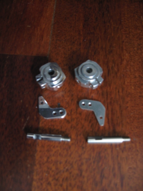

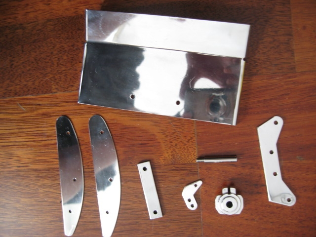

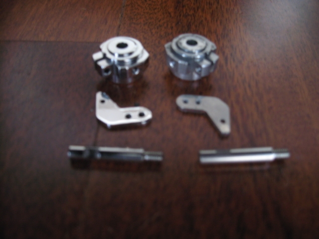

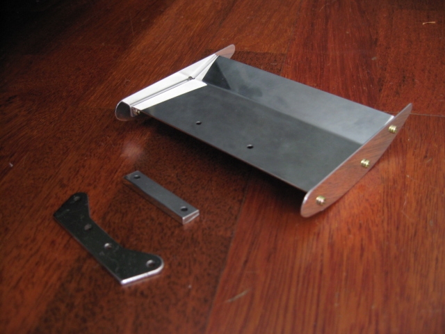

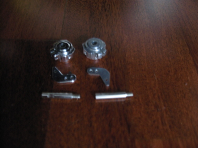

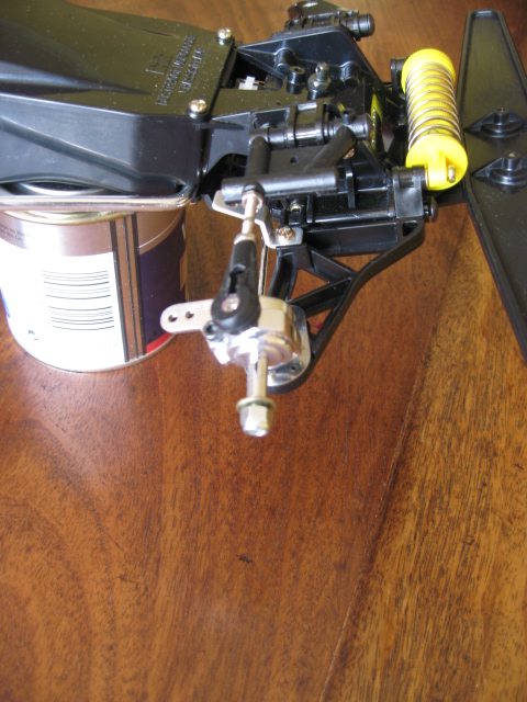

Ok. Just a quick update on this build. I have this weekend been able to dig out my polishing kit and have put it to task on my Dirt Burners aluminium wing, Dirt Burner aluminium front uprights and You-G rear shock mount. Wheels have yet to be done - I'll need to high grit wet/dry paper to get these to a suitable polishing point. Here some pics:
Here are the Dirt Burner uprights. On the left is the polished item and on the right is the item as it came NIP:
And here is the Dirt Burner wing put together, with its aluminium mount and the rear shock mount. All look nicely polished and ready to be mounted in due course:
Next time I will hopefully have done the wheels, nerf bars, anti-roll bars and the remaining front upright.....will keep you posted!Re: Not just another Fox Resto...!!

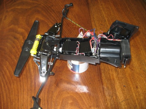

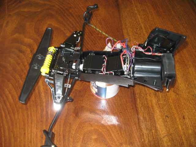

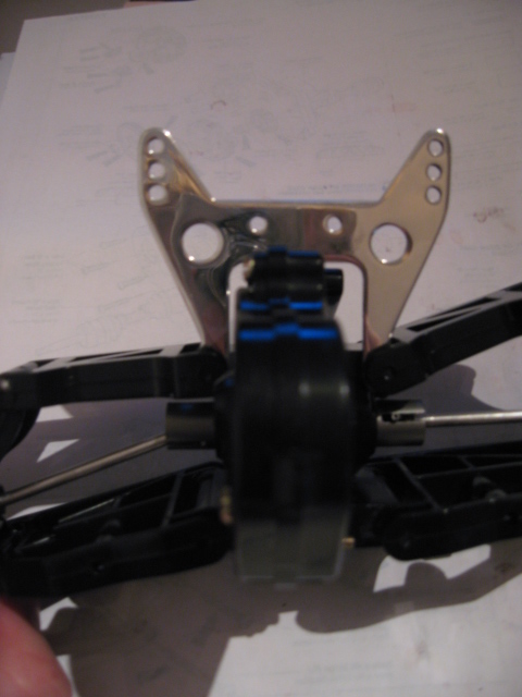

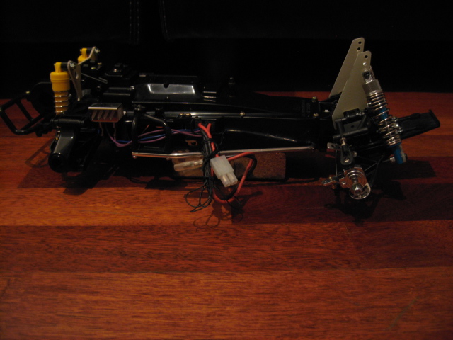

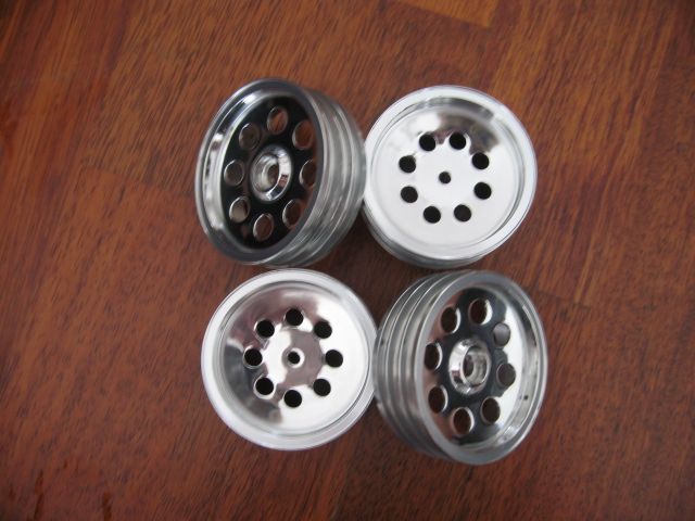

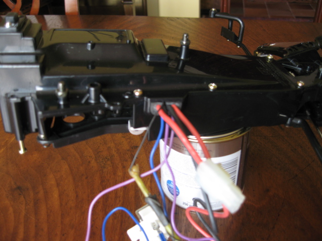

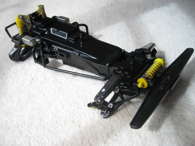

So....it has taken me quite some time to progress this build but having just had some time off work I have managed to complete it. Much of the time was taken up polishing all the aluminium bits such as the wheels, resistor covers, nerf bars, rear shock mount, anti roll bars (front and rear), and front uprights. Polishing time was probably more than the build time itself. Anyway here's the build as it happened in chronological order:
1. First the wheels were polished - this took a while but the end result is quite unique, I think, for a Fox: 2. Next came the installation of the electrics. These were taken out of my existing Fox which I had from when I was 11 years old. That car has a broken chassis and many worn out parts so I've used it as a donor car where necessary in order to keep this build as a "restoration". Hence all the electrics (Accoms Techniplus) have been removed from the old car and installed into the new chassis. As you can see, it is quite a tight fit. It is also not something you want to get wrong as getting back into the Chassis once it has been put together is a pain in the @***! 3. Then it was time to move onto fitting my first hop-ups. These were (i) the Parma adjustable front suspension arms - adjustable for caster and camber - and (ii) the Thorp front uprights (polished): So the above should assist with fine tuning the steering - i.e. oversteer and understeer - and add some strength to the front end.

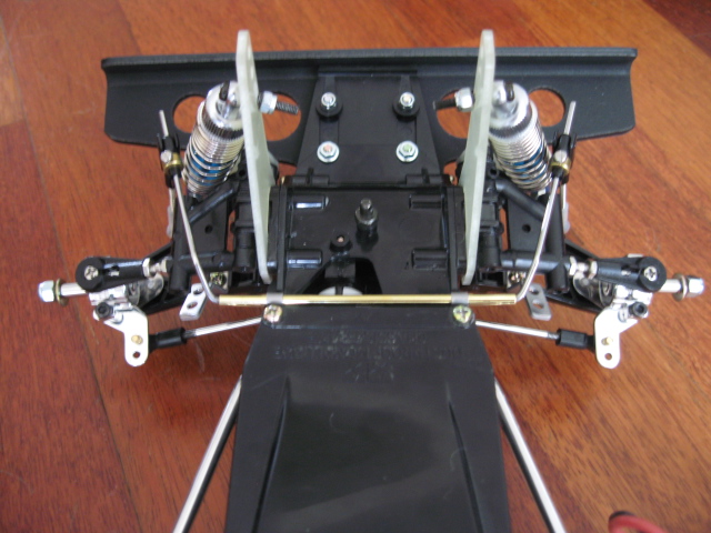

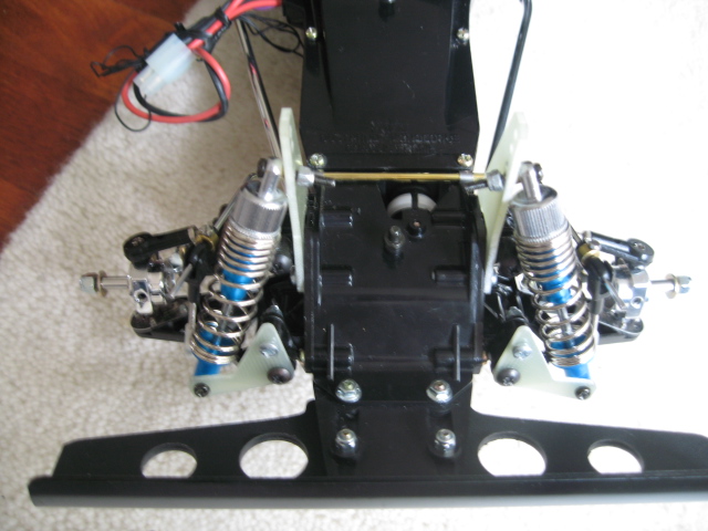

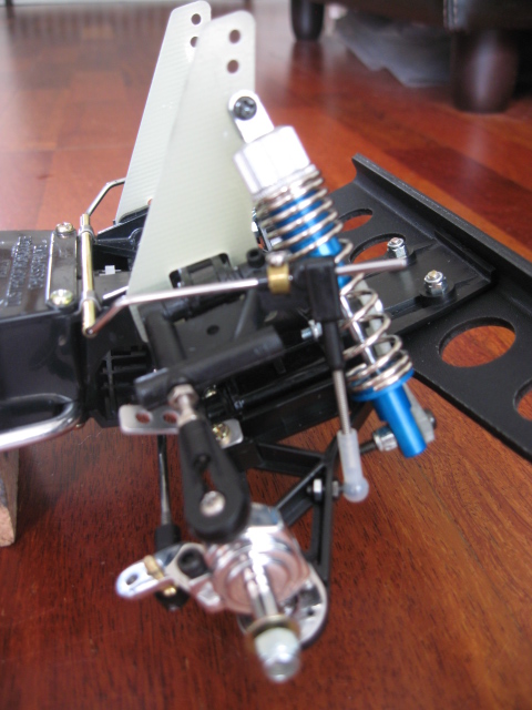

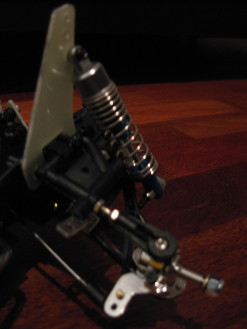

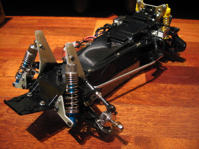

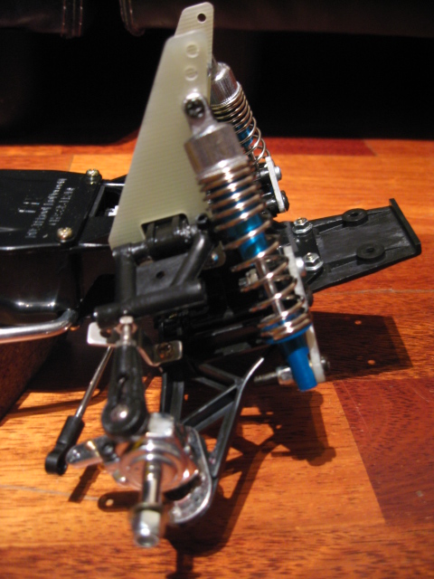

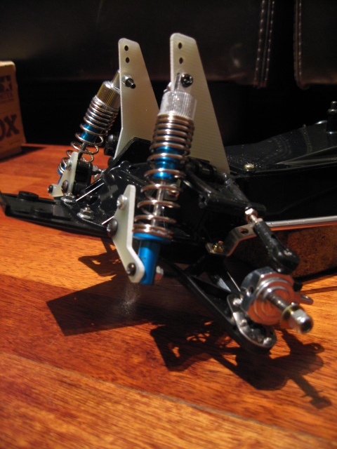

4. Now came the bit I was really looking forward too as it is so unique for the Fox; the fitting of the JG Dual Shock Conversion Kit. I have never seen a Fox with the dual shock conversion fitted. Having mounted the fibre-glass mounts and made up the You-G Shocks I noticed that the pre-drilled holes in the shock mount were too high for the You-G Shocks. This is because they were designed for Kyosho long shocks. However, I was adamant that I was going to fit the You-G Shocks because of their quality and their colour scheme (which, being blue, suits the Fox). So to fit these shocks I had to drill an extra hole into each shock mount at a downwards angle so that they would fit correctly. The end result is what you see below:
Some more pics of the dual front shocks mounted:

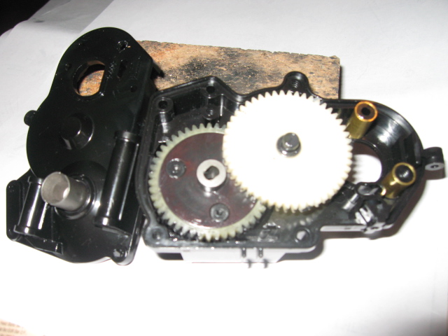

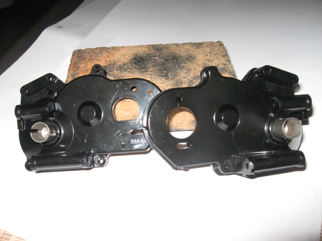

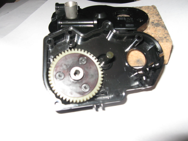

5. Now onto the gear box and the fitting of the Thorp dog bone drive system and Paranoia adjustable ball diff. Ball races are used throughout the gearbox (as with the rest of the car too). Here is a picture of the rear inner thorp axles fitted to the gearbox:
....and here is pic of the Paranoia ball diff fitted. It's adjustable by way of the srews in the side which adjust the pressure of the pressure plates either side of the balls:
....and here is a pic with the gears assembled in the gearbox, which is ready to be put together:

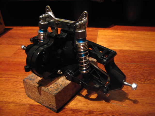

....and to complete the Thorp dog bone assembly with rear suspension:

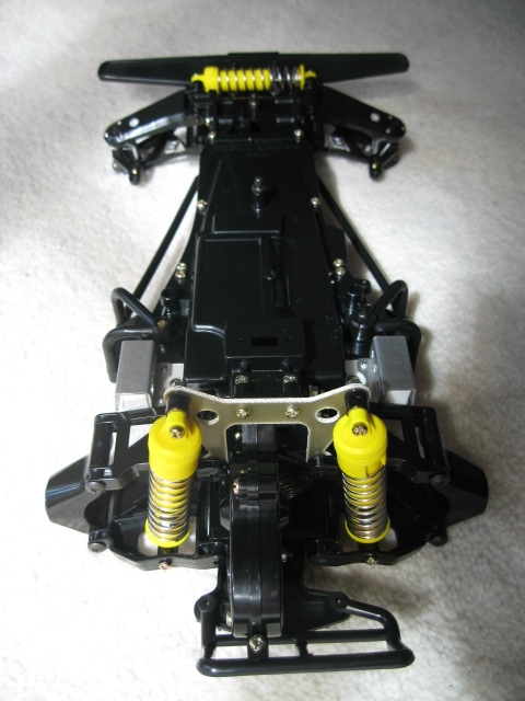

You will notice that in the last picture above I have also fitted the CRP aluminium rear shock mount which I have polished up....Re: Not just another Fox Resto...!!

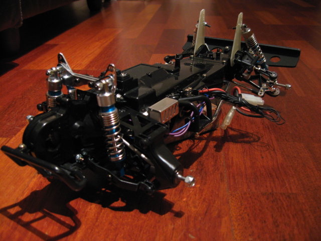

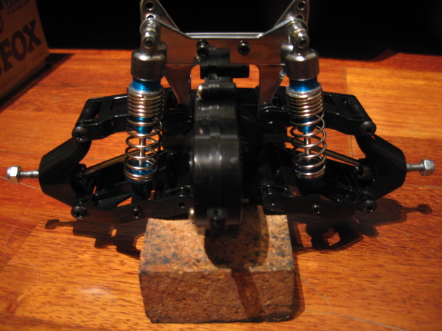

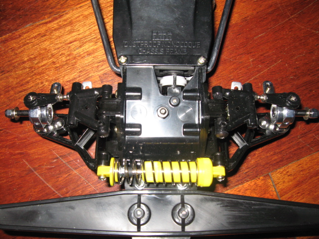

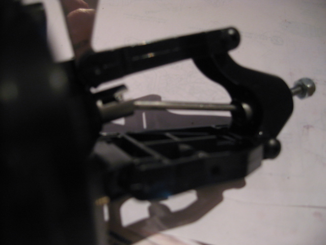

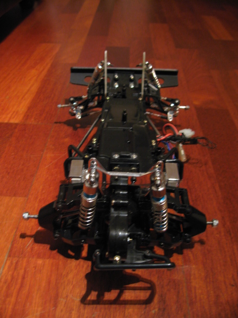

6. Next job is to fit the rear You-G shocks and mount the rear end to the chassis. I really think the You-G shocks are top quality - a bit heavy but the cylinder, piston and springs display top quality and the adjustability of the spring rate is achieved by the threaded aluminium shock collars:

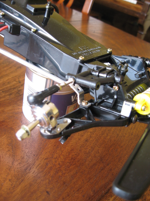

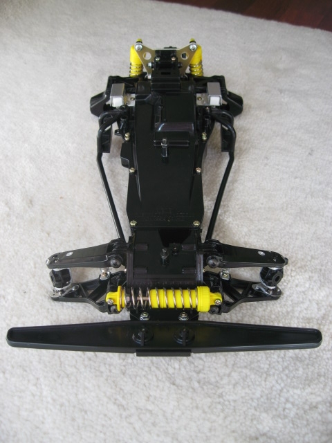

7. So it was now time to fit the CRP front sway bar. This required trimming away some of the flange of the chassis that rises up towards the front end from the main chassis box. I also trimmed down the area where the screws hold the front sway bar mounts as the mounts are fitted between the top half of the chassis and the bottom half of the chassis. Holes had to be drilled into the lower front suspension arms on either side so that the adjustable track rods could be fitted:
...with rear end mounted to chassis:
Note the Thorp front bumper fitted too - much more sturdy that the original - perfect for putting up with those other bad drivers on the race track....7. So it was now time to fit the CRP front sway bar. This required trimming away some of the flange of the chassis that rises up towards the front end from the main chassis box. I also trimmed down the area where the screws hold the front sway bar mounts as the mounts are fitted between the top half of the chassis and the bottom half of the chassis. Holes had to be drilled into the lower front suspension arms on either side so that the adjustable track rods could be fitted:
