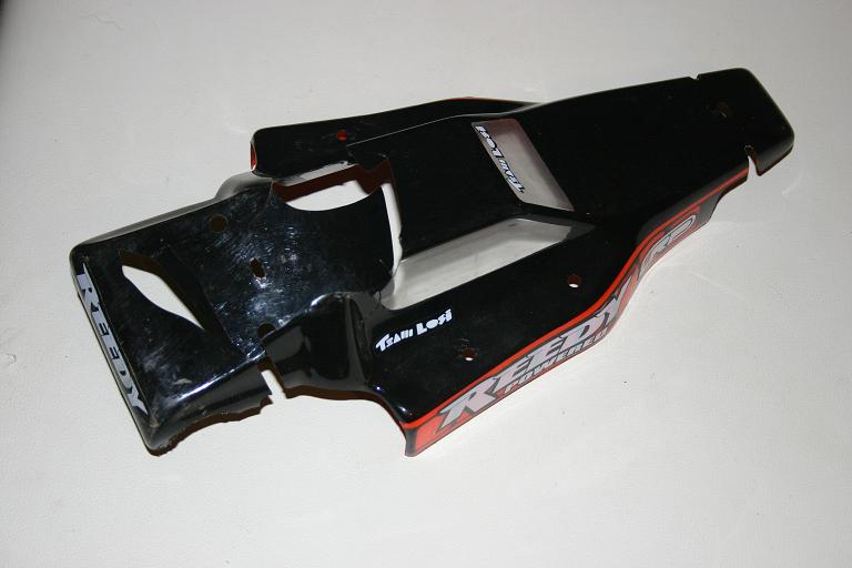

If you plan on running it forget it.My JRX2 body got busted up after the first rollover.
Re: Teambluegroove's repro bodies - quality?
The Lexan is thick, cut lines indistinct, windows near invisible, no masks, and the corners too rounded in my experience. That was on a JRX2 body. Do yourself a big favor and buy from Mr.Lexan, Brandon G or Marwan.
Gary
- Posts: 748
- Joined: Wed Aug 26, 2009 3:43 pm
- Location: Syracuse, NY
Jeez, I've never seen Lexan crack like that, even old stuff that's been beat on for years. Especially not on a buggy body that doesn't flex much anyway. I'd guess it wasn't even polycarbonate (generic name for Lexan, which is General Electric's version).

I've only had Mrlex bodies A++++, there is another plastic that can be used, they kind the make soda bottles from that cracks on impact like that-but I have personally bought GE Lexan for EDM bodies that shattered too (maybe a bad run??)

Clear beverage bottles are made from PET or PETG; both are less brittle and more flexible than polycarbonate. PET and PETG are not as good optically, however. My guess is that Teambluegroove is simply using the absolute cheapest grade of polycarbonate out there. Other possibilities are clear polystyrene or clear PVC, both of which are very easy to vacuum form (and they absorb very little water, so no drying is needed), but are brittle as can be.

I can bare witness to James's X2 shell busting on its first roll over. Quite sad considering it was his vintage racer for the last big meet in Sydney.
Team blue groove need to re-investigate the materials they are using.

Having just painted up one of their junior-2 shells I can say that the material looks, feels, and generally behaves different from most other bodies I have painted. The material seems a little softer/easier to flex from its formed shape while handling. When scoring the trim lines then bending like usual, it doesn't give a good sharp snap and clean edge like lexan of the same thickness seems to do.

Basically, he is using a material that forms easier and is cheaper than lexan. Probably petg like mentioned above. But it is NOT lexan that he is using. Doesn't make sense, cause if you buy in larger quanities, the price on lexan isn't too bad. We bought a 2 4'X8' sheets of .030 lexan and had it cut to size by the supplier. When you do the math, we were paying around $4 per piece after purchase, shipping, and cutting. And the pieces were 22"X 16". No excuses there.

If it's PETG, it's the worst grade ever. While building my vacuum former, I did many of my experimental pulls (from a Viper mold) with .030 PETG and did some rather violent testing with a ballpeen hammer on several of them. I also did this with my .030 polycarbonate experimental pulls. In my experience, the PETG fared even better than the polycarbonate; I could not break the stuff.
In any case, maybe we'll find out. I sent teambluegroove a question through eBay on the material. I'll post the response.

I assume you are talking about me, as far as I know I am the only other one offering them... No offense taken.Lonestar wrote:so I'm not sure I want to dump the cash that's requested by the other providers of 10T repro bodies to get the top-quality ones, without any disrespect to the other guys of course.
In regards to price, with shipping this is the deal. Packaging up a 10T body is very close to falling into the Priority International size standards which is set by the USPS (not negotiable as far as the USPS is concerned) and is more expensive. It seems depending on who you get at the USPS will determine whether or not you are charged for First Class or Priority. If they know me they usually charge me FC, if they dont' I get charged Priority. Arguing with them doesn't work, I have tried, so I have to default to Priority International otherwise it's $15.00 or so out of my pocket for the additional shipping.
If you want, I will do my best to get FC and refund you the difference from Priority. You can ask, I have done this for others in the past. I willing to work for/with you, but I can't guarantee anything. All you have to do is ask...... the only dumb question is the one not asked.
Also on price total:
- I promise mine don't shatter
- You get defined lines in the body, such as the windows, grille, etc.
- You get paint masks
- You get over spray film
- There are no defects in mine. I had one of TBG bodies, and there were waves, bubbles, thin spots etc.
- They are lexan and the same exact quality as those in your LHS..... I did my homework.
