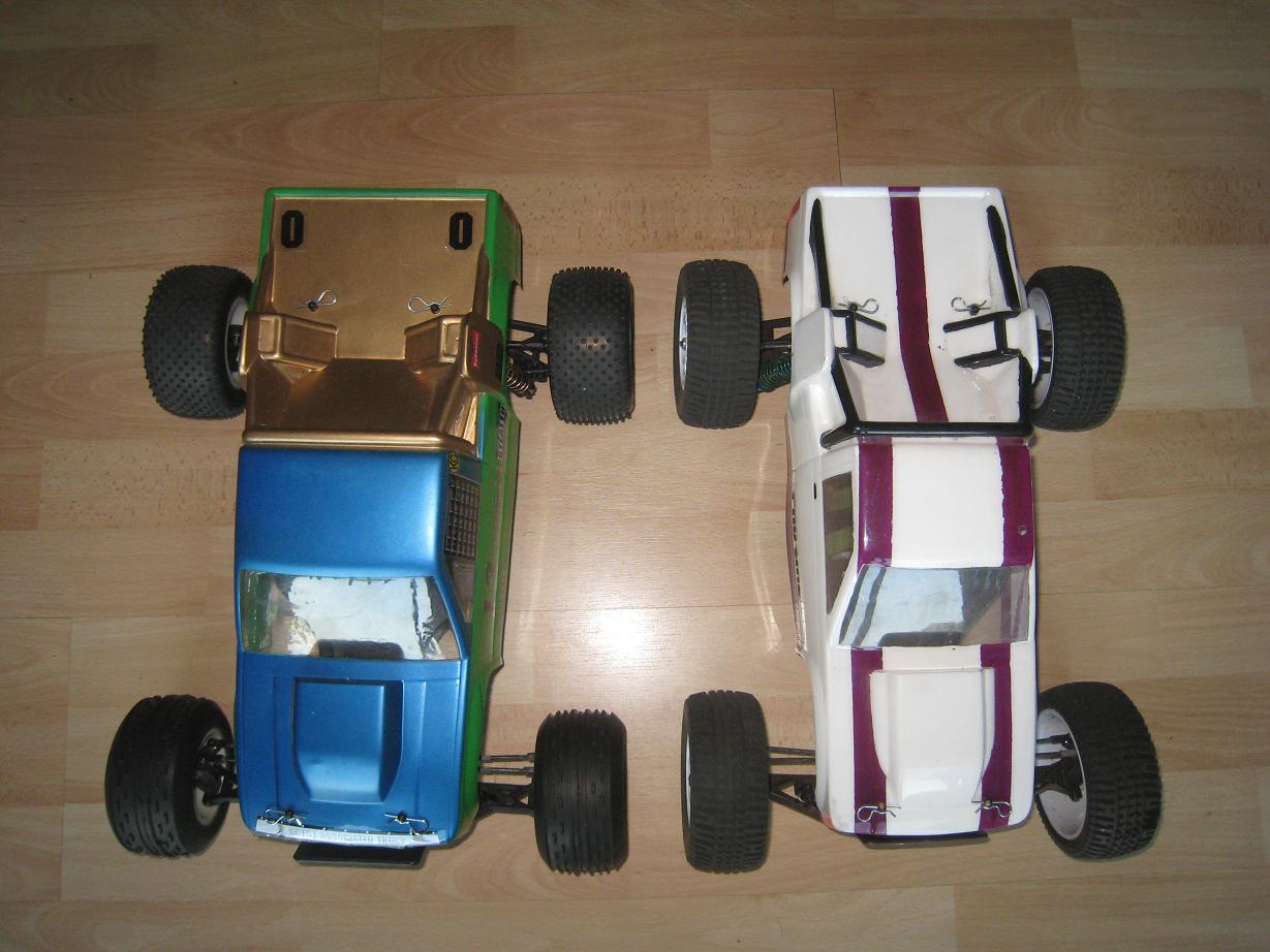

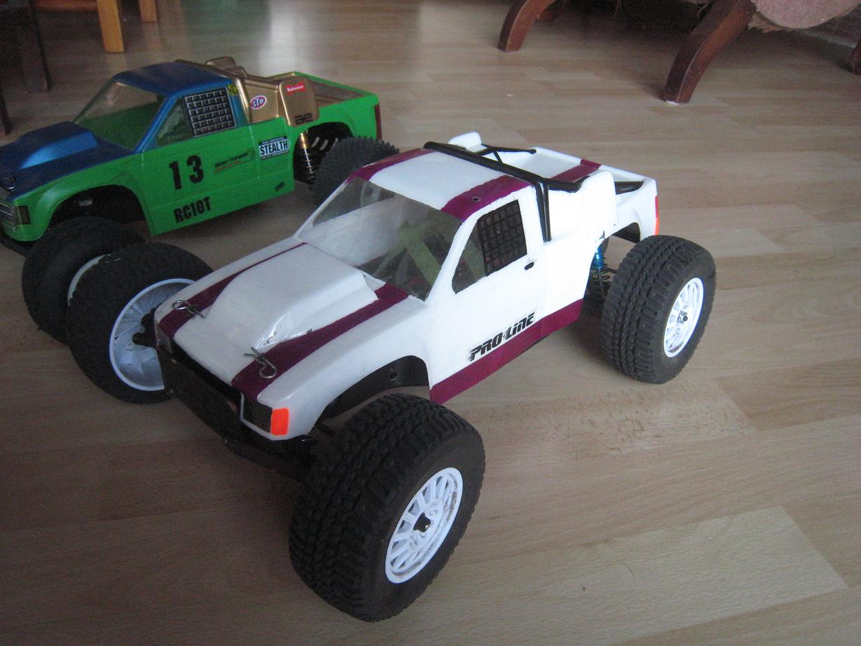

Here's mine the outer diameter of the 3/16 bearings are the same size as your old bearings so they will fit the original hub. Incidentally they are the same size bearings that are in the casing of your stealth tranny (upper two gears) and the same size bearings as those running on your front wheels.
What you will need:
SC10 wheels
3/16 rear axles
6906 3/16" x 3/8" bearings
I bought sc10 3/16 axles and sc10 dogbones on e-bay for mine. You can use 3/16 MIP CVDs.
