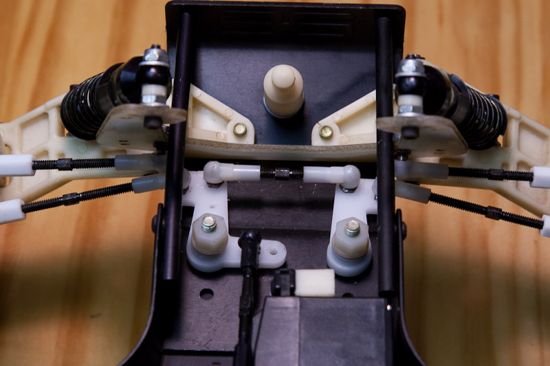

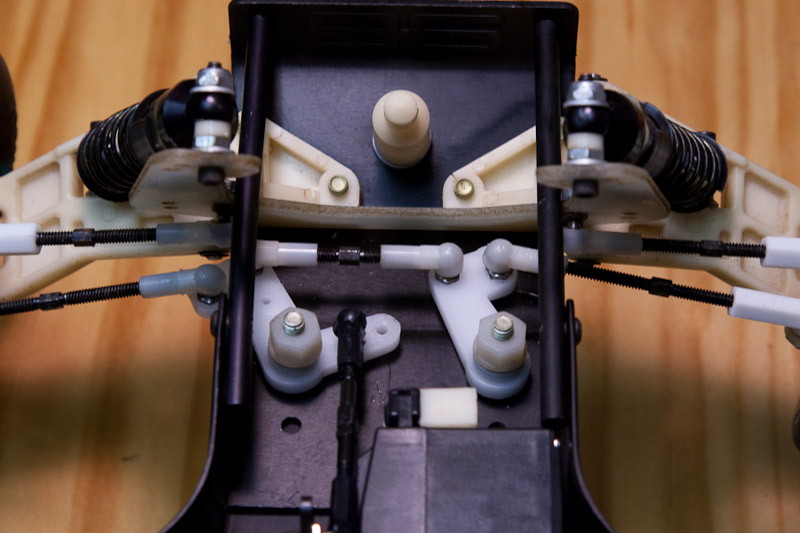

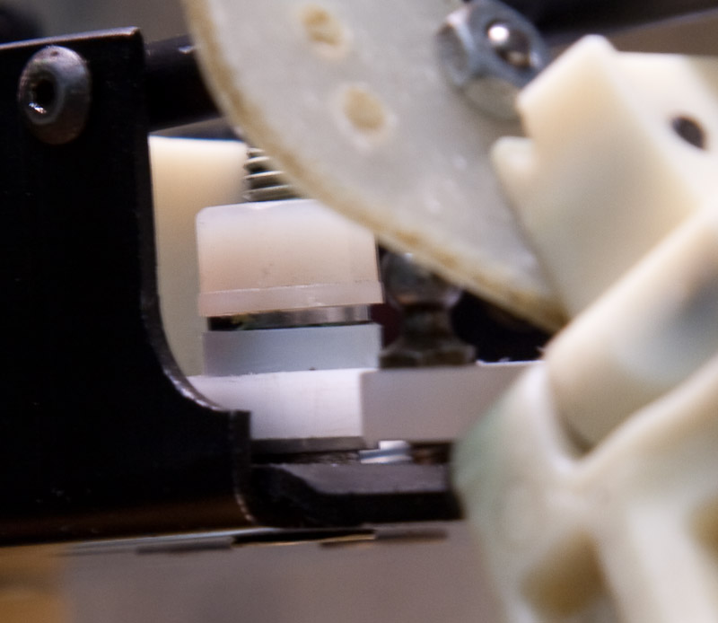

FWIW, I just did this conversion over the weekend. I had to make a few mods to make everything fit without binding. The steering is so much more precise!
First up, thanks to jwscab for the parts list!
Second, http://www3.towerhobbies.com/cgi-bin/wti0001p?&I=LXAFV4&P=7 is the perfect size 3/16 tube to fit over the standard Team car steering screws with no mod required.
Third, I had to trim the bottom of the traxxas parts flush and machine a deeper hole for the bearing so the bearing would fit flush - this lowered everything down to the level of the original parts.
Fourth, I had to find the right size washer to go underneath that I could screw the bearings down onto without binding against the rotating part.
According to my verniers, the steering geometry is identical to the original from my Team car.
Full lock, no binding on the chassis.
Straight
Straight
Side view from the bottom: Washer, 3/16x5/16 bearing, traxxas bellcrank, 3/16x5/16 bearing, original steering nut
