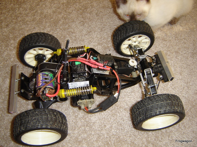

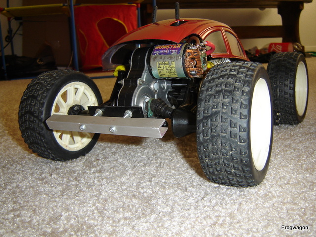

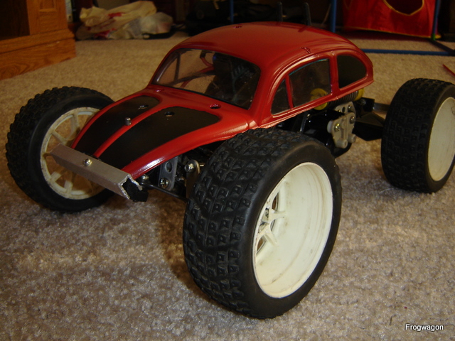

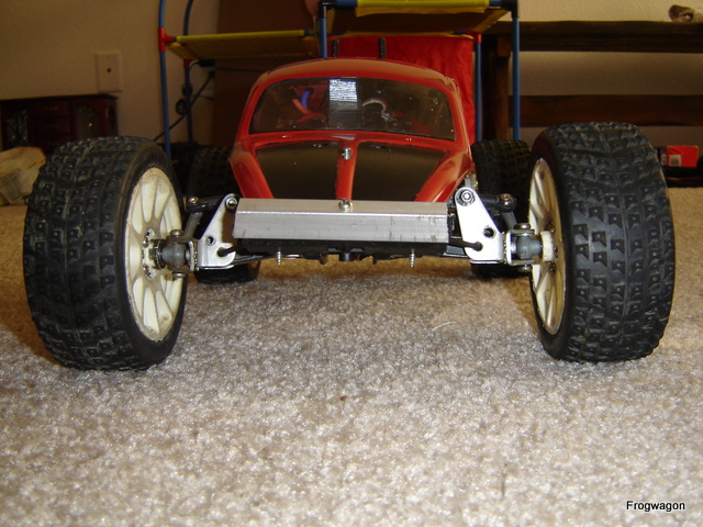

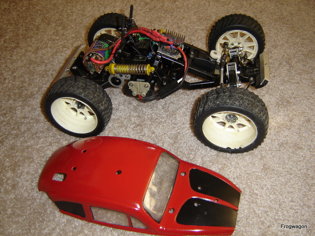

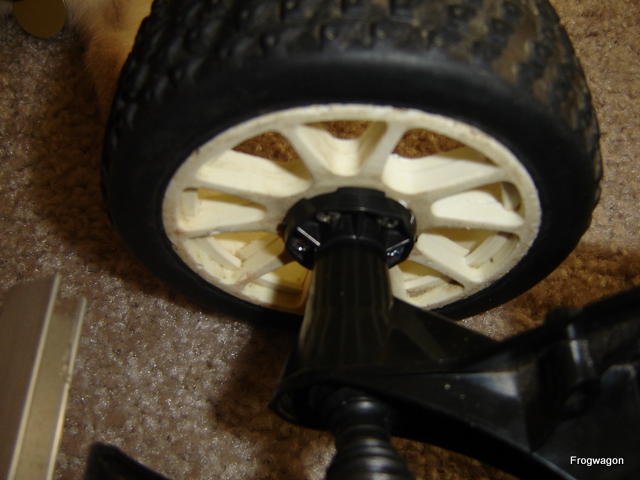

I love my Frog but was fed up with not being able to keep up with my friends Stampede, so rather than buying another RC, with the help of some broken wheels, heres my solution :D

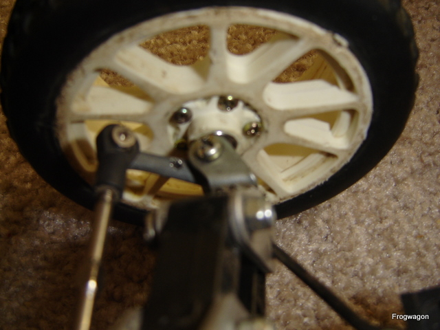

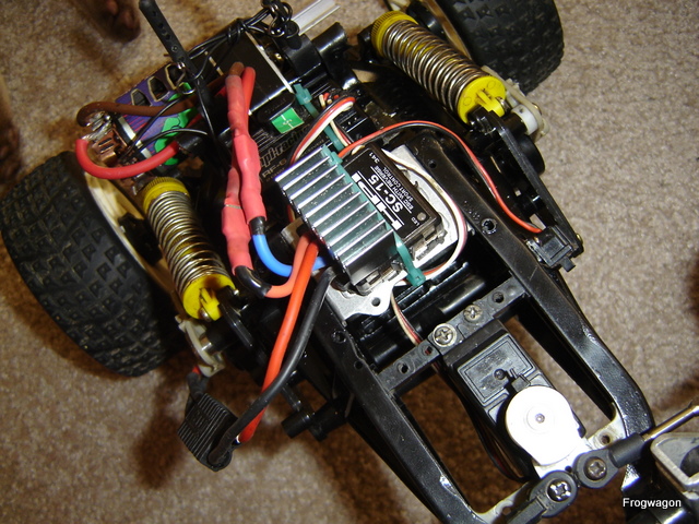

1/8th scale buggy tires make it alot easier to keep up with taller trucks. After replacing the flimsy little stock tie rods(thanks to some members on here), it worked out pretty well! Just a little worried about the stock gears holding up to the bigger tires. Well tell me what you think and what would be good ideas to make that frog "go" a little better.

That's pretty unique!
I wouldn't think you'd have gear trouble, the Monster Beetle & Blackfoot held up pretty good with the same trans set up.
I'd bet the gear ratio was slightly different though.

I'm not sure if the original came with any more spur gears but mine has the 52t in it, mine is from the 80's by the way lol. it i could get the different spur gears for mine that would be great! I know i do need that axle convesion kit tho before i strip out the factory hex shafts. Tody was the first day i actualy ran it, it seems to work great. It doenst slide very well, i need softer shocks i think. I should have some videos up on YT soon.

I'll have to check into it. I'm working on making alum. A arms and stronger nuckles, I can let you know how they turn out because i know the stock ones get some slop in them after a while. I think I'm goin to start a Frog picture thred on here, i woull kinda like to see what every one is running.

figured i would add too these front sock mounts on eBay sell for 30 bucks, i made a set for $8 but that stock setup actually works just as good just no adjustment.

Gearing might become an issue with those tires. The Blackfoot had a motor plate and 9 tooth spur gear to turn those larger wheels
Frogwagon
Posts: 81
Joined: Sat May 15, 2010 2:16 pm
Location: Michigan
Re: Monster Frog
Post by Frogwagon »
With a 18t motor it wheels stands on take off and thats with a 52T spur gear and 10T pinion. Everything seems to be holding up pretty well, need a softer tires tho because it doesnt like to turn lol.
