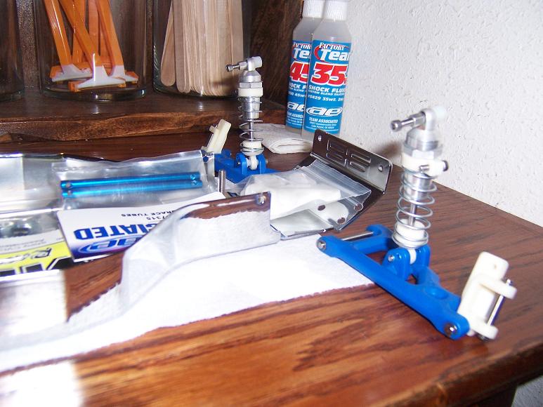

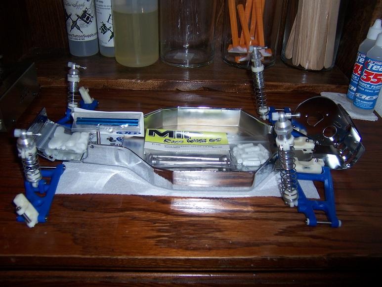

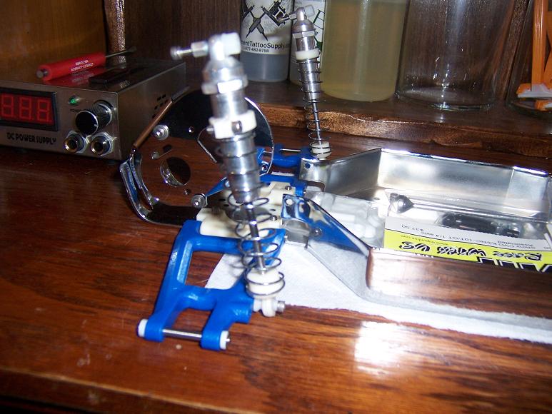

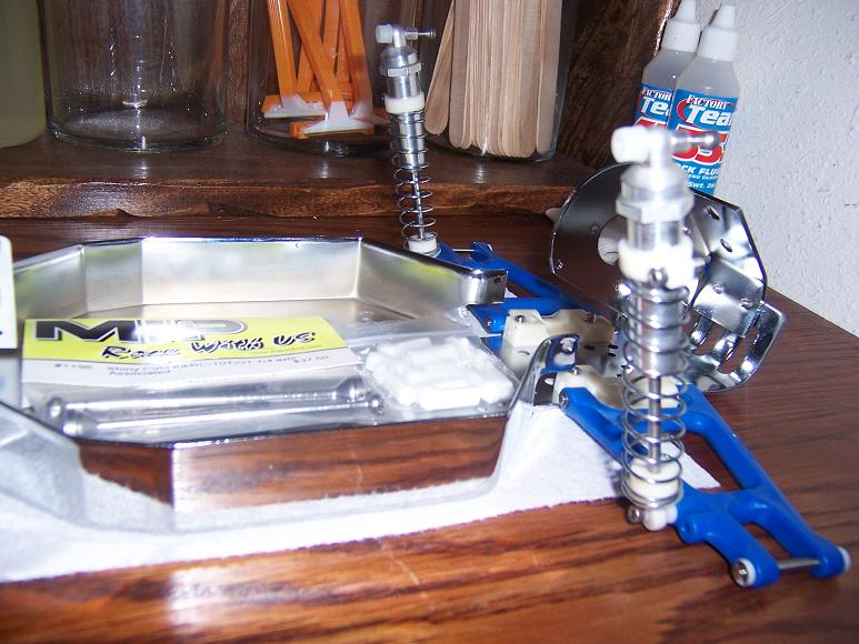

this started in buggy section but decided to make it a truck, still waiting on the nose plate and some other parts
heres what i got so far

Re: Chrome Pan 10T project
its plated, the inside of the tub is polished but everything else is platednvxwax wrote:Is that pan chrome plated or polished?
Interesting concept. I've never seen an ae chassis chromed before. I personally prefer the look of polished aluminum, but this def. original.
I figure this build isn't for running, but I'd be real careful when installing all the screws into the chassis, as the plating might get real thin inside the countersunk areas and whatnot, and be tempted to peel/bubble.
I think the front shocks might need to go, though, as they appear to be older buggy fronts.
Please keep us posted with the progress!
That is pretty cool. Did you have the shock bodies chromed also, or are they painted?
will do...ive been pretty busy and havent had time to work on it but soon i will...and ya the shocks are buggy shocks so i will have to pick up some polished truck ones.Group B wrote:Interesting concept. I've never seen an ae chassis chromed before. I personally prefer the look of polished aluminum, but this def. original.
with age comes a cage
i used oven cleaner, a drill with a 4-40 rod and nuts, and some mothers n polished em up...Snorman70 wrote:That is pretty cool. Did you have the shock bodies chromed also, or are they painted?
