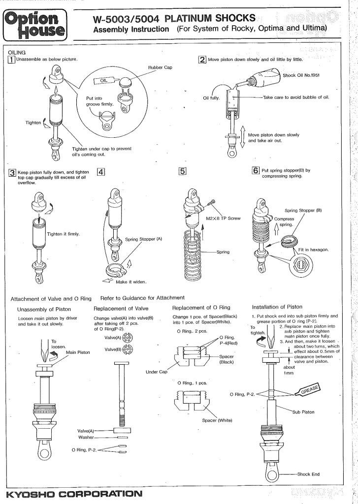

One thing to pay attention to when you unscrew the cap is to look at the diaphrams (a.k.a. "rubber caps" in the image linked above). With the set I'm currently rebuilding, one of the diaphrams was installed incorrectly and was pinched, which resulted in most of the oil leaking out of that shock. It had unfortunately remained in its pinched shape after removal due to being that way for who knows how many years and probably drying out, to boot.
