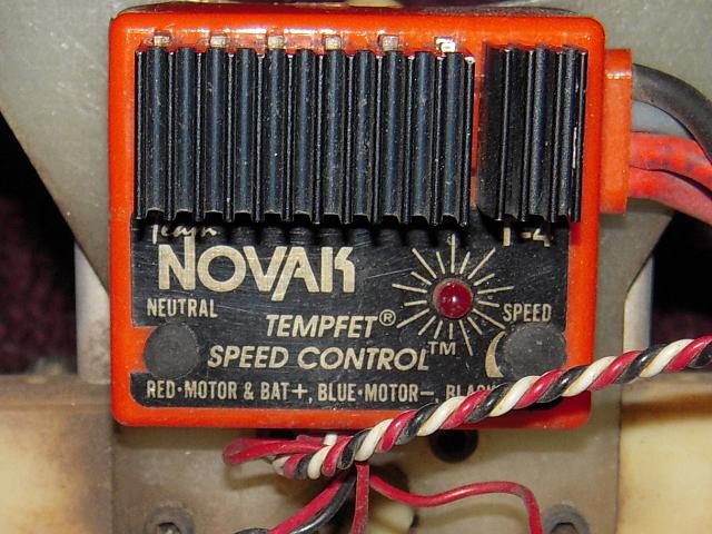

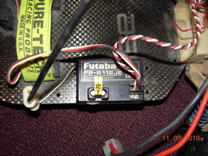

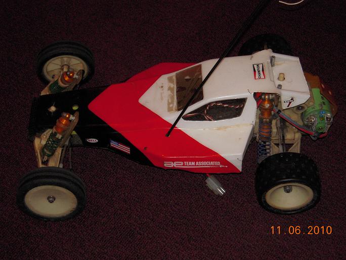

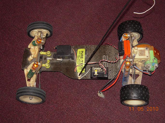

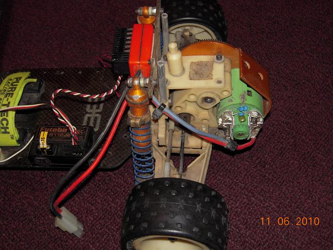

I Have Had A RC10 Graphite Since 1990 Or 1991.Everything works In It Runs Great. Just Checking To See If I Can Upgrade The Motor To A bushless And Witch One Would Fit. And I Like To Up Grade The Electronics In It What Would Be Good Upgrades That Will Fit In It. Even If I Can Not Upgrade To Brushless I still Like To Upgrade The Electronics And The Motor I Have A Green Machine 2 In It. Could I Put A Orion Billit v2 Element 19t Spec Mod Brushed Motor or a Orion 22022 Orbital 2r pro bb 11t Tpl Motor

Welcome. All the 1/10 brushless motors will fit. You have the six gear transmission which will not hold up very long with a hot brushless. I think if you use a 4600kv motor or lower you should be OK. Most new brushless ESC's have a start limit or initial torque limiting feature. Reducing the initial torque will greatly help the longevity of your transmission. These cars don't handle worth a crap with the front wheels in the air anyway. :)

I personally think you have a great looking graphite car there and would take the money you were going to spend on a brushless system and get a cheap runner off ebay. Clean this one up and enjoy it with a nice 27t for leisurely memorable drives in the park. IMHO :D

I don't know why people insist on saying the old rigs can't handle brushless power. Back in the day we ran hot motors with the 6-gear trannies, so unless you go nuts and try and drop one of the super high-powered BL motors into it you won't have any more problems running a 10.5T BL motor than you would installing a 19T brushed motor in it. There ARE plenty of lower-powered BL options available, that will offer all the low-maintenance advantages of BL systems while still allowing you to upgrade the electronics to something more current.

I raced mine back in the day with hot motors, and needed to replace the idler gears often.
Sure it will run for a while, but if you really want to run a brushless motor I suggest installing a stealth transmission. You can find them used for around $30.00 on the bay.

I was talking more about conserving the overall condition of this particular RC10. Not that it wouldn't handle the power, but more in relation to the severity of and likelihood of crashes. If you want to go with really big power maybe put it in a model in lesser condition. I think that one would clean up great and one extreme speed crash could change that immensely. And yes a 2200kv or 17.5 brushless would be great for cruises in the park. Everyone gets the urge for some insane speed at some point. It's best to do it and get it out of your system, but I'd hate to see someone trash a good looking piece in the process. Get a cheap beater and rag the hell out of it... :twisted: :wink:

Any brand you can find is fine really. The market is considerably depleted due to the ease and reliability of brushless. The Orion that you mentioned above would be fine also. Sorry, your thread sort of went astray. To answer your question, yes, pretty much any brushless system would fit fine. What will you be doing with the car and what type of area will you be running in? That may help for more specific answers. :D
