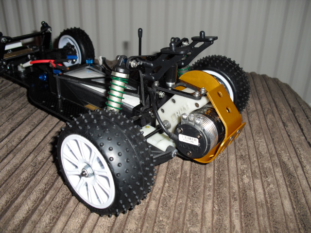

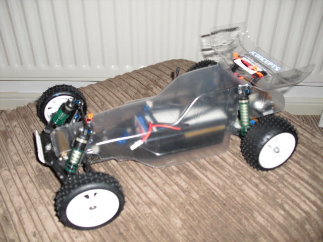

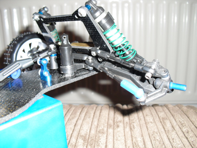

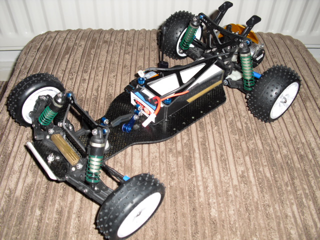

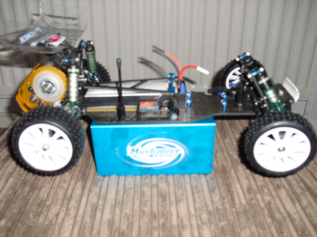

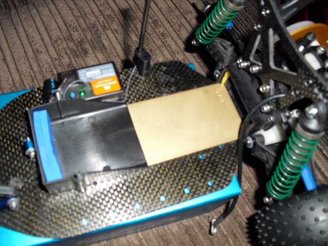

This is my rc10 graphite . Ive went for the b4 rear hubs and b44 cvd's ive used these because i had them in the bits and bobs box. the shocks are the older b4 ones i had them kicking about to but the front one's are to long the chassis does not bottom out at full compression. The brass under the lipo for the extra weight 85g and 30g up front i used this on another rc10 and worked well .The tranny is a rpm its a shame you cannot use the b4 shaft and slipper ive got a stealth for another project what i am tempted to put in this with the b4 lay shaft. Up front i used the b4 30 deg hubs and axles. The protech body just needs a trim with the dremel and a paint job. Does any one no if you can get a under for this body.
