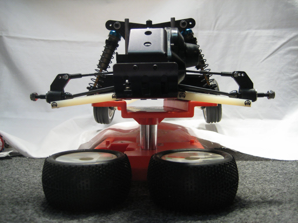

I mounted B4 shocks (straight off the B4) on the rear of my buggy. I didnt use longer shafts or anything...
here is a shot with weight on it, I will try to get another shot showing "droop"

Thanks for the photo. That looks like a lowered rear tower (wing tubes are high), is it the stock dimention? Also like the ce rear hubs, I considered that too to gain vertical ball stud adjustment. What is the spacer on the axle?

The losi CR rear hubs were machined deep so the axle protrudes to widen the stance (for B4 rear wheels). It also uses B4 bones, not stock.
The rear tower is from Atlas/eBay, it is a replica of the Worlds edition, it is standard height. I may not have the wing tubes pushed in all the way, or it could be the angle.
on my next build, to use 2.2's I will leave the rear alone and use the Thunder Tiger Phoenix rear wheels. this car may be swapped over to that also, but I really like the JConcepts Rulux wheels, so it may stay this way too...to many decisions, LOL.

Here's another example of one using B4 shocks, but this one uses the Dynotech arms and modified B4 hubs.
