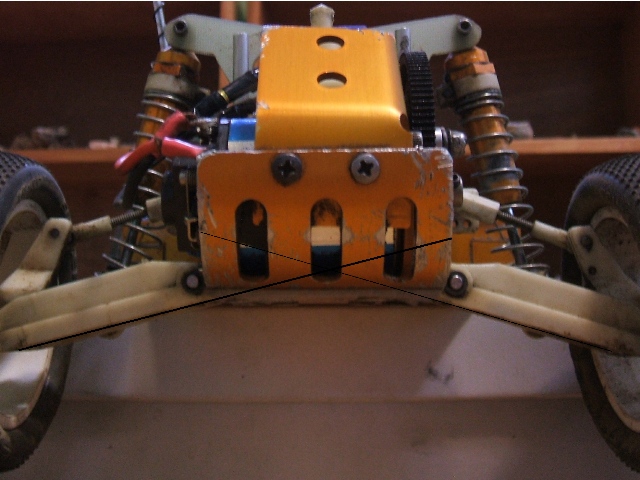

Edit: here's a picture. Note that the right-side arm goes down farther. I added lines to help illustrate this. This is under no load. When the car is on the ground, they are almost even.

That's a lot of droop. Did you check to make sure the suspension isn't at fault? The stops on the arms wear and will let one arm fall more than the other. If the shocks are identical until bolted on the car, might be something to look at. Also, try swapping shocks and see if the concern changes sides.

exactly. check the arms on the bottom near the chassis and the 'stops' molded in.

to me, it looks like your arms are bottomed out on the chassis, and it just happens to be worse on one side than the other.

Yup, put the rear shocks in teh most external holes on the arms and decrease the amount of camber too so that your wheels are either perpendicular to the ground when the buggy is on the ground or slightly leaning inwards. You might also check if both shocks have the same internal spacers.
