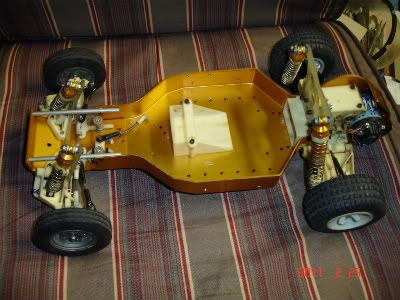

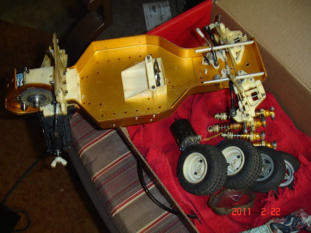

When I was a kid, my aunt's boyfriend had one of these that I was not allowed to even look at sideways. I wanted one sooooo bad. Fast forward 25 years or so, and I had one brought to me as part of a box full of old R/C stuff that my next door neighbor wanted to sell to me. Amongst the remains of a few Blackfoots, a Monster Beetle, a Frog and a Marui, there it was, covered in grease and 20+ years of dustbunnies: a gold pan AE RC10. $200 got me the tamiyas, a mountain of parts, some old transmitters, one working receiver, an old Novak ESC, a half-dozen old NiCd packs, some timer chargers, a grocery bag of wheels and tires, a bunch of MSCs, and MY CHILDHOOD DREAM CAR. :P I'm still waiting on him to deliver the majority of the stuff, but he did bring the RC10 over for me to clean up. I'm not pushing him hard to get the other stuff here, the guy is only 37 years old and fighting off bladder cancer :( I have plans to get the Tam's up and running too, so him and I can run these things together out in the yard. He was a hardcore 1:1 offroader before he fell ill, and I'd love to have this stuff up and going for spring for us.
Anyway, thats the story, now a couple pictures :D

I love the fact that you are restoring it instead of replacing all of the parts with new ones.
Using the old parts shows respect to the history of the car. The mismatched rear arms are a part of its charm.
Great clean up job so far. What are you going to do for a body?

Well, I know now how a 6 gear goes together now. :lol: It felt a little rough, so I took it apart and cleaned it up. My heart sank when I saw the condition of the pressed-on gear on the diff tube. Whoever built this car originally mustve used a 2lb club hammer to put it on. It spins, but it's still rough. :( I should have snapped a pic or two of it, but I got quite into the rebuild and the thought never crossed my mind.
Im quite happy to hear that the spur is an easy fix. Jay Dub, Im sending off a PM as soon as I get done typing this post.
