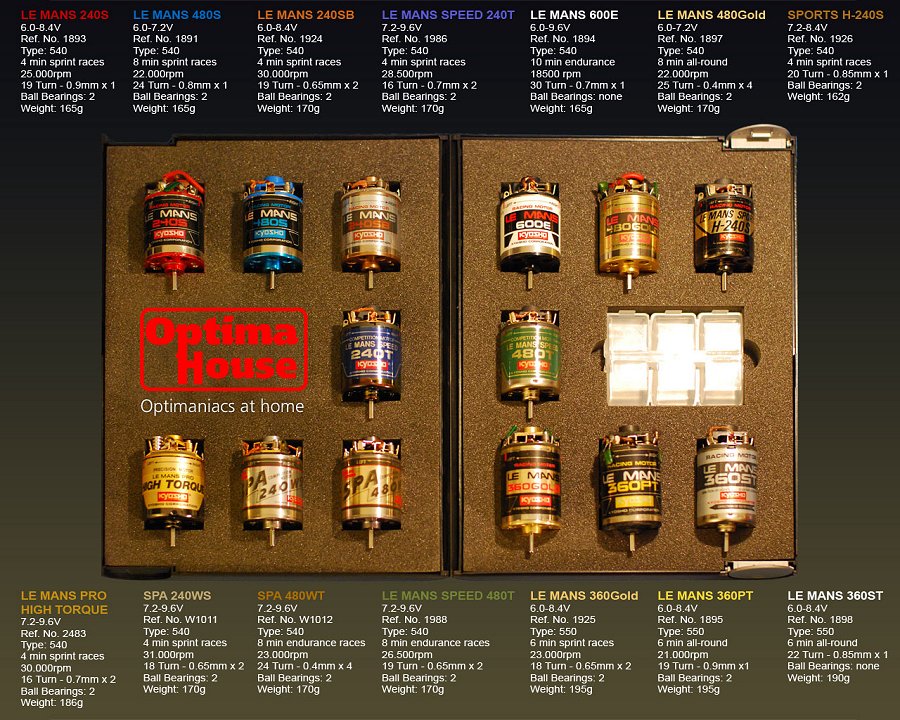

This LeMans 360ST comes stock with the boat. Anyone know the RPM on this motor?

The 360ST is a powerful little motor, but non-adjustable. I found this image on the 'net somewhere and saved it for future reference. It comes in handy!SMOKE-DOG wrote:This LeMans 360ST comes stock with the boat. Anyone know the RPM on this motor?
I would guess the RPM would be in the neighborhood of 18 - 20k.

The 360ST is closed end 550-based "stocker" - doesn't rev that fast, but has 550-sized torqued.
Which means it's perfect for a submerged prop system like the viper's... Don't go any higher HP than this without seriously thinking about water cooler the whole system though. I've done quite some hp-ramping experiments with my Kyosho WaveChopper the past couple of years, and although there were the odd chuckling moments (overpowered boats ARE fun) I've melted a couple of mills and a couple of speedos.

I thought about brushless but I don't plan on spending too much on this one. Might just keep the 360ST in there but was wondering if a Trinity '87 Monster Horsepower would work better. Not sure which has higher RPM but it sounds like the 360ST has more torque. It looks like I can water-cool the motor and ESC for only a couple bucks looking at what Tower has to offer. This is my first boat so I don't know too much about upgrades. Should I change the prop at all? Would a slightly bigger prop make for higher speed?

boats draw insane amounts of current... way more than cars! Submerged props like on the viper are super-inefficient, so anything bigger than the 360ST will require water cooling I'd say, the challenge is the water pickup in most cases and the waterproof-ness of the whole thing. When I was using brushed, watercooled motors in my wavechopper, if there was the tinyest drop of water in the hull (and there always was) the mill would suck it in and then bye bye brushes in 30secondsSMOKE-DOG wrote:I thought about brushless but I don't plan on spending too much on this one. Might just keep the 360ST in there but was wondering if a Trinity '87 Monster Horsepower would work better. Not sure which has higher RPM but it sounds like the 360ST has more torque. It looks like I can water-cool the motor and ESC for only a couple bucks looking at what Tower has to offer. This is my first boat so I don't know too much about upgrades. Should I change the prop at all? Would a slightly bigger prop make for higher speed?
Trinity Monster HP stock vs. 360ST won't make a huge diff
if you go up in prop, yes it'll goo quicker but you gotta make sure the mill has the torque...

The best motor you could use for this would be Graupner 600bb SP 7.2 with ball bearings. The shaft drive on this boat wont handle a brushless set up. You could also use a cordite motor aswell both are good marine brushed motors. A larger prop will give you more punch off the line but less speed on the top end also will cause your motor to heat up more but you will need to resise your prop once you change your motor out.
