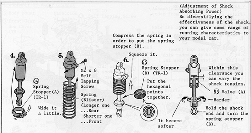

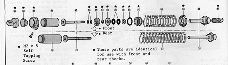

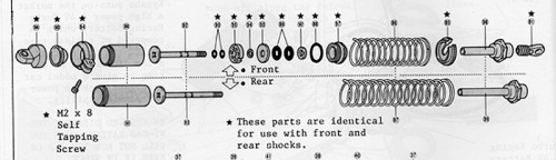

Platinum shocks are rather complicated and employ an internal dampening adjustment; so there are lots of places for things to gum up over 20+ years
. See the attached pics for a (somewhat fuzzy) exploded view and shock adjustment instructions. I would recommend completely disassembling, cleaning and replacing the two larger shaft seal o-rings (if possible). Take great care with the two tiny o-rings that seal the inner to outer shaft; they are almost impossible to replace.
40wt oil should not be too thick, but the internal adjustment may be set too high which could effectively make the dampening quite hard.
