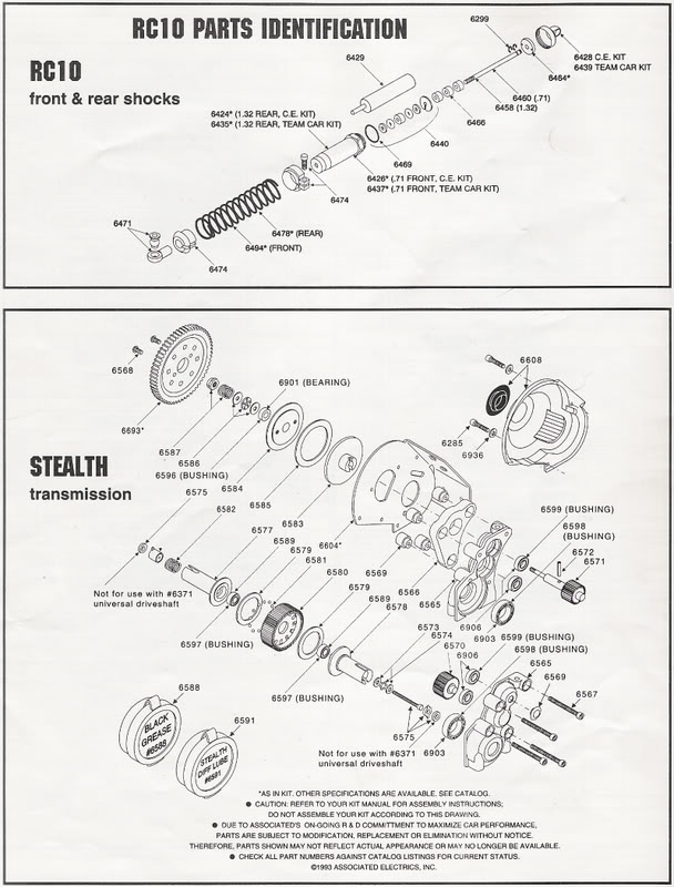

Well I caved and tore the tranny apart. The diff isn't what I expected - it was a ball bearing setup, not the small diff balls I expected. Anyways I tightened the diff all the way and slipper. It was good for a minute or so then started slipping again. I checked the screws for the pinion, motor, slipper nut and screw for the diff. But everything was tight. So what's the problem?

Re: Slipping Stealth - need a little help!
sounds to me like the diff is installed the wrong way. The adjustment screw needs to be on the correct side of the trans in order to prevent the screw from backing out. check the manual for the assembly. Bolt head looks like it goes on the spur gear side.
Thx. Well fig 28 doesn't look like my diff gear. And the diff screw with the washers and balls - just aren't there!
interesting....so do you think it's shot and melted or do you have something else installed in there?
a picture of what you are looking at will speak volumes.
Here is a pic of what the diff looks like. I did find the diff balls sandwiched in the washer (and promptly lost 1, so now I need new ones anyways). But as you can see, the main gear is completely different.
what's wrong with the diff gear? looks like stealth gear to me.
the tiny 5/64 balls that you lost are thrust balls, not diff balls. take the diff rings out of the diff gear and you'll see the diff balls.
It doesn't look like the one in the instructions posted above like this:
Pull the diff rings out of the diff gear, clean them, and put 2 dabs of CA glue on the backs to glue them to the diff outdrives.
Re-assemble.
Buy a new 5-40 nut for the outside of the slipper.
Mine has a solid bearing and the one in the link has individual diff balls. Unless I'm missing something.scr8p wrote:explain to me what is different.
like i said above, take the diff rings out of the diff gear. the individual diff balls are under them.
all those 2 5/32 x 5/16 bearings really do is keep the diff components in line.
