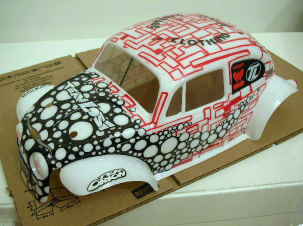

Doug, wow, that's impressive. I think you put more time and effort in to preparing to paint the body than I put in painting, trimming and mounting the body. It shows too, you're bodies are awesome. I am a painter (the oil on canvas kind) but for whatever reason, I've never had the patience to try to do a really awesome lexan paint job. Here's a pic of the body I think I got the most ambitious with.
bug paint.jpg (155.22 KiB) Viewed 2873 times
