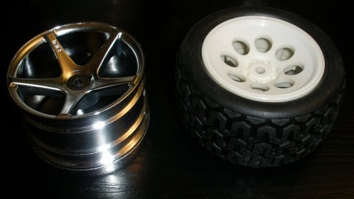

HPI 5-stars work great, you just need to buy 2.2" tires to match. You want the 32mm thick ones, which come in various finishes; black, white, chrome.
If you search eBay for 2.2" wheels with 12mm hex drives, you'll find lots and lots of choices.

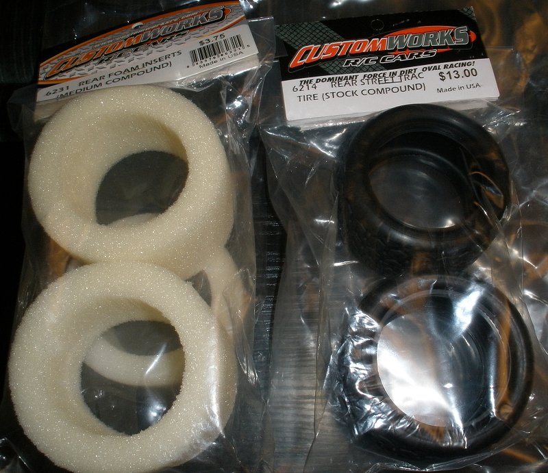

They'd probably fit diameter-wise, but they might be too wide. It seems you're looking for some road tires. I found some tires & foams that work perfectly for the Turbo Optima wheels, and also will very snugly fit HPI 5-Stars. CustomWorks #6214 tires, #6231 foams. They have a 2.0" I.D. and mounted, have a 77mm diameter, 38mm width...pretty close to stock size.madmaxx wrote:hey guys... would these tires fit the stock turbo optima wheel???

Those look great Colecanth! I like when they fit the stock wheels.
