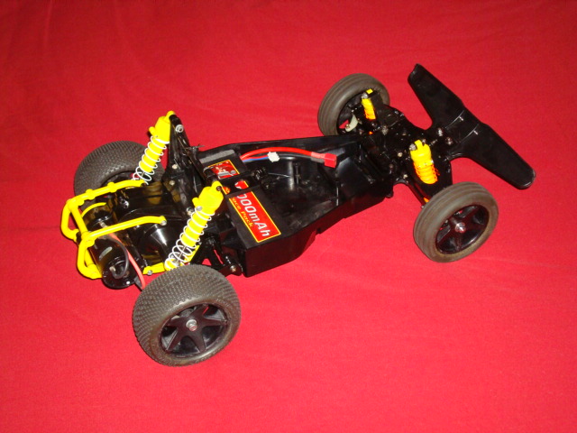

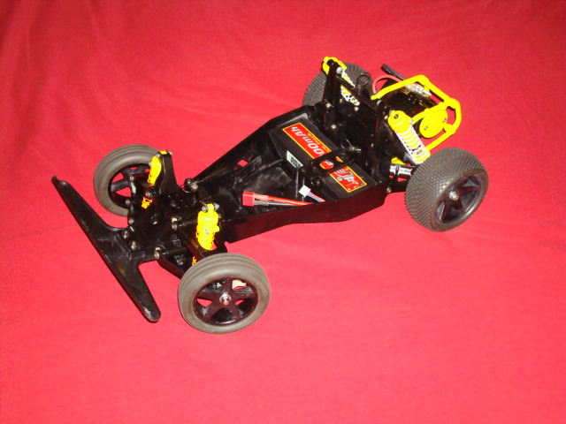

This buggy I plan on running in the Classic class. Pretty much a bone stock Falcon with the exception of Losi springs and HPI superstar wheels and J concepts tires. Same combo I ran on the Frog.
More pics as I get her finished up as well.

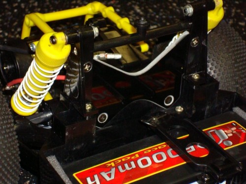

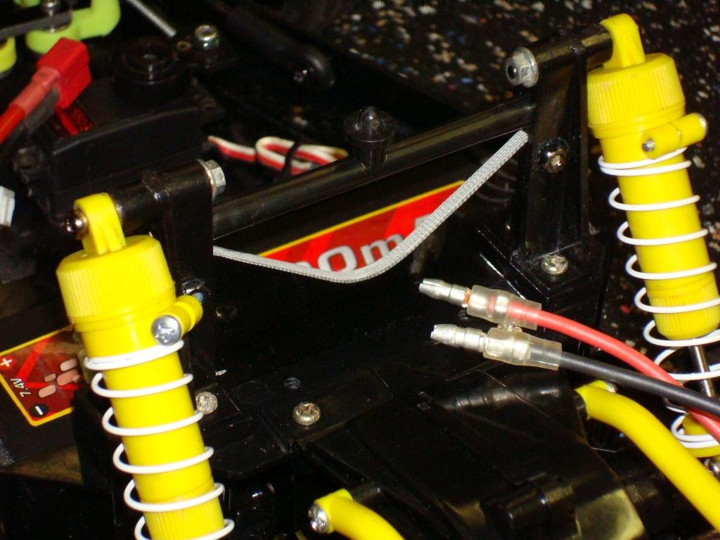

One was the rear shock towers. They will snap if hit from the side. To strenghthen this I used 1/8" FRP and cut it to fit in the slot that was already conveniently moulded into the towers. It goes down and screws into the chassis, which was also perfectly lined up with the slot. Nice and strong now.

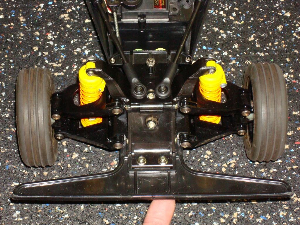

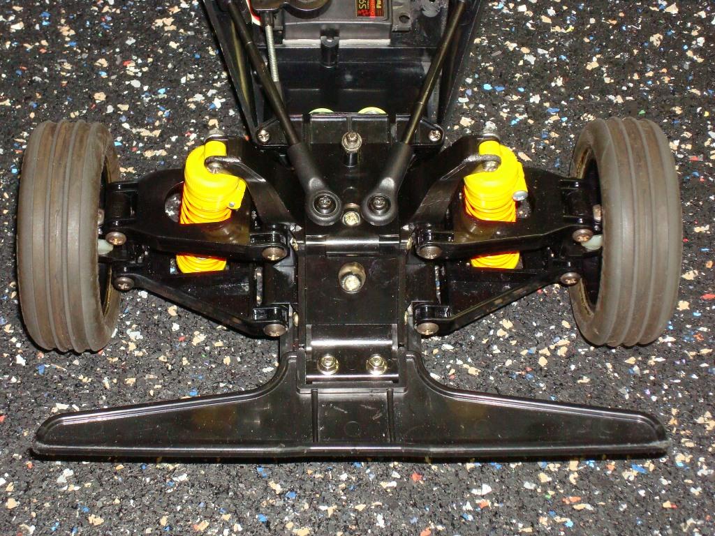

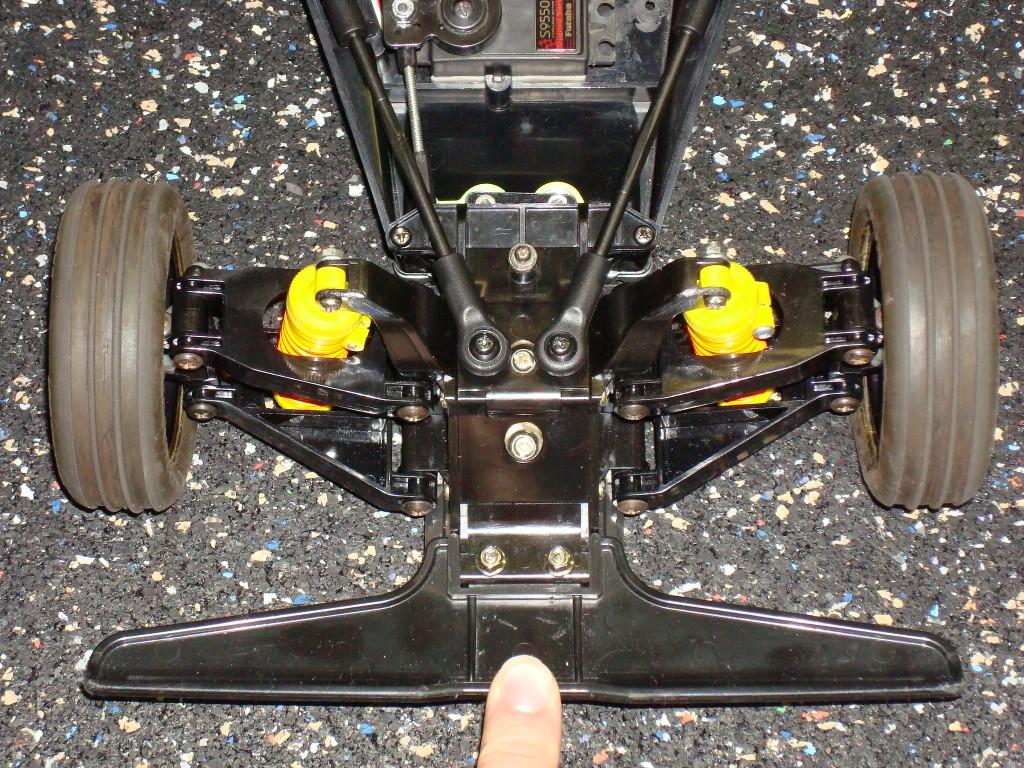

Two was the front chassis. They are notorious for snapping off where the front end screws to the chassis. I had a CRP metal brace but didn't really care for it too much. So I had 2 Losi XXL camber links set aside for another project but used them to beef up the front. A little overkill, but they work!

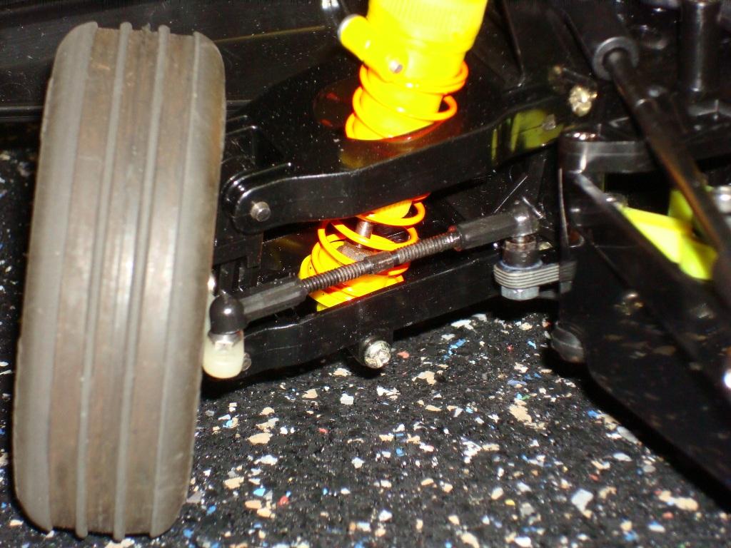

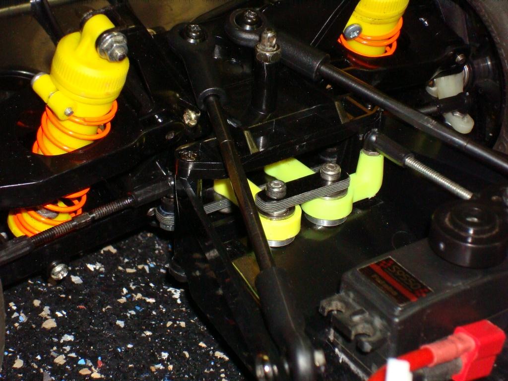

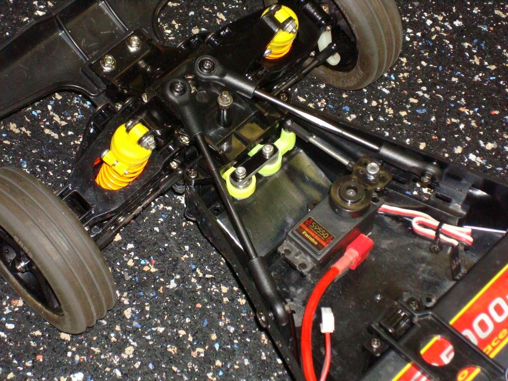

Three was the steering. Can you say bump steer? I don't think Tamiya spent much time engineering the steering systems on much of their early cars. 1 pivot on the servo saver offset in the chassis, one link longer than the other. Anyway, I used some A&L steering bellcranks and mounted them pretty close together on the chassis. Had to do this to keep them from hitting the sides of the chassis. Made the rack out of the same 1/8 FRP. Now the turnbuckle links are equal and are the same length as the distance between the inner and outer suspension arm pivot holes. I had to space up the ball studs 1/8" on the rack to get the angle between the links and the arms the same. Zero bump steer.

Awesome, I like the steering job!!! Bump steer on early tamiya cars is appalling indeed to say the least... you nicely fixed it, in style with yellow plastics
