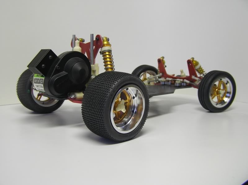

I would think you could use a graphite chassis from Dave (DW911) if he has any left, Example below

bearrickster
Posts: 4372
Location: Hollywood Maryland
Re: Sassy Chassis with Track Master Transmission?
Post by bearrickster »
thats a very nice car
