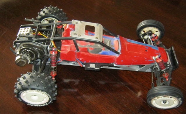

Has anyone found a viable solution to the cracked shock collars on the early Ultima red shocks?
I've restored and own a Turbo Ultima,a Triumph,a Turbo Mid SE & a Turbo Mid SP,but they all have gold & platinum shocks...A rather sad little 1st gen Ultima followed me home,a few weeks ago and,just as I suspected,all 4 shock collars are cracked right through. :?
I have a set of Kyosho gold shocks I could fit,but I'm a stickler for correctness,especially with my Kyoshos.
I saw some red Bolink shocks on eBay,I think they are old rear pan car shocks.
Anyone know if they'd fit?
Kinda be a last resort,for me,like I said,I like things to be correct.

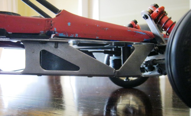

Check out the choice chassis crack! :shock:
Lucky I have a mint chassis stashed. 8)
Here's the sad little Ultima...

Wow. Hope you don't find other problems, because that, combined with the home-made top deck and the break in the body, looks like someone folded up his Ultima big time after hitting something really hard. L-shape big time. :cry:

And like EvoRevo stated, that car is one curb-hit away from looking like a hockey stick. :P
