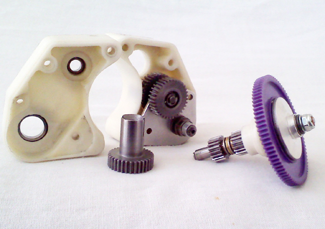

thanks 4 the replys... all the 6 gears im runnin have full bearings(outdrives too) and black idler gears .. heres my issue i was thinking of putting faster motors in my runners,but i keep getting mix reviews on this trans ..1 side i see people running vxls and other brushless systems .. on the other side some people say they are junk and will blow up quick. i see some perform like they have a loose ball diff (slipping) or all power allways on one wheel more then other(in dirt say the left tire allways getting the power making car vere to right under full throttle acceleration)... i wanted to see if anyone has done alot of races/runs on there 6gear with a fast motor with good reliability. ive only ran racing stock motors in mine. are these transmissios good runners or shelfers?

I've done it with a set of Thorp outdrives I got that were beat up.longboardnj wrote:any pics of someone doing this?if you've got a beat up set of outdrives chop those down into idlers]

I have one with chopped down outdrives (original 32 pitch) into idler gears, that is silky smooth and being saved for a 6 gear project! Not sure when I will get to build it though, maybe this coming winter?

this is the reason why i posted this... now you guys got me wanting to keep my 6 gears .. how do you do this metal gear trick?is it as easy as cut the end off ,put bearing back in then just put c clip done?

Dremel or hacksaw off as much of the outdrive cup as you can then file off the rest. The large internal retaining ring is still used to keep the bearing in the metal idler, then the e-clip is used to keep the whole thing on the shaft.
After you get your idler sorted then you can shape the case, do a bearing elimination mod, and look for a Losi, Team Pit Stop, or Jammin Jay diff tube that lets you put a bearing in the spur gear. I've got a few JJ diff tubes if you're interested.

Phin wrote:Dremel or hacksaw off as much of the outdrive cup as you can then file off the rest. The large internal retaining ring is still used to keep the bearing in the metal idler, then the e-clip is used to keep the whole thing on the shaft.
Do you use the entire JJ rebuild kit or just the diff tube w/bearing? I have everything except the lock rings.

The stock 6-gear diff rings will work on the tubes but obviously they won't lock...unless you glue them.tommy2c wrote:...
You could take a shot and try the d-rings from an RC10L4 P/N ASC8504. The old RC10L used the same size diff rings as the 6 gear and if Associated hasn't changed the size of the rings on the newer pan cars they could work. You'd only need one flat edge to lock the diff on the JJ tube.
